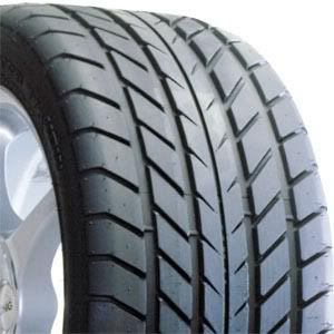

sgt1020 Posted October 18, 2010 Author Report Share Posted October 18, 2010 I don't road race my SGT, drag race yes hence the reason for the camber bolts. Having my 20's wear prematurely gets costly. If you do track yours and really need the negative camber than I'd suggest caster camber plates. Now, I see you are running BFG KDW's are those with the firelike design? I did my research before buying new tires and from the reviews for BFG were not that great, many folks experienced vibration and noise due to the design of the newer KDW's. I went with Vredestein tires and I love them so far, excellent grip in the rain and they do not make noise or have any vibration. Are your tires true? Meaning are they round and not defective? Sometimes some tires are not within specs, are your 20's road forced balanced? My tires couldn't be more balanced than they already are. I do not have the "flame design" tire. I have the KDW ultra performance summer tire that is the old design that BF-Goodrich discontinued. I have no idea why they discontinued this design. I love them! They ride great, have excellent traction in dry conditions and rainy conditions. I hate the look of the new design which look like flames. It's ugly and yes, I have heard they overall suck. I wish they wouldn't discontinue my tire. When the time comes to get new tires I am looking into Goodyears or Pirellis. This is the tire on my car now. Shelby even put this tire on the Shelby California Edition GT/SC featured in several magazines. This is BF-Goodrich's new design of my tire: (This tire is ugly) Link to comment Share on other sites More sharing options...

FordRocks1 Posted October 19, 2010 Report Share Posted October 19, 2010 My tires couldn't be more balanced than they already are. I do not have the "flame design" tire. I have the KDW ultra performance summer tire that is the old design that BF-Goodrich discontinued. I have no idea why they discontinued this design. I love them! They ride great, have excellent traction in dry conditions and rainy conditions. I hate the look of the new design which look like flames. It's ugly and yes, I have heard they overall suck. I wish they wouldn't discontinue my tire. When the time comes to get new tires I am looking into Goodyears or Pirellis. This is the tire on my car now. Shelby even put this tire on the Shelby California Edition GT/SC featured in several magazines. This is BF-Goodrich's new design of my tire: (This tire is ugly) I see, well, I suggest you install the camber bolts, they are cheap from Summit Racing and get the car aligned within or close to factory specs- what my tech told me was that think about it, if you have the camber set at negative and most of the weight of the front is sitting on mostly the edge (inner) you will feel vibration especially with low profile tires (in which most cases are hard compound). So to remedy this is to set the alignment within specs to evenly distribute the weight on the tires, it kind of made sense so I just did as he said and the vibration has gone away plus Carl (motorjock and many) have installed the bolts which further convinced me to just install them, caster camber plates are also good but brings noise in most cases I hear from the track guys. Link to comment Share on other sites More sharing options...
