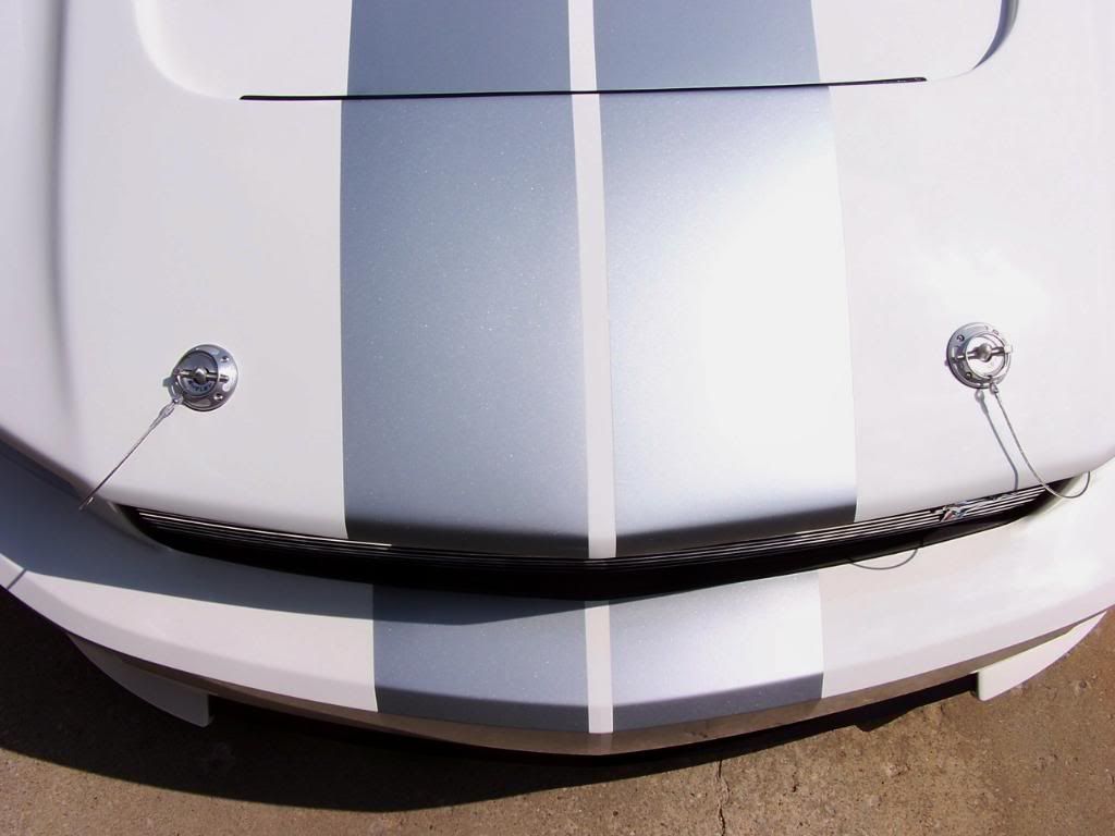

IASHELBYGT Posted May 27, 2014 Report Share Posted May 27, 2014 route them under the radiator cover. It shortens them enough to make them not rub the hood. However I have the upgraded hood pins with the flying saucer base. Here is a pic of mine. Link to comment Share on other sites More sharing options...

EL SHELBY Posted June 2, 2014 Author Report Share Posted June 2, 2014 For example.... Link to comment Share on other sites More sharing options...
