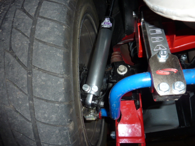

OCD Posted January 21, 2015 Report Share Posted January 21, 2015 Get adjustable shocks... Viking makes a nice double adjustable set for our cars... Price was great too... I got them from BMR... Link to comment Share on other sites More sharing options...
OCD Posted January 21, 2015 Report Share Posted January 21, 2015 I wish they made front shocks, I guess rear only won't help you... I run single adustable D specs up front... Link to comment Share on other sites More sharing options...
