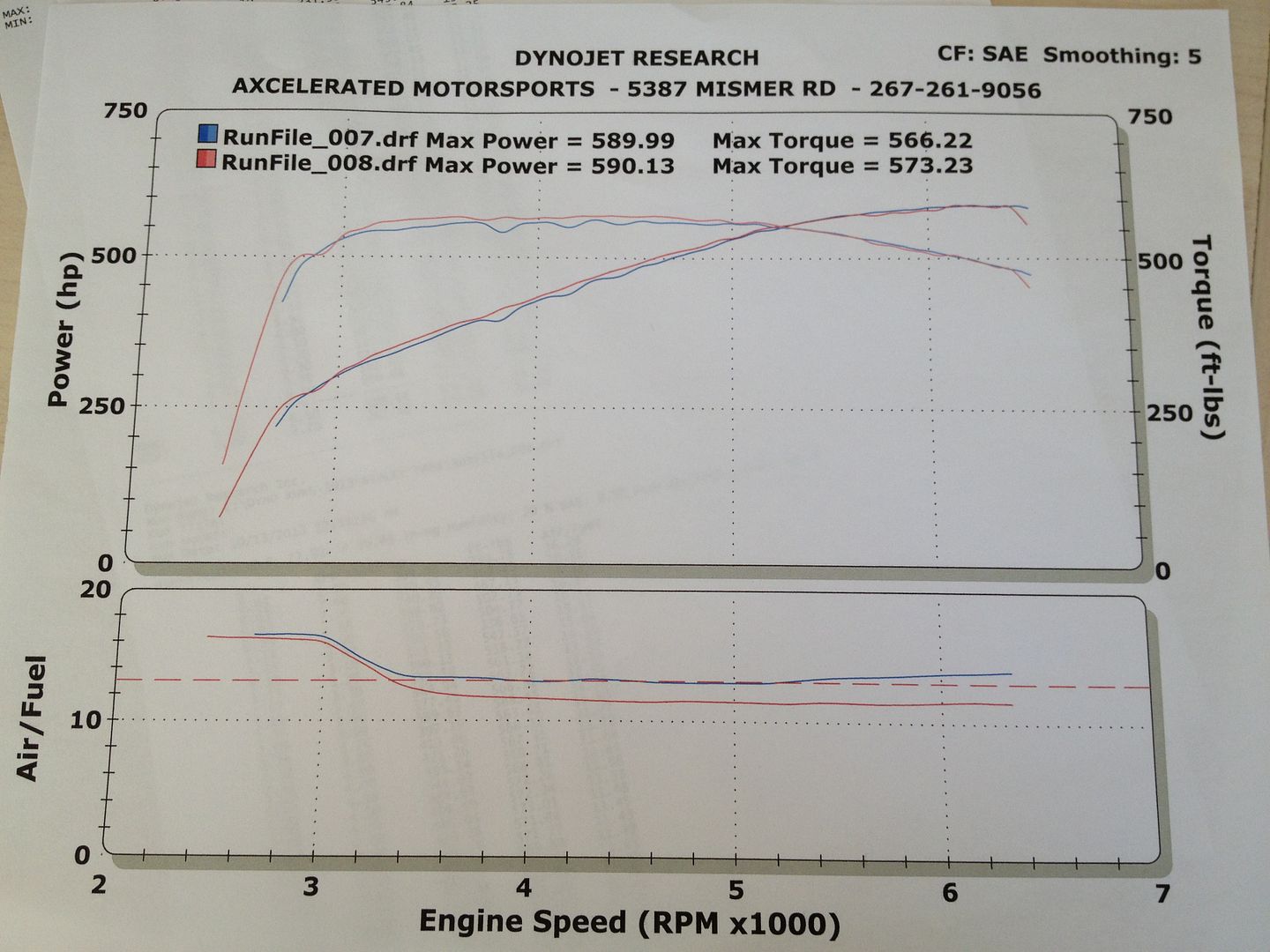

yell03 Posted November 26, 2013 Author Report Share Posted November 26, 2013 (edited) My bad....I see I revived an old post- you already purchased a TVS. Let us know how the install goes and how you're enjoying it! My neighbor installed the TVS and new Motorcraft 12 plugs (1 step colder than stock 22s, no other changes, took about 2&1/2 hours. Stock 13 pulley, stock 2011 TB and intake. I have a Canned Lund Tune through Revan racing Car made 590rwhp SAE, that same day a stock 2013 GT500 made 568rwhp SAE right after me. Car runs much better than stock. It is VERY fast. In warm & sunny 70 degree weather it will hook in 2nd gear from a roll, forget 1st. In cooler weather 2nd gear will spin at any speed. Ignore a/f on run 1, the sniffer got pinched. Edited November 26, 2013 by yell03 Quote Link to comment Share on other sites More sharing options...
