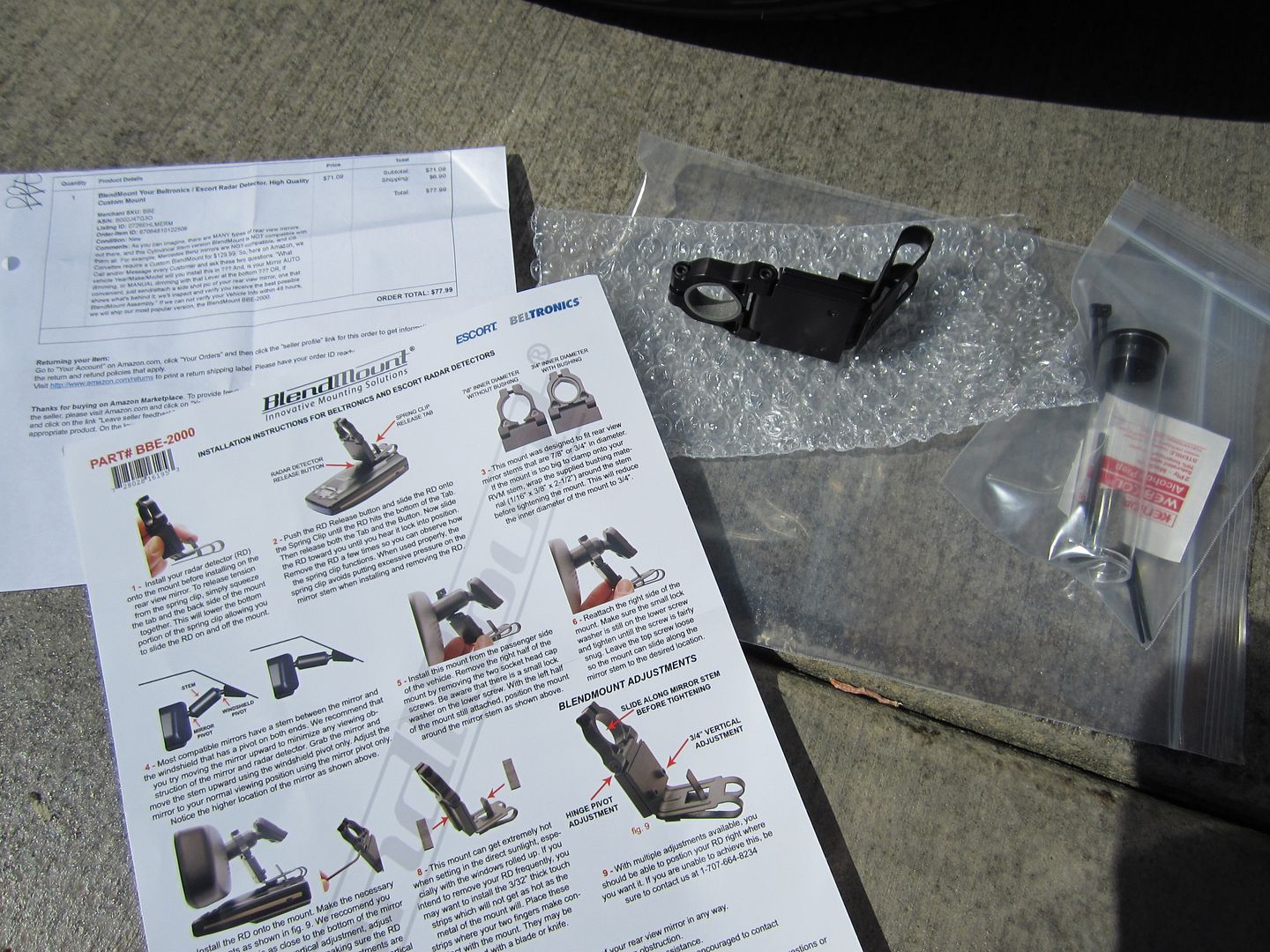

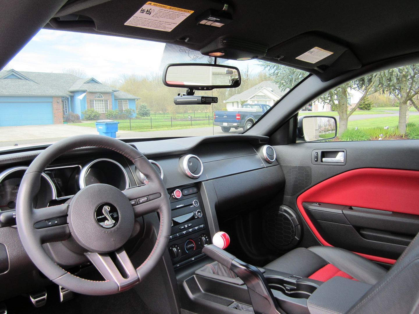

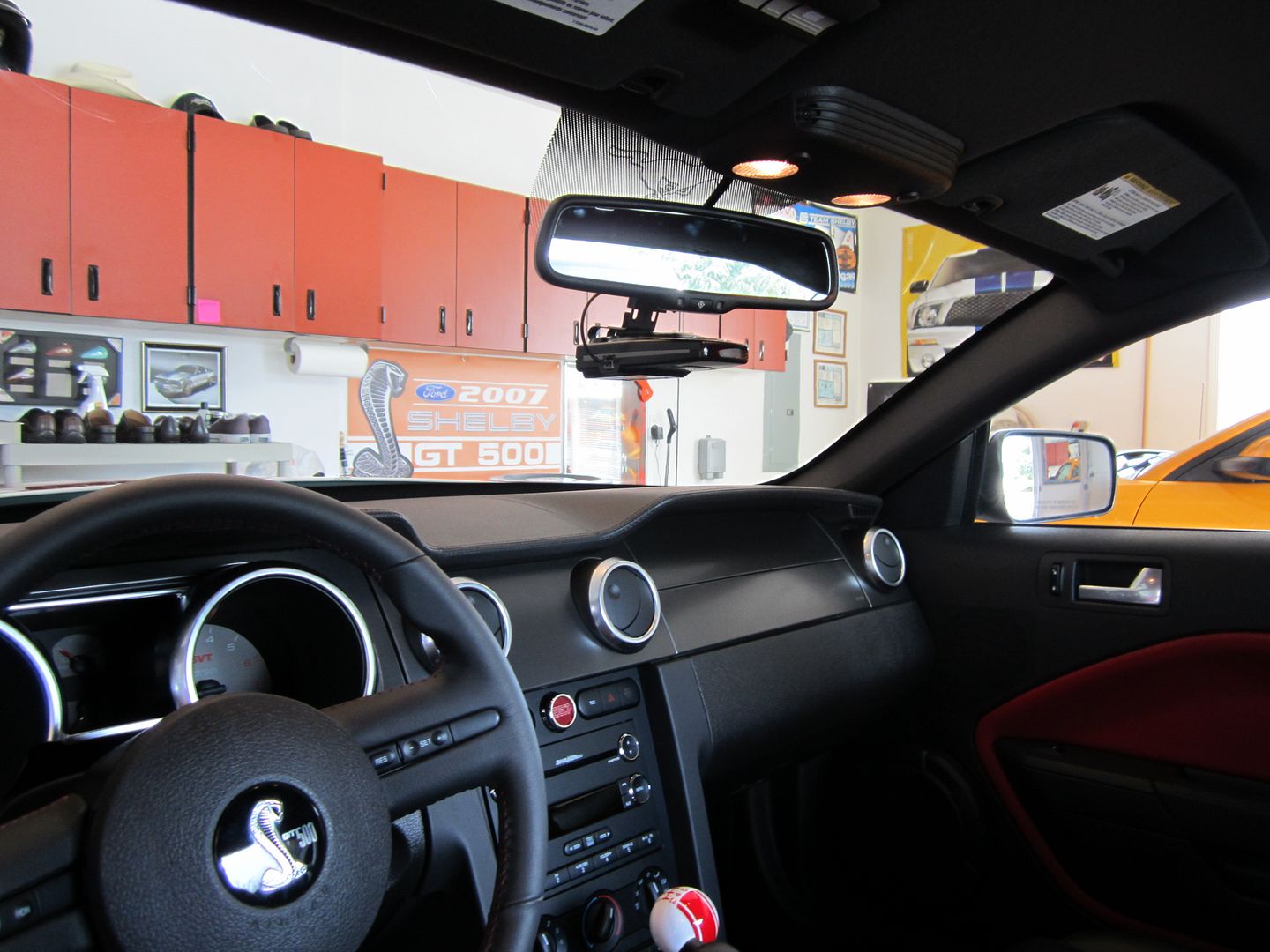

Grabber Posted April 14, 2012 Report Share Posted April 14, 2012 My Escort / Passport radar detector used to hang from my windshield with 2 suction cups. Sometimes they would come loose and the detector would be laying on my dash. this is what it used to look like: Then I bought a "super suction cup" that was bigger and this is what it looked like: I just installed my Blendmount unit to my mirror and I must say it looks way better now and my vision is not blocked and the installation has a factory look to it. This mount has many adjustments on it so you can get it just perfectly situated in your car. The unit is very quality. I bought mine from Amazon for $77 bucks plus shipping. Very happy with the unit ! Link to comment Share on other sites More sharing options...

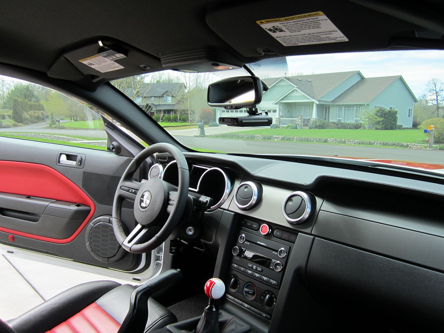

Grabber Posted April 14, 2012 Author Report Share Posted April 14, 2012 Mrs. Grabber got the same treatment as well.....of course. Link to comment Share on other sites More sharing options...
Grabber Posted April 14, 2012 Author Report Share Posted April 14, 2012 Here is the link to the manufactures website with all the details of this unit and all the models for other radar detectors too: http://store.blendmount.com/blendmount-2000-series-mount-for-beltronics--escort-radar-detector-ford-mustang-p414.aspx Link to comment Share on other sites More sharing options...
Grabber Posted April 14, 2012 Author Report Share Posted April 14, 2012 ......and a big thanks to Slabo for showing me this unit when we were in LV for the bash. He installed it in his 40th and I was very impressed with it and his new detector that he bought, so I bought Tana the same set up and had to upgrade my silly suction cups to this unit too ! B) Link to comment Share on other sites More sharing options...

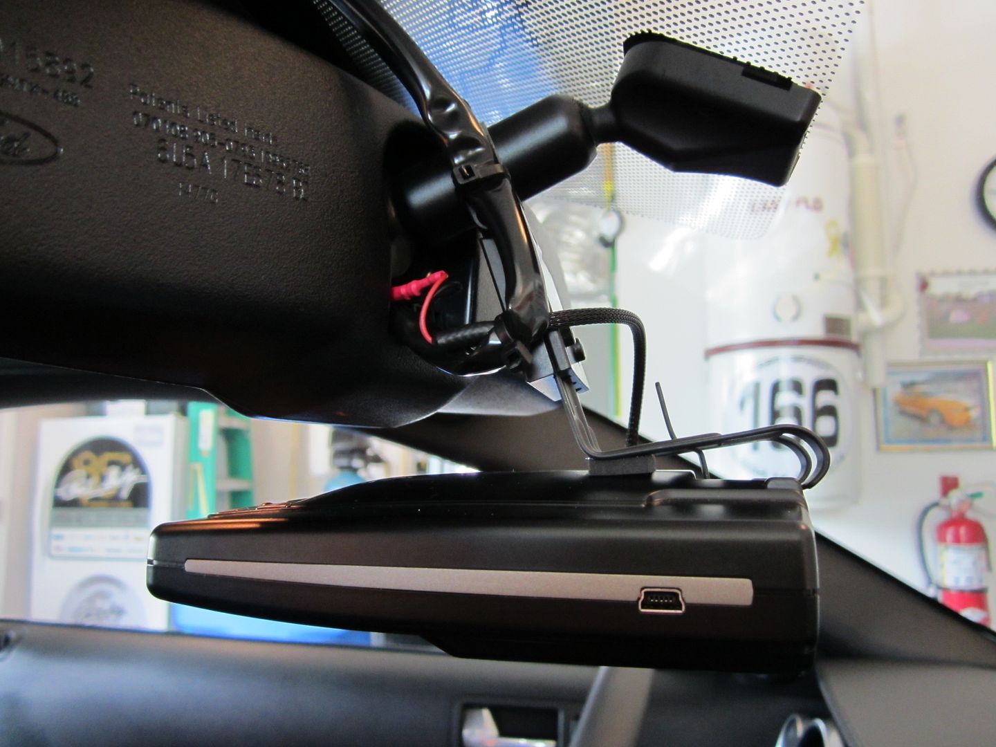

Grabber Posted April 17, 2012 Author Report Share Posted April 17, 2012 Where did you run the power cord to? I had a smart Escort smart cord installed 3 years ago by a professional installer. He hard wired it under the dash by the dead pedal. He had to look up exactly which wires to tap into. Escort has a manual that tells what wires to use. I rerouted the chort to the headliner via the piller. Here is a link to buy the smart cord. http://www.amazon.com/Escort-79-000041-01-Direct-Wire-SmartCord/dp/B0003NN83K/ref=sr_1_1?ie=UTF8&qid=1334701586&sr=8-1 Link to comment Share on other sites More sharing options...

b17drvr Posted April 18, 2012 Report Share Posted April 18, 2012 I had a smart Escort smart cord installed 3 years ago by a professional installer. He hard wired it under the dash by the dead pedal. He had to look up exactly which wires to tap into. Escort has a manual that tells what wires to use. I rerouted the chort to the headliner via the piller. Here is a link to buy the smart cord. http://www.amazon.co...34701586&sr=8-1 Thanks! Link to comment Share on other sites More sharing options...

Slabo Posted April 18, 2012 Report Share Posted April 18, 2012 I had a smart Escort smart cord installed 3 years ago by a professional installer. He hard wired it under the dash by the dead pedal. He had to look up exactly which wires to tap into. Escort has a manual that tells what wires to use. I rerouted the chort to the headliner via the piller. Here is a link to buy the smart cord. http://www.amazon.co...34701586&sr=8-1 Blendmount also sells a mirror tap cord so you can just take power from the mirror. http://www.blendmount.com/mirrortap.html Link to comment Share on other sites More sharing options...
Grabber Posted April 18, 2012 Author Report Share Posted April 18, 2012 Blendmount also sells a mirror tap cord so you can just take power from the mirror. http://www.blendmoun.../mirrortap.html That is a pretty cool invention. Saves a lot of time trying to run wires and figure our what wires to tap into. I noticed that when you click on it, they have all manufactures makes and years available. Here is the one for the Mustang 1995 to 2009. They also have them for the 2010 to present. http://store.blendmount.com/mirrortap-radar-detector-power-cord-with-inline-fuse-ford-mustang-p469.aspx Link to comment Share on other sites More sharing options...

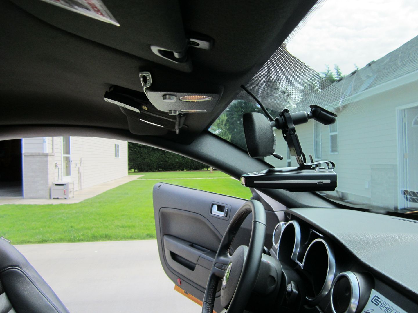

Grabber Posted May 16, 2012 Author Report Share Posted May 16, 2012 I decided to by another escort 9500ix radar detector and use the Solo S3 in my work truck. So I installed the blend mount mirror wire tap to pull power off of Tana's power mirror. What a slick set up. http://store.blendmo...stang-p469.aspx The 2009 GT500 has 3 wires into the back of the mirror. Purple, Black and White. All you do is take the blendmount wire tap red wire and push it into the purple socket and then take the Black wire and stick it into the black socket. Then you use a small zip tie to attach the wire to the existing mirror wire and you then have power for your radar detector that goes on when you turn the key on. Here are some pic's of the install. Link to comment Share on other sites More sharing options...
XY GTHO Phase III Posted May 16, 2012 Report Share Posted May 16, 2012 I decided to by another escort 9500ix radar detector and use the Solo S3 in my work truck. So I installed the blend mount mirror wire tap to pull power off of Tana's power mirror. What a slick set up. http://store.blendmo...stang-p469.aspx The 2009 GT500 has 3 wires into the back of the mirror. Purple, Black and White. All you do is take the blendmount wire tap red wire and push it into the purple socket and then take the Black wire and stick it into the black socket. Then you use a small zip tie to attach the wire to the existing mirror wire and you then have power for your radar detector that goes on when you turn the key on. Here are some pic's of the install. Wow That is a really nice set up. I might just have to get one on those myself, Thanks Grabber Link to comment Share on other sites More sharing options...
Grabber Posted May 16, 2012 Author Report Share Posted May 16, 2012 Wow That is a really nice set up. I might just have to get one on those myself, Thanks Grabber The 2 items, the mount and the wire harness are kind of spendy ($110)....but it is a slick set up and there are no other cleaner installation methods. Link to comment Share on other sites More sharing options...
