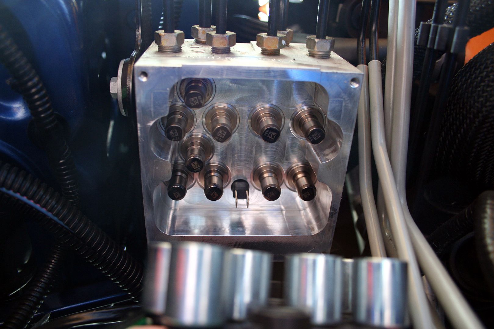

6-Speed Posted October 8, 2009 Report Share Posted October 8, 2009 Is this what you're referring to? Link to comment Share on other sites More sharing options...
