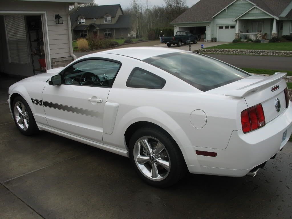

Grabber Posted April 14, 2008 Author Report Share Posted April 14, 2008 Tana drove the car the last 3 days. She loves the look of the new lower grill and the front plate removed. We have another storm moving in tonight so I washed the car so it will be ready for her next outing when the weather breaks again. I snapped a couple photos showing the new look. Link to comment Share on other sites More sharing options...

Grabber Posted May 3, 2008 Author Report Share Posted May 3, 2008 I got some good pic's in the sun today of the new lower front grill that I installed. Link to comment Share on other sites More sharing options...
