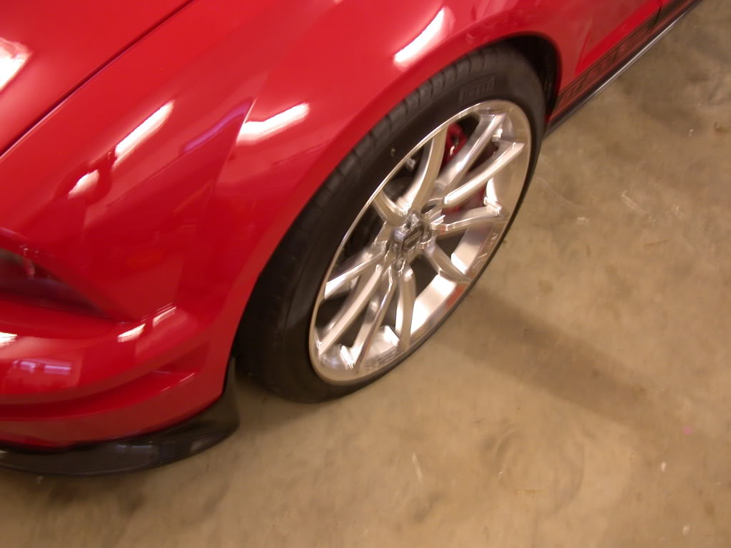

Robert M Posted July 10, 2019 Report Share Posted July 10, 2019 (edited) I found my original pictures after I had measured the 9" and 10" bare Alcoa's w/o tires and then decided to "test fit" my original rear 10" Super Snake Alcoa's on the front, with the original 275/35 Pirelli P-Zero's that Shelby had installed when my car went through Las Vegas. It looked perfect on the initial "test" install....... Turned lock to lock without contact....... .......and rolled freely with no contact against my Shelby installed Eibach Pro Street-S coil over struts....... ^^^Those pictures were from approx. early 2010. I have had 10" Alcoa's on the front of my 2008 Super Snake since that time, and what a Great upgrade to the handling when I press my car into a turn!! The increase overall diameter along with the slightly wider width provided a much more sure footed feel on the front of my heavy nosed 2008 Super Snake. R Edited July 10, 2019 by Robert M Quote Link to comment Share on other sites More sharing options...
