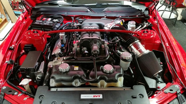

OCD Posted June 24, 2016 Report Share Posted June 24, 2016 I have power washed my engine bay dozens of times... Just avoid the battery and computer, and keep the tip far away... I mostly wash it by hand at home with just soap and water and then dry it with the air hose... In between washing's I use a rag and detail spray... 74 thousand kilometers on this engine bay that has driven in a lot of rain and crappy weather conditions!! Link to comment Share on other sites More sharing options...
