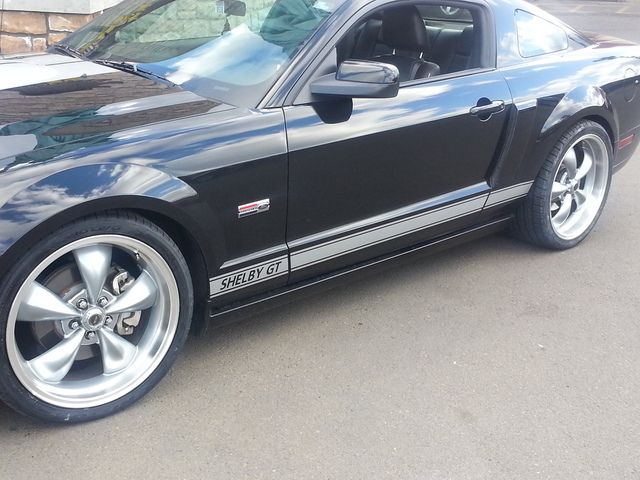

a1machinista1 Posted April 5, 2016 Author Report Share Posted April 5, 2016 OK finally made a decision.. I found out my rears are 20x10 with 6.17 backspace and +36 offset. I decided on the nitto motivo. I decided to go bigger on the rear because the 285 30 on the rear just wasn't working for me... The rears are right to the fender but the fit is perfect. Tires look great and so far no complaints. Road noise is substantially less than the Hankook v12s I had... but to be fair the Hankooks were at the wear bars. So I ended up going with 295 30 20 rear and 255 35 20 front . I will report back with my opinions on the Motivos... I went with the Motivos because of cost first but mainly because they are USA made and are said the be Ultra high performance all weather... and since this is my almost daily driver (not pouring rain) I wanted a good wet performing tire... the reviews on these were good so I gave them a chance. Quote Link to comment Share on other sites More sharing options...
a1machinista1 Posted April 5, 2016 Author Report Share Posted April 5, 2016 Quote Link to comment Share on other sites More sharing options...
Helge Ruchelski Posted April 5, 2016 Report Share Posted April 5, 2016 Great choice! Looks fantastic! Quote Link to comment Share on other sites More sharing options...
Larry T Posted April 5, 2016 Report Share Posted April 5, 2016 Looks awesome ... Great choice. Quote Link to comment Share on other sites More sharing options...
a1machinista1 Posted April 5, 2016 Author Report Share Posted April 5, 2016 One thing I have found out... that much new rubber picks up everything off the road and it sounds like im driving on gravel... very nice ride so far. Firm ride in town but feels very stable, not jarring.. grip is not as much as I was hoping for but my assumption is that it will improve after a few miles. Road noise is about half of what I had at 60mph. At 60 steering feels slightly less responsive but again I'm hoping that improves with time. Quote Link to comment Share on other sites More sharing options...
