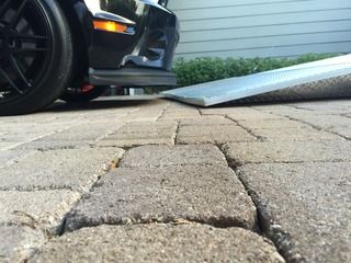

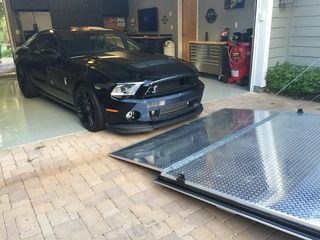

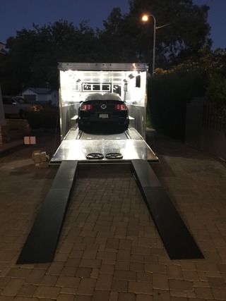

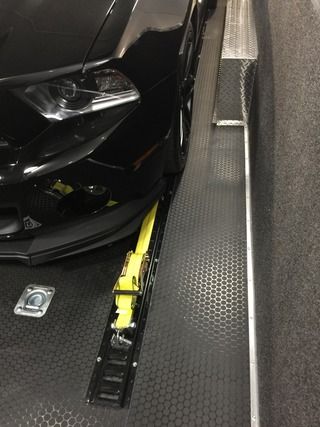

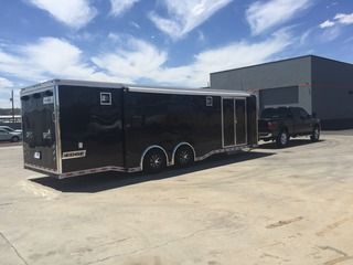

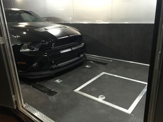

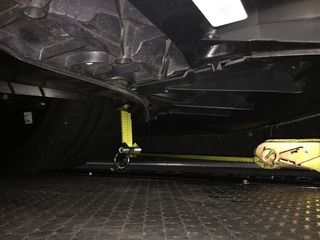

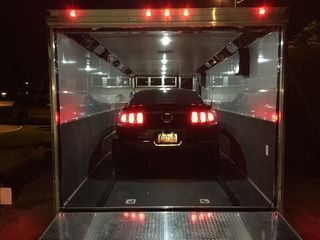

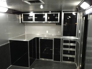

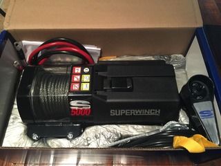

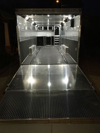

QUIKSVT Posted July 25, 2015 Report Share Posted July 25, 2015 Took the step this weekend to try out my new enclosed trailer setup. After reading several threads on here about it and taking much of that advice- I thought I'd share my experience for others to use! The trailer I ended up ordering a 2015 28' Haulmark Edge Pro from Phil's Trailer Sales in Waco, TX. They're close to a hallmark factory and had the best pricing I could find. I'll add that minus a few minor issues they were great to deal with. I couldn't find anyone in my area that carried the exact trailer I wanted so I grabbed one that was in production. It is not an all aluminum trailer, but I thought it was a good bang for the buck for a fully optioned out 28' trailer. I had the E-Track and side awning dealer installed. Overall the fit and finish of the trailer is much better than I expected. Bringing it home empty from Waco it towed quite easily behind my F-250. As for the low car ramp option, well I ordered it and it still wasn't sufficient to load my car. So while my custom ramps are being made I bought a set of Race Ramp trailer ramps. Note- if you do order a trailer with the low car package like I did and you have to remove the low car ramp flap be careful! The door spring is tensioned for the weight of the back door with the flap. Luckily I was standing on the door when I unscrewed the cap, but for a smaller person or someone who is standing next to the door this could be a dangerous situation! I used a few gym weights to hold the door down for the time being until I get the spring adjusted this week. For tie-downs I ordered some over the tire straps for the E-Track from Auto Hauler Supply at www.autohaulersupply.com. Excellent company to deal with and quick shipping- even from PA. Easy install and allow the straps to completely clear the front splitter without issue. I was going to use these on the rear as well but went with the axle straps criss-crossed to the d-rings at the back of the trailer. Easy to get to and a well proven trustworthy way of securing the rear. Figured I'd keep the other 2 straps for spares. After playing with the tongue weight a bit utilizing a truck scale near my office I ended up with a ton of room between the front of the car and the cabinets, plus it's easy to get to the spare tire well just in case I have a blowout. I guess after looking at it with the car in the trailer- I could have gone with a 24' trailer, but for my drag car this room will come in handy for extra gear etc. So after I get back from my trip to California this week I'm going to install the winch. I went with the S5000 and will install it in the lower cabinet at the front of the trailer. Although i'm not sure about a tow-hook for the GT500, it will come in handy for everything else. Getting in and out of the window is a pain, but will do for now. Well after all that I think I'd probably buy a trailer with the door in the side. Although I still wouldn't be able to open/close my door without ramping the car up inside, it would be nice for access. Otherwise I really like the trailer and if you have a 3/4 ton truck the spread axle design pulls great. Hope this helps other team shelby members that may be considering a similar setup! Quote Link to comment Share on other sites More sharing options...

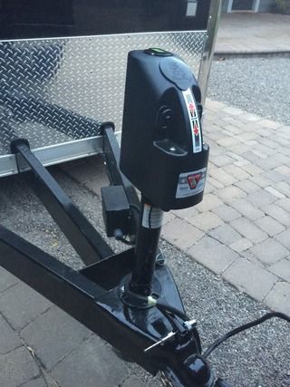

QUIKSVT Posted August 1, 2015 Author Report Share Posted August 1, 2015 Well currently out in California and took the trailer loaded with the Shelby on its first road trip- Phoenix to LA. Towed fantastic with no issues and actually feels much more stable at speed loaded than it did empty. I did install a bulldog electric trailer jack before I left- much easier to use especially when the car is loaded. About as easy as it gets on the install- if you have a battery on the tongue then the power wire that comes with the jack is long enough- otherwise you have to splice in an extension like I did. Seems silly the thing doesn't come with the $.50 battery connector fitting but you'll need to purchase that too. Quote Link to comment Share on other sites More sharing options...
