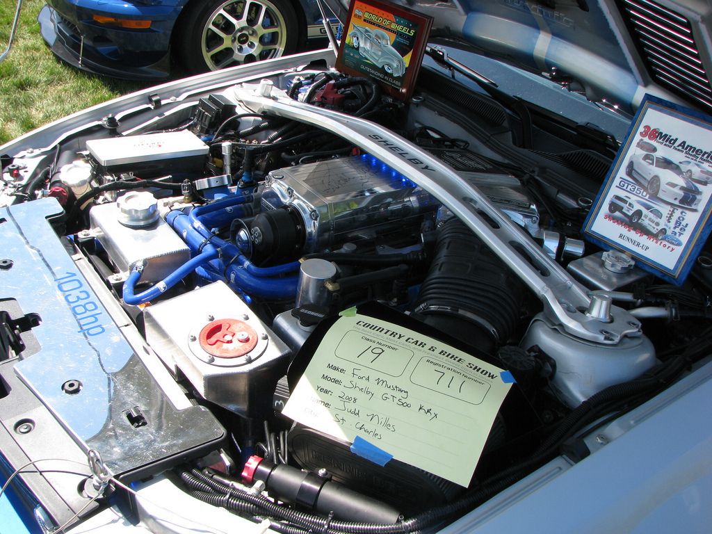

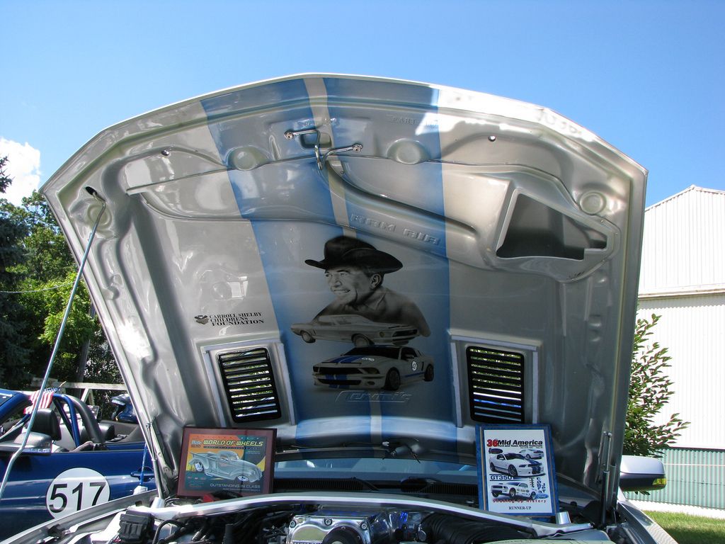

Robert M Posted April 8, 2015 Report Share Posted April 8, 2015 I came across this STB set-up in a S197 with a 2.8KB, so I grabbed some pictures......... On a regular production Super Snake FG hood there may be contact with the extractors when using this Shelby STB since it is more rearward under the hood. The KB 2.8 fits so nicely below this STB, my guess is that the 5.4 DOHC has been lowered. The above pictures are mainly to show this Shelby STB and it's fit with a KB 2.8. This STB is also discontinued (I think), but it shows another possible STB option? R Quote Link to comment Share on other sites More sharing options...
jsimmons Posted April 9, 2015 Author Report Share Posted April 9, 2015 I came across this STB set-up in a S197 with a 2.8KB, so I grabbed some pictures......... On a regular production Super Snake FG hood there may be contact with the extractors when using this Shelby STB since it is more rearward under the hood. The KB 2.8 fits so nicely below this STB, my guess is that the 5.4 DOHC has been lowered. The above pictures are mainly to show this Shelby STB and it's fit with a KB 2.8. This STB is also discontinued (I think), but it shows another possible STB option? R I can't use that one because I have caster/camber plates that essentially prevent the use of the outer-most stud plate bolts. Quote Link to comment Share on other sites More sharing options...
