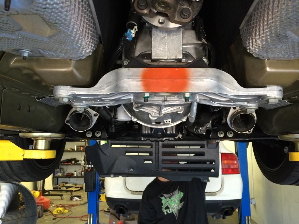

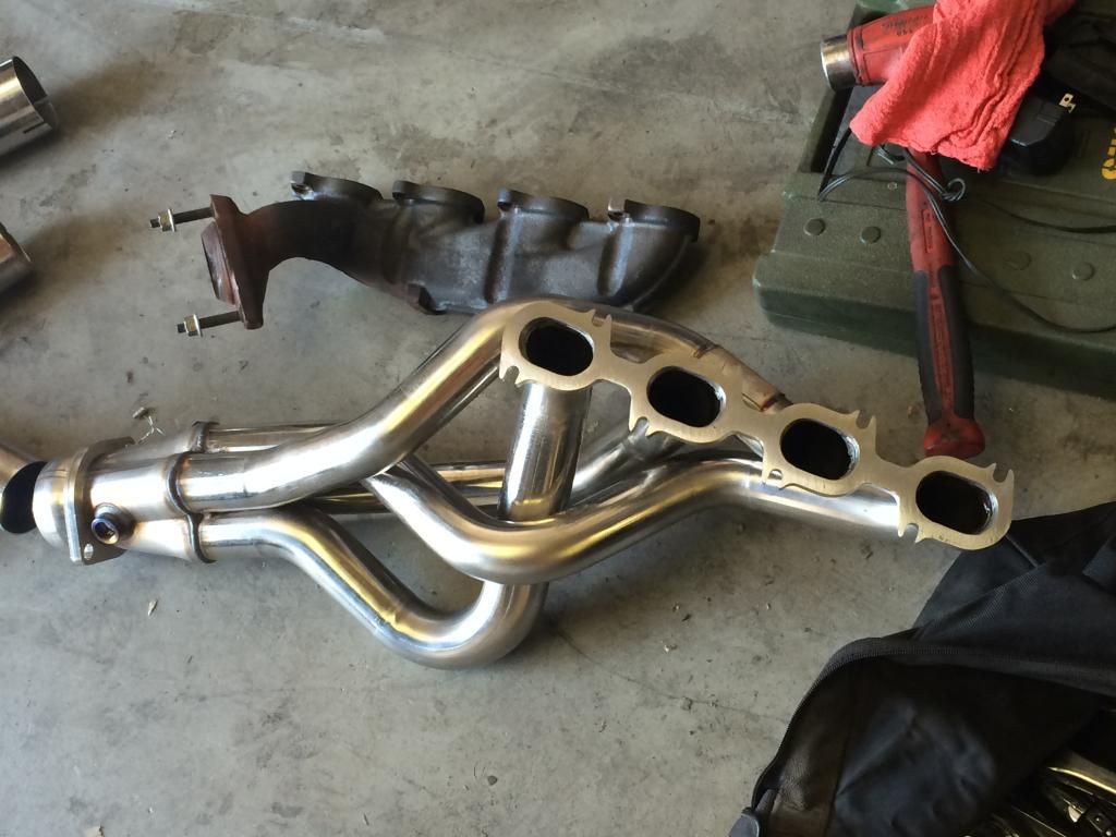

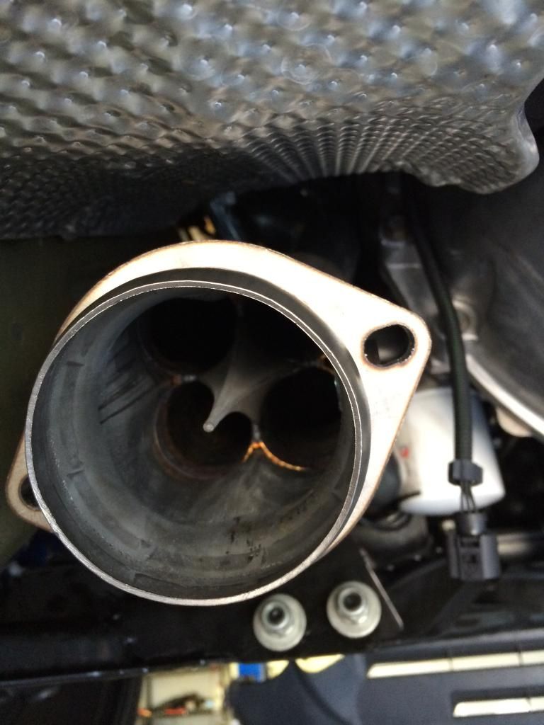

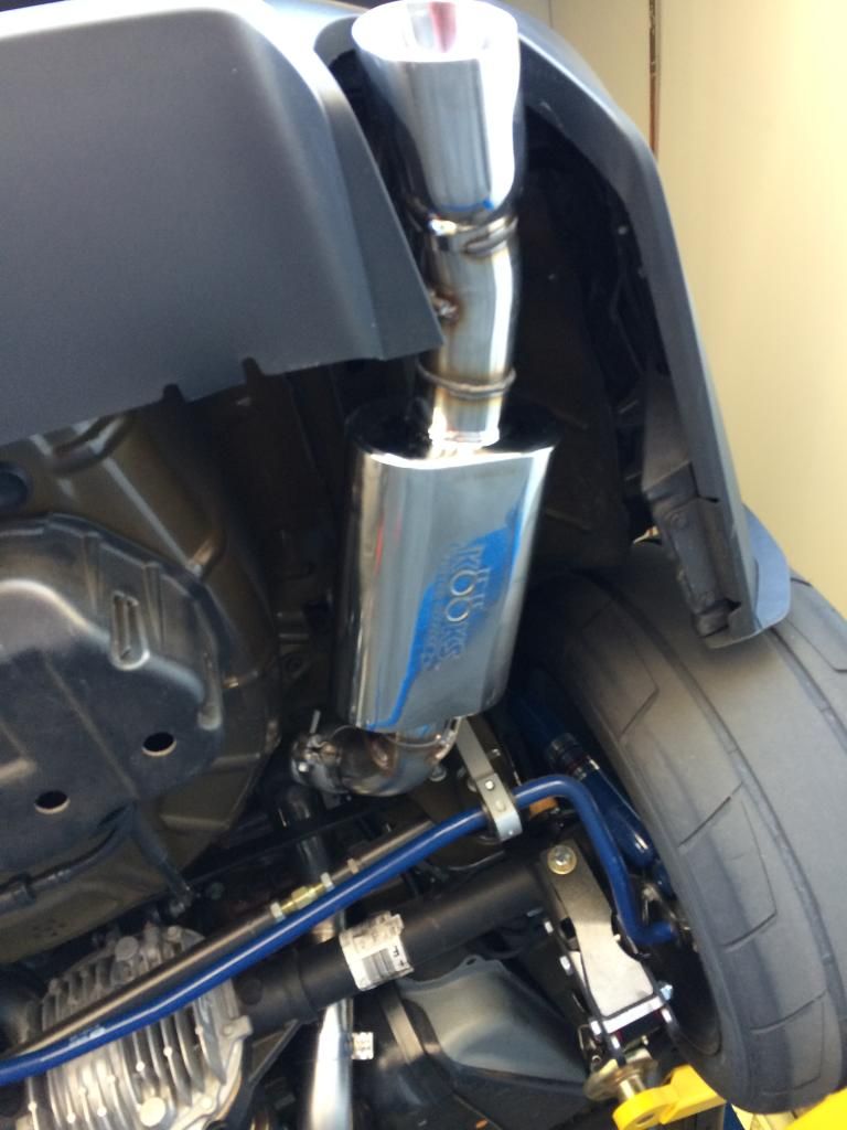

QUIKSVT Posted June 29, 2014 Report Share Posted June 29, 2014 (edited) Well after about a 9 hour day, we got my full cooks exhaust setup installed. Installed were Kook's Longtube Headers (1-7/8"), kooks 3" catted H-pipe, and cooks 3" catback. While we were at we threw on a dynotech aluminum driveshaft and bmr safety loop. All in all the install was not that bad thanks to doing some research on what others found as problems when tackling the headers. We did loosen the K-member a bit to get them to slide in. All in all I'm happy with the sound after a short drive home. I'm looking forward to getting it tuned next week and will post some sound clips. I thought others might find this thread useful if considering this exhaust setup. Edited June 29, 2014 by QUIKSVT Quote Link to comment Share on other sites More sharing options...
gotoatz Posted June 29, 2014 Report Share Posted June 29, 2014 Looks outstanding. Very clean install. Awesome job on your part!!! Congrats, Mike Quote Link to comment Share on other sites More sharing options...
slvrbullet Posted June 29, 2014 Report Share Posted June 29, 2014 Nice! How's it sound? Quote Link to comment Share on other sites More sharing options...
