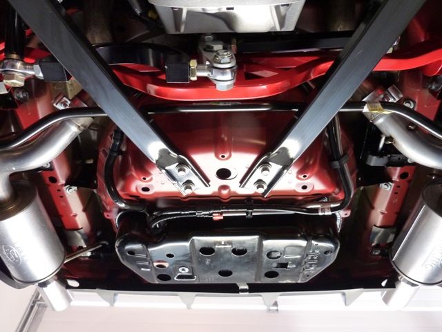

Robert M Posted October 19, 2013 Report Share Posted October 19, 2013 (edited) Here is a thread from the SuperSnake forum that I started a couple of years ago. The second post in the link below shows a Red Fays2 and I believe a G2 FRPP billet cover on a convertible application............... http://www.teamshelby.com/forums/index.php/topic/63725-fays2-watts-link-anyone-using-this/page-1 ^^^^^^The last picture in the second post linked above shows a propeller to cover clearance. I believe, but am not positive that the trick was to turn the propeller bolt around for additional billet cover clearance. Here is the view I am talking about............. R Edited October 19, 2013 by Robert M Quote Link to comment Share on other sites More sharing options...
