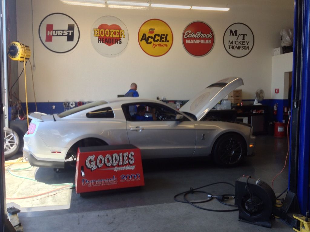

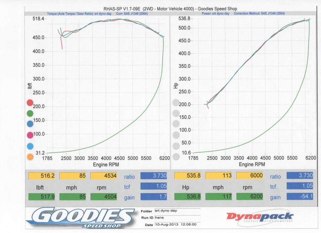

HAZE Posted August 11, 2013 Report Share Posted August 11, 2013 High stock dyno results ? All I have is Air Inlet Resonator Delete and an air raid filter. I ended up with 536 hp and 517 lbft, I thought it should have been more around 470 hp. Was the dyno off ? Quote Link to comment Share on other sites More sharing options...

kozumasbullitt Posted August 11, 2013 Report Share Posted August 11, 2013 You were on a dynapack not a dynojet, there are a few out here and they read way higher. TPS motorsports in Campbell has a dynojet if you wanted to compare. I put down 640rwhp on a dynojet and others with my exact set up has put down over 700 on a dynapack. Quote Link to comment Share on other sites More sharing options...
kozumasbullitt Posted August 11, 2013 Report Share Posted August 11, 2013 You were on a dynapack not a dynojet, there are a few out here and they read way higher. TPS motorsports in Campbell has a dynojet if you wanted to compare. I put down 640rwhp on a dynojet and others with my exact set up has put down over 700 on a dynapack. Just to fully clarify, the dynapacks in this area are way off. They read about 10% higher than realistic. I think the culture out here is all about having big dyno numbers so most shops oblige and tweak their dyno accordingly. A Dynapack can be relatively close to a dynojet if they calibrated them so but again, not out here. Quote Link to comment Share on other sites More sharing options...
HAZE Posted August 11, 2013 Author Report Share Posted August 11, 2013 (edited) Just to fully clarify, the dynapacks in this area are way off. They read about 10% higher than realistic. I think the culture out here is all about having big dyno numbers so most shops oblige and tweak their dyno accordingly. A Dynapack can be relatively close to a dynojet if they calibrated them so but again, not out here.ThanksI will have to look into Tps motorsport. This was the same day they had Cars and coffee at club auto sport, so it only cost me $60 for 3 pulls. Edited August 11, 2013 by HAZE Quote Link to comment Share on other sites More sharing options...
kozumasbullitt Posted August 11, 2013 Report Share Posted August 11, 2013 Thanks I will have to look into Tps motorsport. This was the same day they had Cars and coffee at club auto sport, so it only cost me $60 for 3 pulls. Dyno numbers mean very little. It is just important to use the same dyno for baseline and after when you do mods to see your improvements. Quote Link to comment Share on other sites More sharing options...
nshttpd Posted August 15, 2013 Report Share Posted August 15, 2013 Dyno numbers mean very little. It is just important to use the same dyno for baseline and after when you do mods to see your improvements. This .... I know in motorcycle land the Dynojet units read around 10-13% higher than Factory Tune models. I haven't heard yet how the Bazzaz units compare. Once you start tuning on a particular model you'll want to stick with it. -steve Quote Link to comment Share on other sites More sharing options...
Crushinator Posted August 16, 2013 Report Share Posted August 16, 2013 My '12 with JLT 127, 2.5" pulley and VMP tune did 517 rwhp and 513 rwtq. On the same dyno, with the '13 TVS, same intake and different tune it did 672 rwhp and 656 rwtq. So it gained 155 rwhp and 143 rwtq just from switching the blower. Base dyno numbers are just a measuring device...actually, any dyno numbers are just a measuring device. Take dyno numbers with a grain of salt. Someone who dyno's 480 rwhp on one dyno, may in fact have a faster car than you who dyno'd much higher on a different dyno. Quote Link to comment Share on other sites More sharing options...
