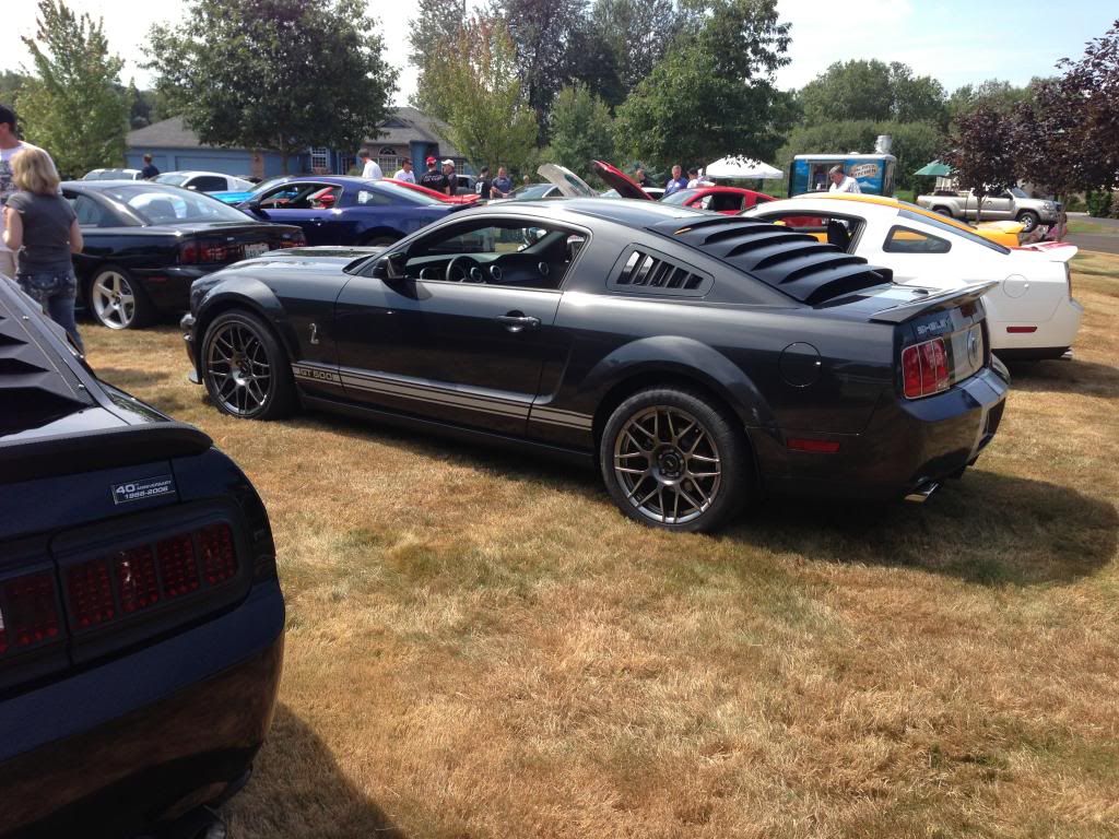

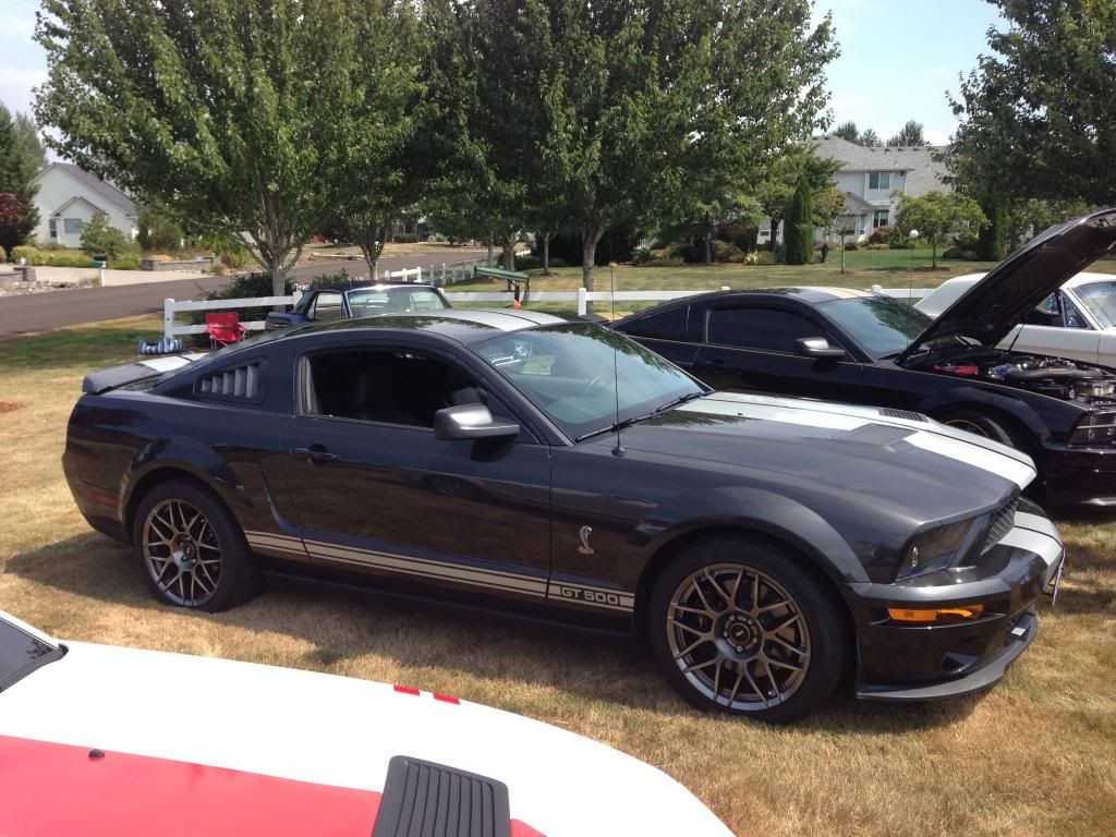

SteelSteeds Posted August 11, 2013 Report Share Posted August 11, 2013 The pictures I took today at the Meet & Greet didn't turn out as well as I'd hoped, I'll try to get some better ones in the next day or two. Hopefully this gives you an idea! Quote Link to comment Share on other sites More sharing options...

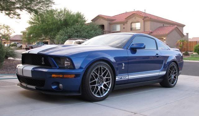

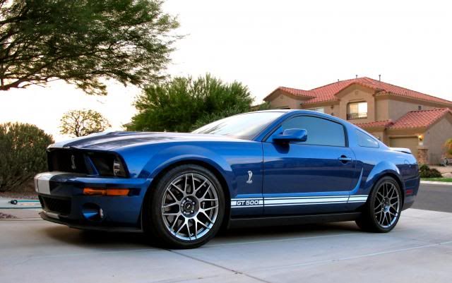

Snake Handler Posted August 11, 2013 Report Share Posted August 11, 2013 (edited) Here you go. The first pic is with 19s on the front and 20s on the rear. The second pic is 19s on all four corners. Edited August 11, 2013 by Snake Handler Quote Link to comment Share on other sites More sharing options...
buffalotr8 Posted August 11, 2013 Author Report Share Posted August 11, 2013 Thanks guys they look awesome. Snake handler, did you buy two full sets of 19/20s to see if you liked the 19s or 20s? Also did you have to change out the tpms? Quote Link to comment Share on other sites More sharing options...
