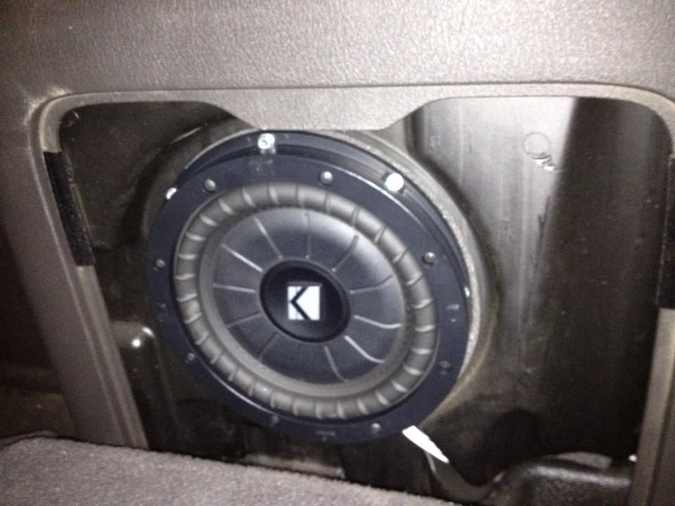

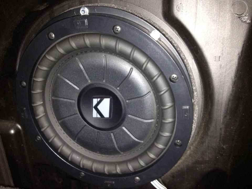

The end result;
41d448e1f9a65ac2b55d9dddc9101a42_zps44d8
fb10eab9a4a59f8b6edeb5ae767fcfc1_zps4cd7
Taking things very slowly & working in 82 degree heat in my garage it took around an hour to complete the installation.
