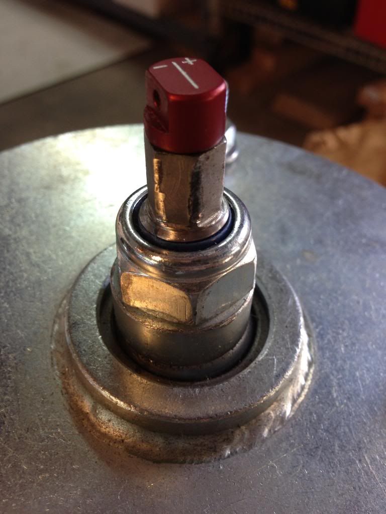

07SGT5687 Posted June 2, 2013 Report Share Posted June 2, 2013 So I was flying through the install of the Eibach R1 coilovers and then a screeching halt. The top nut of the front coilovers won't come loose so I can apply the adapter plate for the MM caster camber plates I have. I'm pretty close to rounding off that top strut piece that you anchor to to turn the large nut... WTF am I doing wrong and how to I get it to come off? At a stand still at the moment. Quote Link to comment Share on other sites More sharing options...
HyperStangs Posted June 2, 2013 Report Share Posted June 2, 2013 (edited) If memory serves me right, I believe there's a snap ring located just below that rounded flange. Edited June 2, 2013 by HyperStangs Quote Link to comment Share on other sites More sharing options...
07SGT5687 Posted June 2, 2013 Author Report Share Posted June 2, 2013 If memory serves me right, I believe there's a snap ring located just below that rounded flange. thank you for the response, but I'm sorry, I don't follow you. Can you be a little more specific. Sometimes my vocabulary doesn't quite measure up! Quote Link to comment Share on other sites More sharing options...
HyperStangs Posted June 2, 2013 Report Share Posted June 2, 2013 (edited) If I'm not mistaken, there is a snap-ring located right where the arrow is pointing. If you remove it the hat will slide off. But I guess I'm not sure why you want to remove it since it mounts to the caster/camber plates. Edited June 2, 2013 by HyperStangs Quote Link to comment Share on other sites More sharing options...
07SGT5687 Posted June 2, 2013 Author Report Share Posted June 2, 2013 If I'm not mistaken, there is a snap-ring located right where the arrow is pointing. If you remove it the hat will slide off. But I guess I'm not sure why you want to remove it since it mounts to the caster/camber plates. Nope, no snap ring on this setup. And the plate you see is replaced by the caster/camber plates. Was able to get it loose by just using a few quick bursts from an impact wrench. How frustrating. And since I don't have an open-ended torque wrench, I had to "feel" out the 46 lb. ft. is needed by spec. Thanks for the quick responses though. Quote Link to comment Share on other sites More sharing options...
