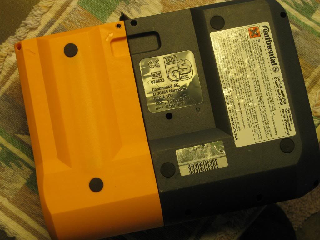

Now, pick the inflator up on it's edge, and align the pin you were turning the plate with, with the square small box inside the orange clam shell...
What you would then have, should look just like this...
Now, it's very important that you once again flip the orange side back down, so that it now looks like one unit, then remove the orange clam shell once again. The unit needs to be flat like this, prior to installing the new bottle of tire Goo. When the orange side is flipped up, this is what activates the tire Goo discharge. You do not want that right now icon_eek.gif Assure that you install the rubber gasket inside the adapter plate where the tire Goo thread into...
Remove the red cap from the tire Goo, discard, then thread the tire Goo bottle onto the adapter. Be careful not to cross thread...
Now re-install the orange clam shell. Take care to align the pins as was noted above...
After the clam shell is folded closed, re-tighten the two Torx screws...
Install the new speed limit warning sticker...
Install the new expiration date sticker...
And that is it. You now have a newly charged Tire Inflator...
Re-install the entire pump / tire sealer back into the styrofoam case it comes in...
Re-install the unit back into the truck in the spare tire well...
And you are once again, ready for a local tire puncture, should you not yet have a full size spare available. Again, not saying I would prefer this over the full size spare, but it does work fairly effectively in a pinch...
I warned my tire guy that the tire was full of tire Goo before he removed and unmounted the tire. I have had no issues thus far, with the TPMS on the wheel in question, as has been noted as a possibility in other threads...
Hope this how to helps someone that is unfamiliar with the inflator, or someone that may be waiting to repair a used one........
