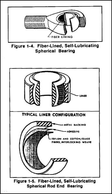

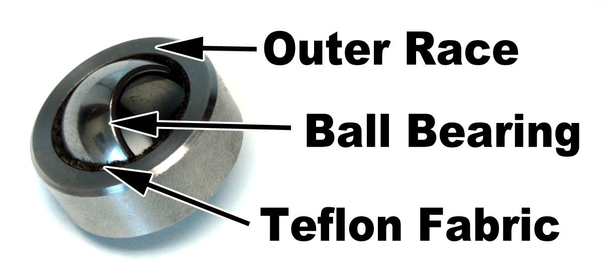

Tob Posted October 22, 2012 Report Share Posted October 22, 2012 (edited) 5. "Race ends" were designed for racing. They were not designed to be sprayed with sand, salt, and crud on a daily-driven car. So keeping them clean is a must. Most of our "race end" products are Teflon-coated, for easier cleaning. But they still need to be cleaned! Jer Jer, the Teflon in a rod end doesn't utilize a coating but rather a fabric/weave. Self lubricating and with a rather low coefficient of friction. If you are 'coating' anything with Teflon for easier cleaning I'd be interested to see more about what you are referring to. Edited October 22, 2012 by Tob Quote Link to comment Share on other sites More sharing options...
Kevin Patten Posted October 22, 2012 Report Share Posted October 22, 2012 Lots of good info in this thread, I'll confirm a few things and add a few: 3. They need to be finally tightened ONLY when the suspension is under load, to prevent pre-loading them in the wrong position. Then they will always be "twisted" somewhat. This decreases their effectiveness and makes them creak, too. Jer This is only true with rubber - torsional-elastic bushings not with polyurethane bushings ! Quote Link to comment Share on other sites More sharing options...
Jer Posted October 22, 2012 Report Share Posted October 22, 2012 Corrections: While I was trying to get the point across that all suspensions should be tightened and torqued at "loaded" position, Mr. Albino clarifies further. OK. As for the Teflon: Well, I did say "coated", rather than "lined", so thanks for that clarification. To compliment the upper control arm, two styles of lower control arms are offered to match your specific vehicle purpose and handling needs: The ‘Street Version’ has self-lubricating UHMW (Ultra High Molecular Weight Polyethelene) bushings in the body side with a self contained self lubricating Teflon/PTFE lined race spherical bearing in the axle side, or the ‘Race Version’ that uses high grade ¾" chromoly self-lubricating Teflon/PTFE lined race rod ends. Jer Quote Link to comment Share on other sites More sharing options...
