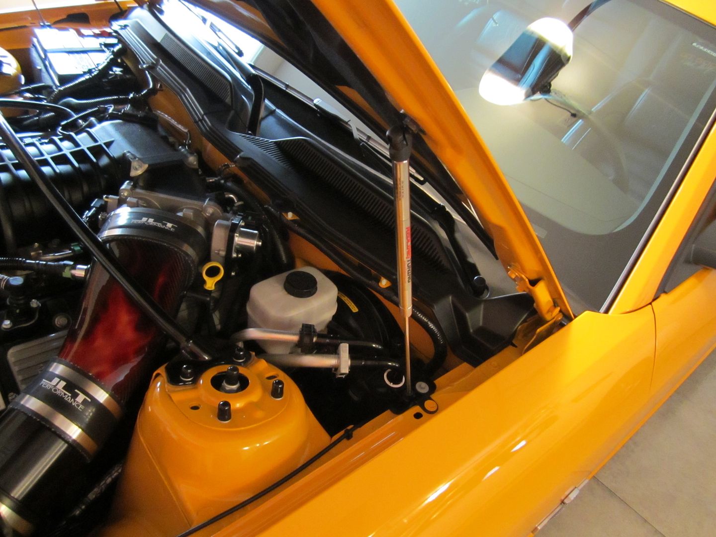

Grabber Posted May 1, 2012 Report Share Posted May 1, 2012 I just finished installing my new Redline / Tuning quickLIFT ELITE hood struts. My Steeda hood struts are 5 years old and will not hold my hood up any longer. These newly designed Redline struts do not require any drilling and the install is very easy to do. The parts are top notch quality and the connections are right on. The hardware fits great and makes very positive connections. When the hood opens it slows down automatically during the last 4 inches so the hood does not jolt. Here is a link to the product: http://www.redlinetuning.com/QL-FORD-MUS-05-BOLTIN.html Check out this video of Jay Tucker (JLT) doing a install on his car. Link to comment Share on other sites More sharing options...

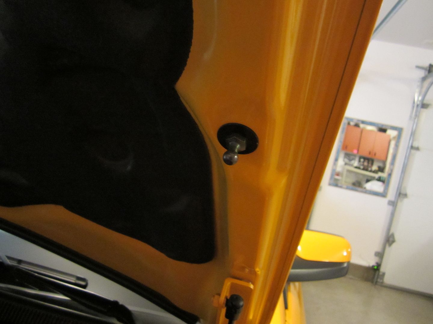

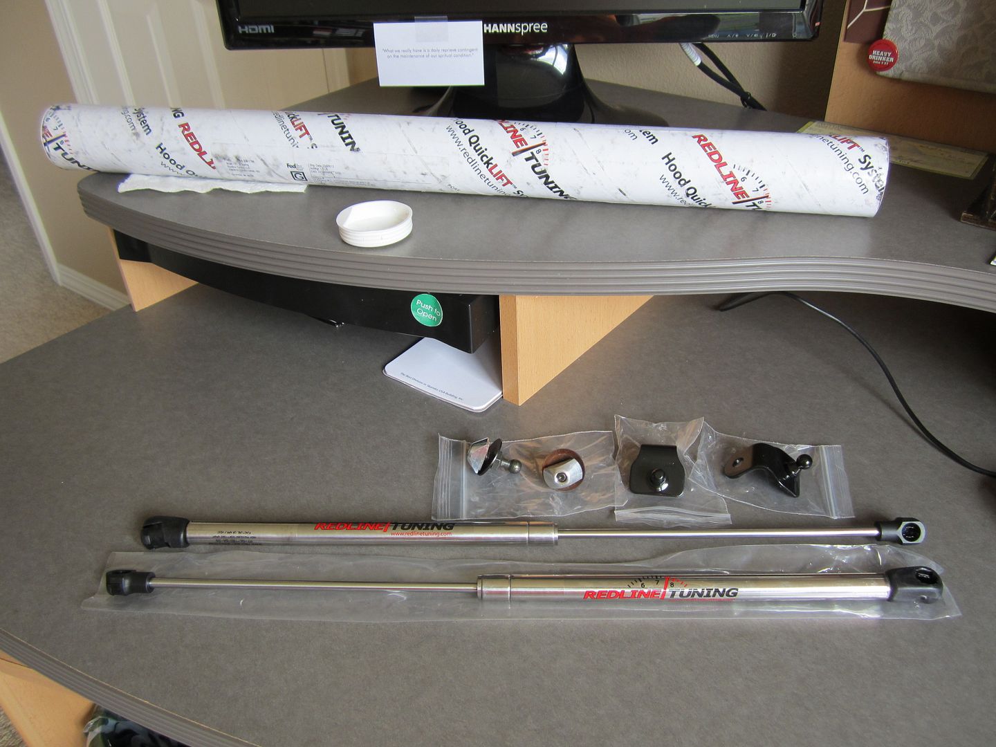

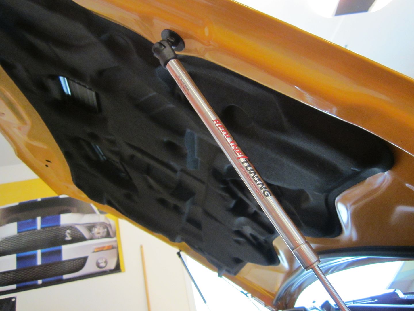

Grabber Posted May 1, 2012 Author Report Share Posted May 1, 2012 Here is the packaging and parts and color instructions that are very easy to follow. One strut holds the hood up, so the install is very easy. This is a pic of my 5 year old failed Steeda struts. Never did like the back ball joint design because it pivoted if you did not get it tight enough. Link to comment Share on other sites More sharing options...

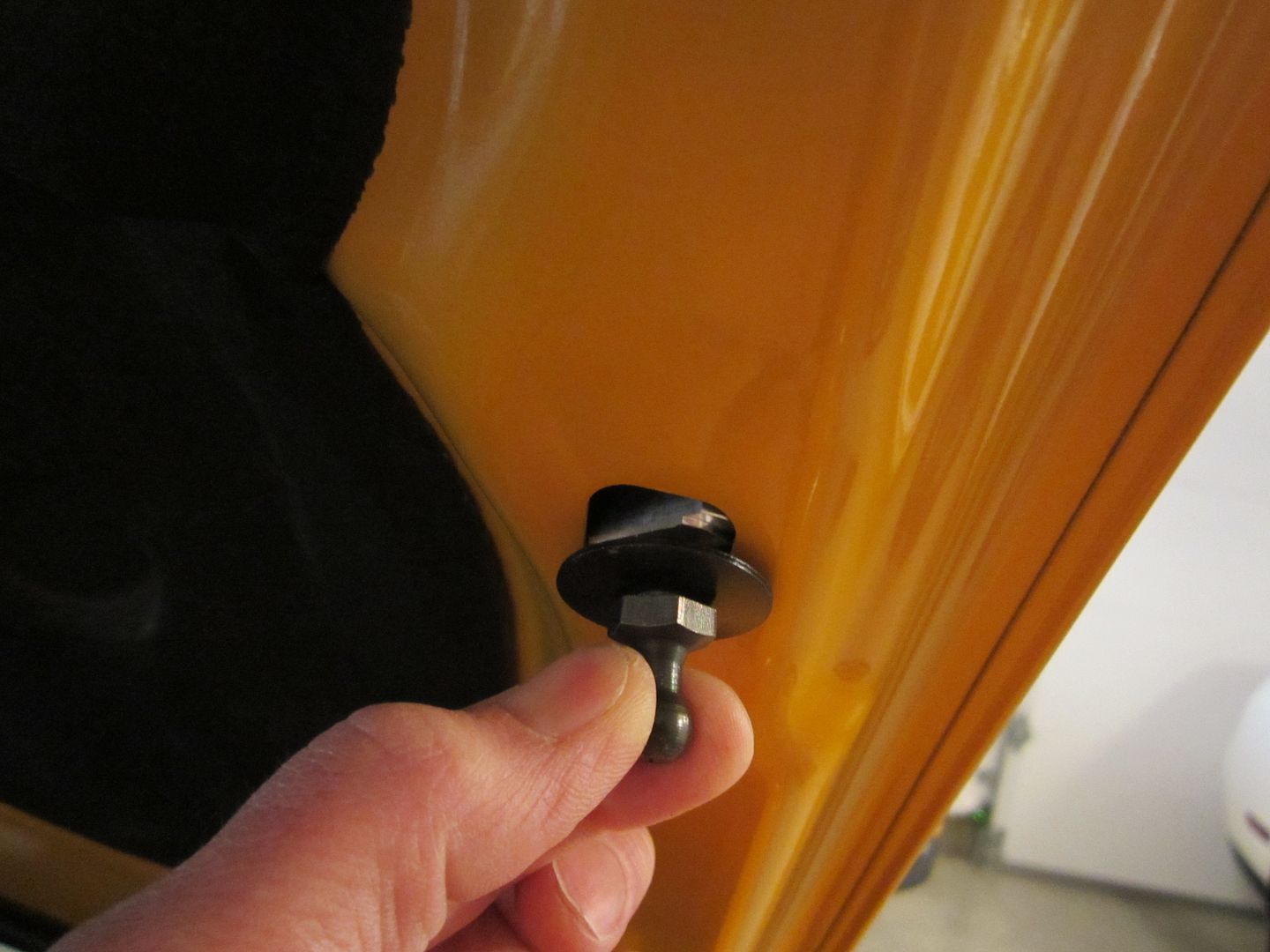

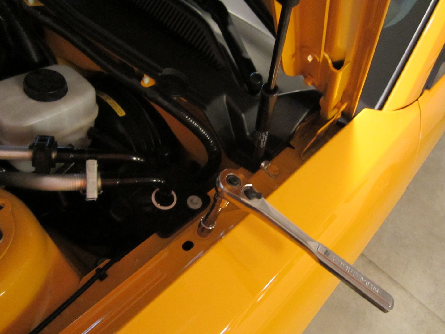

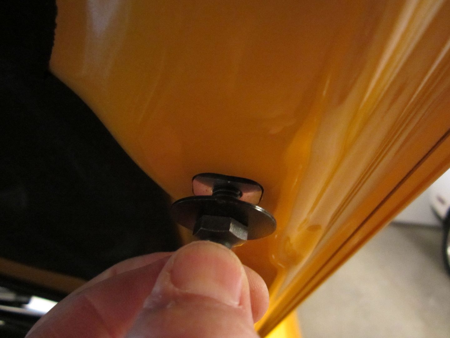

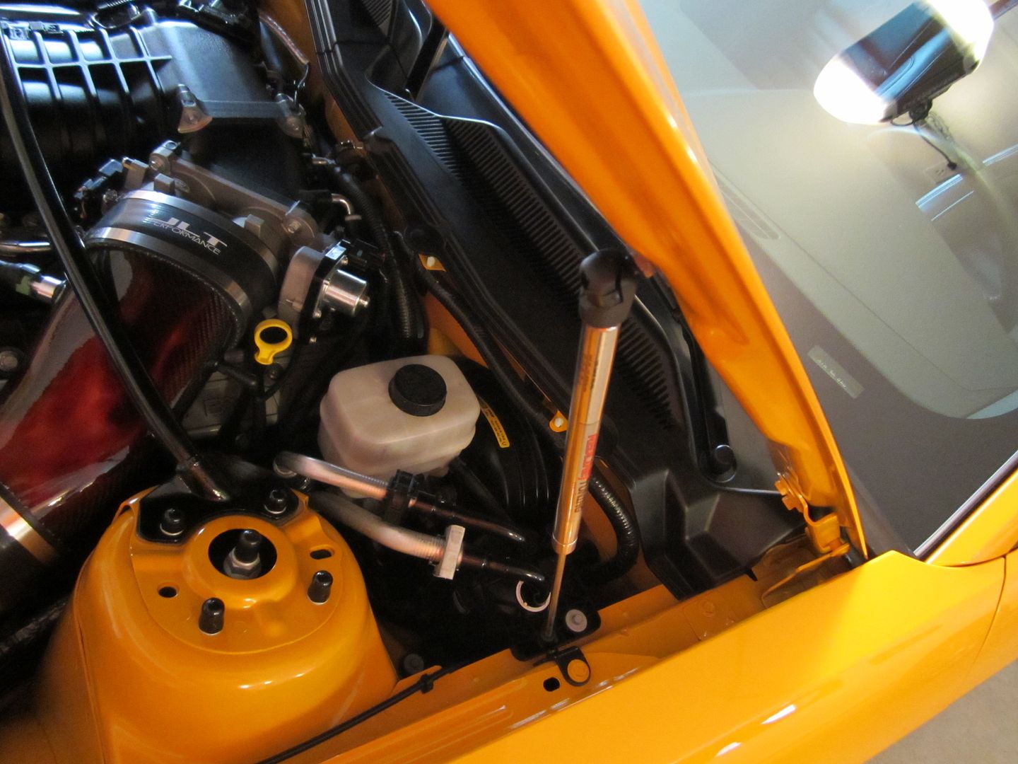

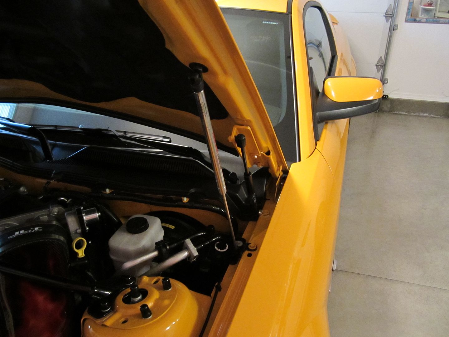

Grabber Posted May 1, 2012 Author Report Share Posted May 1, 2012 I like the hardware that goes in the factory hole on the hood. The part locks into the hole and then you tighten it down. Then put the bottom piece on the fender using the existing fender bolt and snap the strut into place. I then removed my old shot Steeda’s and then did the other side. Link to comment Share on other sites More sharing options...

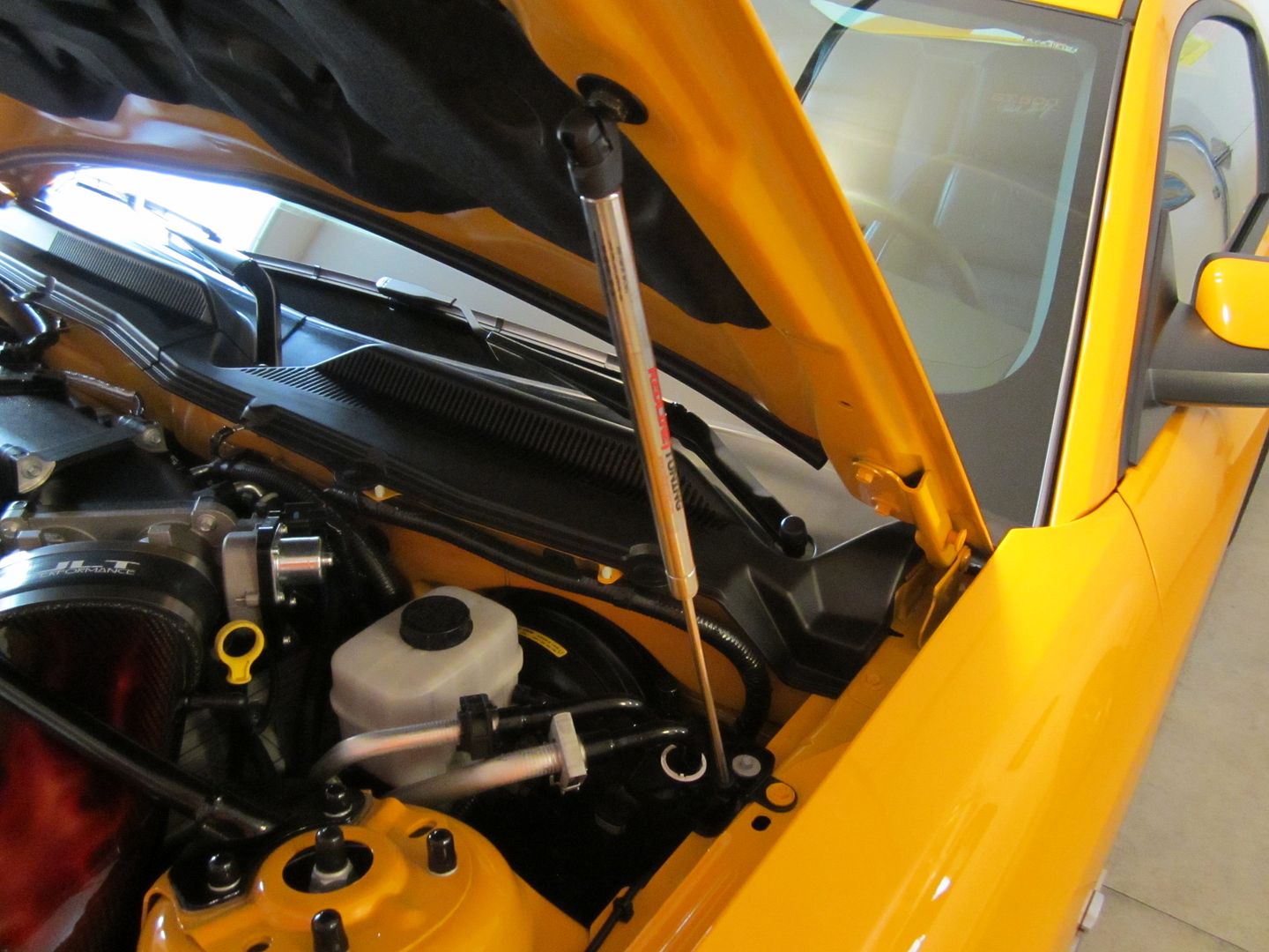

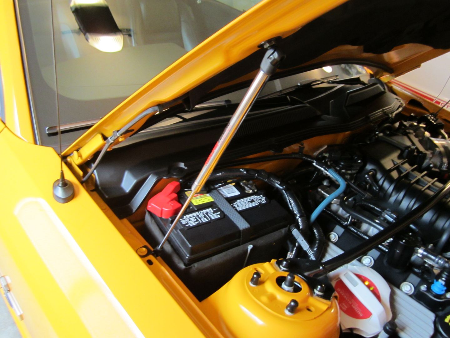

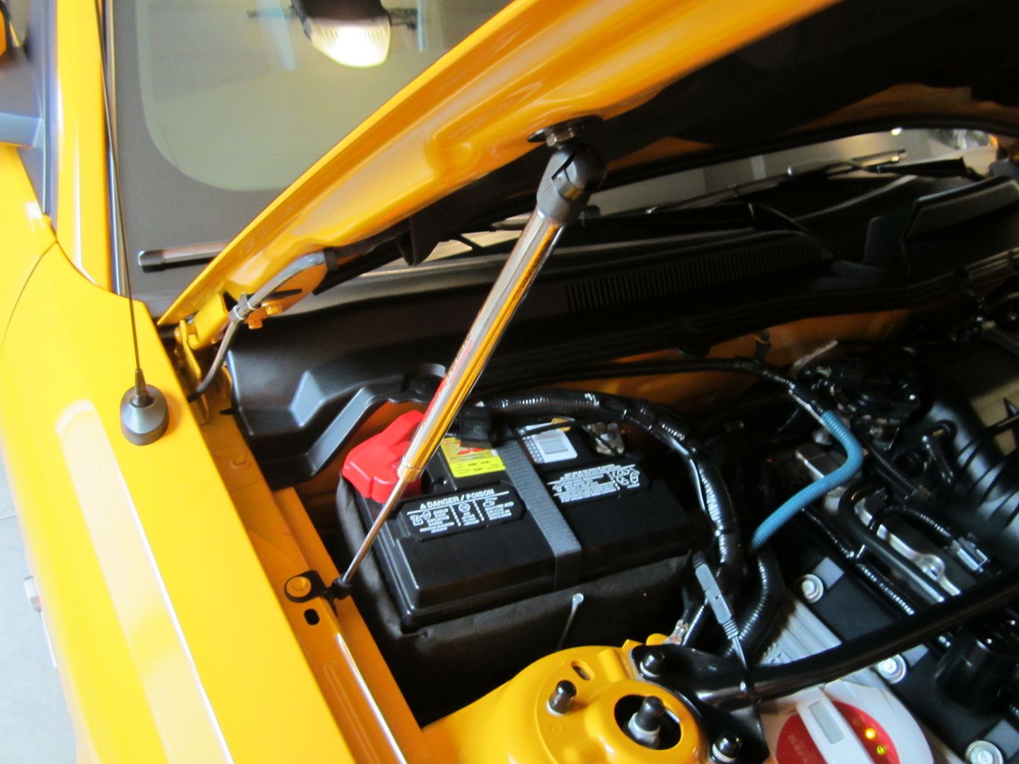

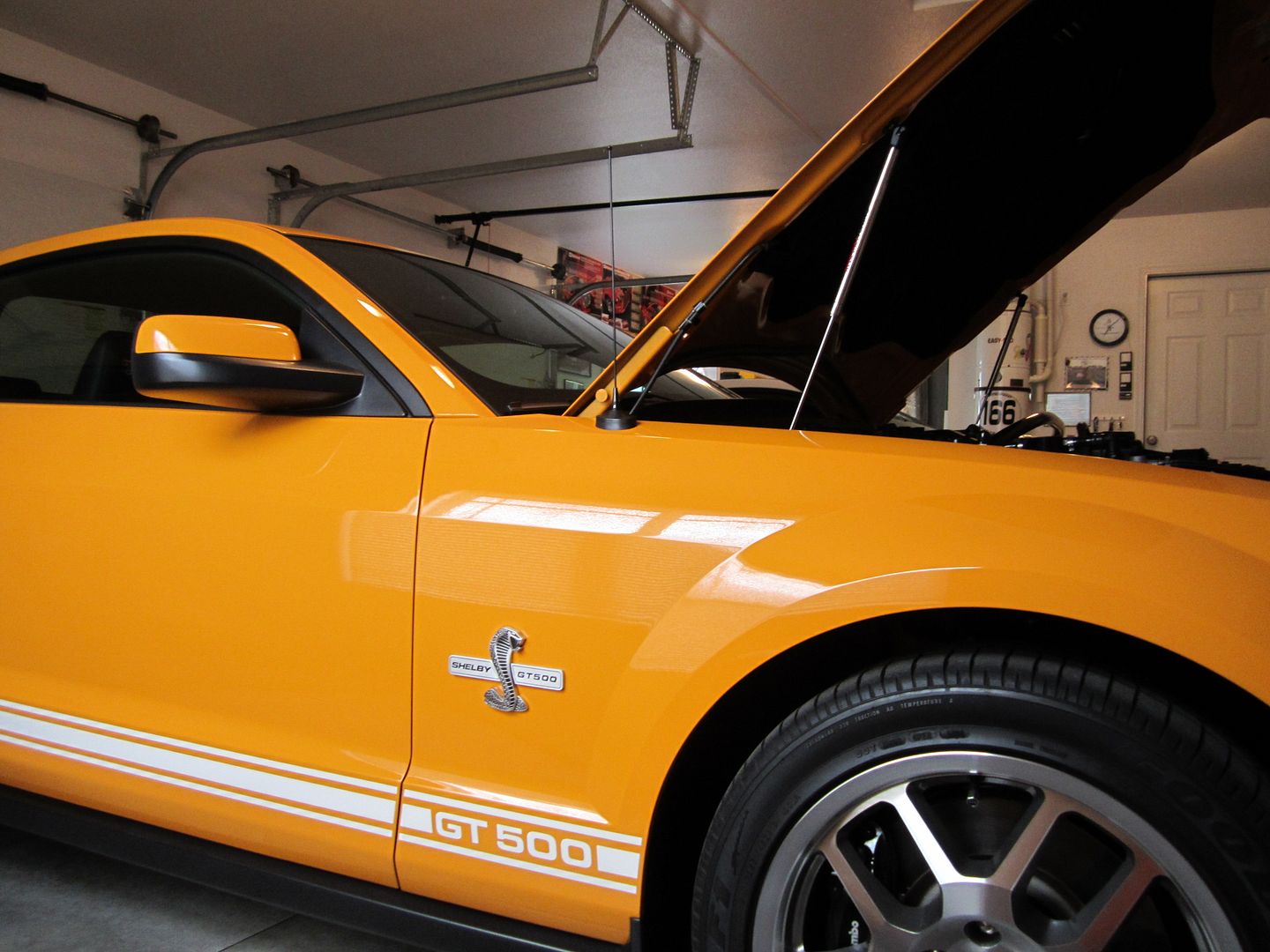

Grabber Posted May 1, 2012 Author Report Share Posted May 1, 2012 Here are some pic’s of the finished installation. It is necessary to take some touch up paint and dab the existing bolt heads to make them look new again. Link to comment Share on other sites More sharing options...

awakeinAZ Posted May 2, 2012 Report Share Posted May 2, 2012 Nice, I like that you dont have to unbolt the factory hinge. Link to comment Share on other sites More sharing options...
Grabber Posted May 2, 2012 Author Report Share Posted May 2, 2012 Yes that is nice and as you can see the fulcrum point is in a much better place to allow the shocks to be stronger. It also appears to put less stress on the hood. Link to comment Share on other sites More sharing options...

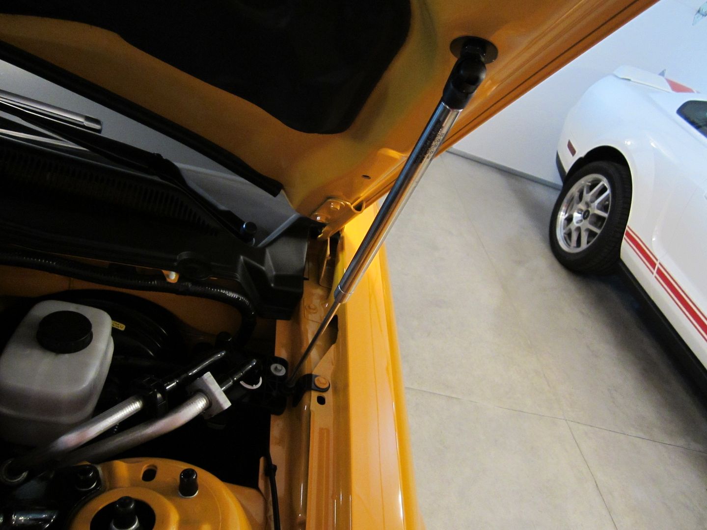

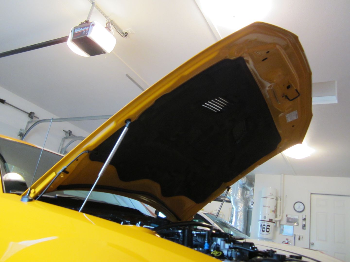

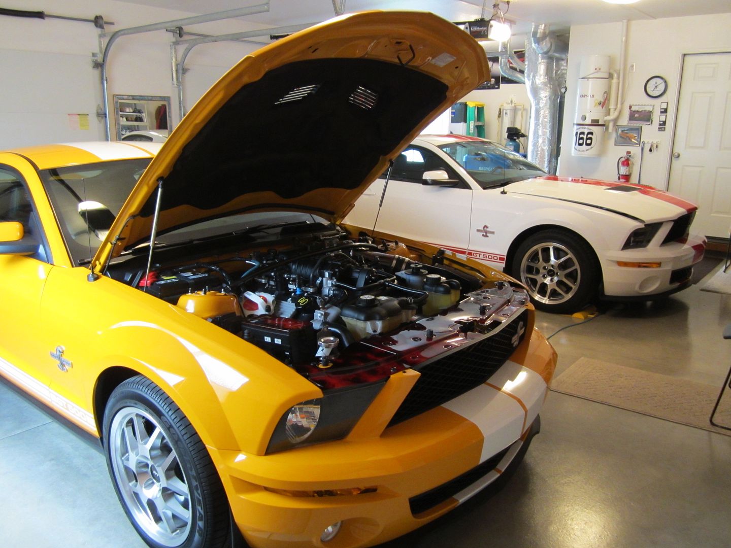

fcettner Posted May 3, 2012 Report Share Posted May 3, 2012 Hood struts arrived today and installed. Here's some pics: Link to comment Share on other sites More sharing options...
fcettner Posted May 3, 2012 Report Share Posted May 3, 2012 More pictures: Link to comment Share on other sites More sharing options...
