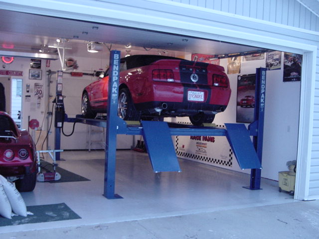

I have a four post lift. What I decided was to upgrade to a 12,000 lb. lift that allowed the wider opening. see 25-1
pic 27-1 has the location of a standard storge lift with a distance of ~96" between posts.
The lift I installed is actually 123" between posts the right hand posts are against the block wall and the left hand posts are next the seam in the floor.
That illiminates having to shoehorn the lower car in between posts.

Share on other sites
the 2 vettes are gone --- new vette and GT500 replaced those 2
the complete door track system and opener had to be modified heavily
the tracks were modified so that they are against the ceiling 6" spacing
the door opener was scraped and an industrial wall mount opener was installed (this was 10 years ago --- there are other options available)
the lift unit is roller chain not aircraft cables ---- the rollers and chain assemblies, I felt were more durable
the unit is a 220 volt motor/hydraulic system
in the pic 37-1 you can see the hydraulic tank, motor, and cylinder assembly. The positive stop is the teeth along the horizontal frame
The lift is raised to the position of your choice, the swing arm lock mounted on the end of the cylinder will drop into a lock notch as you lower the vehicle an inch or so.
The ramps are floating. I had to make an attachment and weld it on the ramp to hold the ramps up when the lift is raised. You can not drive the lower vehicle into the lower space
with the ramps down. They hang to low. This is a design safety feature that keeps the car from rolling off of lift.
The garage ceiling is 10 foot
One major mistake I made. The horizontal cylinder frame should have been against the wall. No functional issue, just doesn't look as clean as it should.
This unit is American built also. I had it delivered to a towing company that has a dock and they delivered to the house on installation day.

I have a four post BendPak and replaced the overhead chain driven garage door opener with a wall mounted LiftMaster and moved the garage door tracks up closer to the ceiling. I went with Bendpak after researching on this site, looking at what local garages had installed and overall customer service (ease of orderding, delivery and setup).

The 4 post Bend Pack at my Dad's shop is nice and has the ability to lift the vehicle off the deck using hidden built in jacks that come out of the deck. Its great for tire changes and suspension work and doesn't take up space like the rolling bridge jacks. Its the best of both worlds
