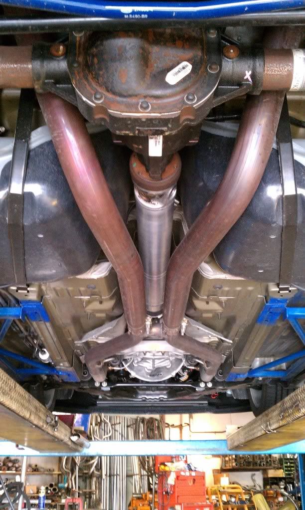

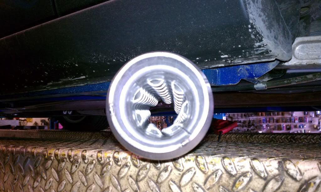

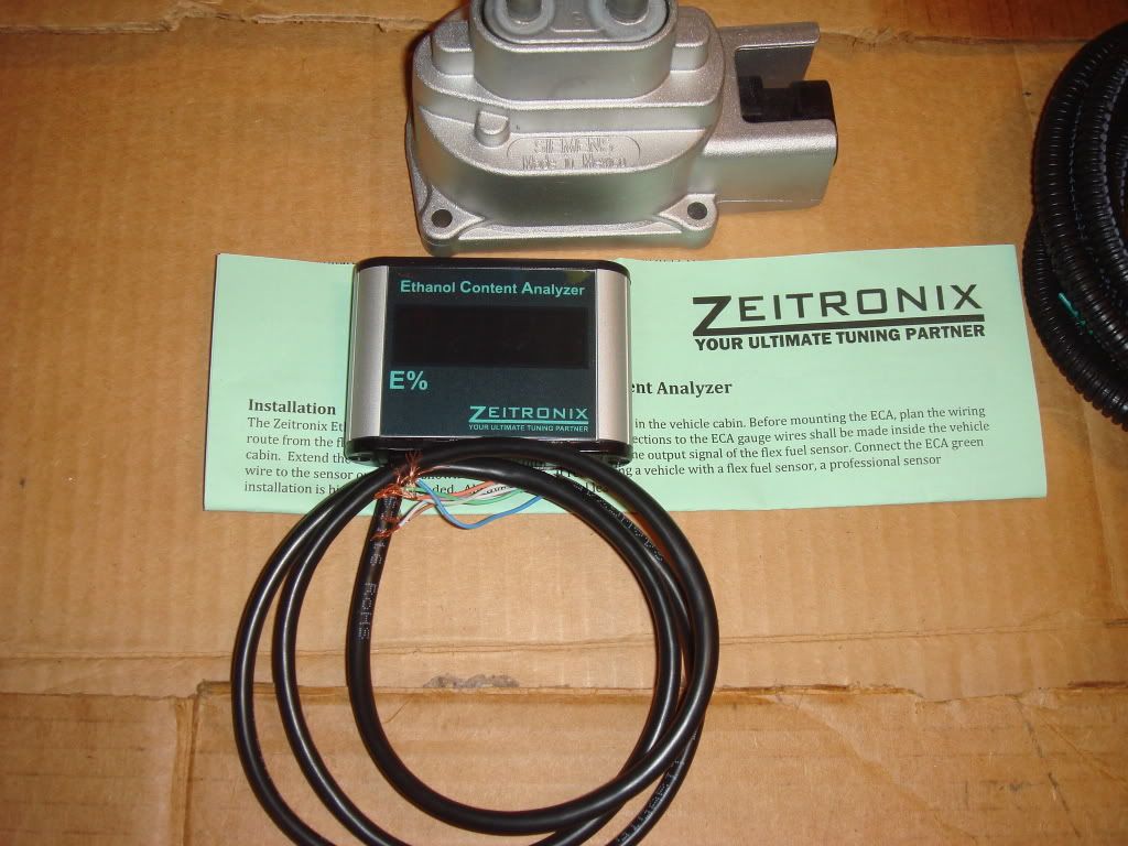

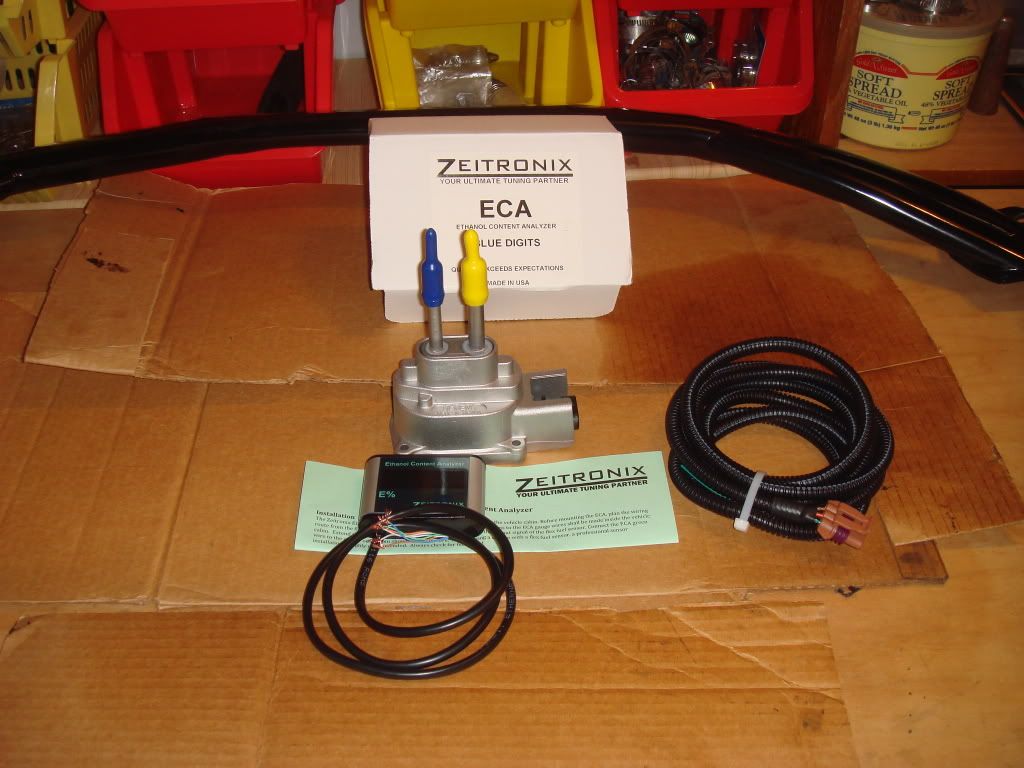

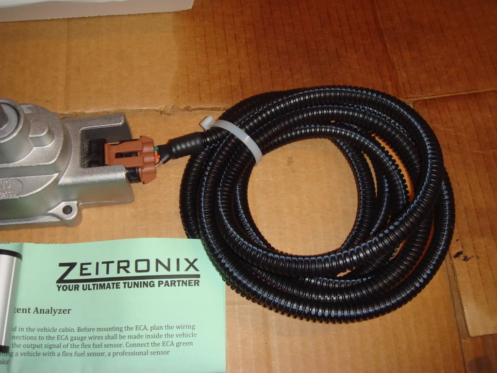

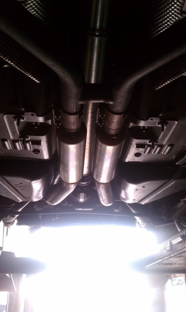

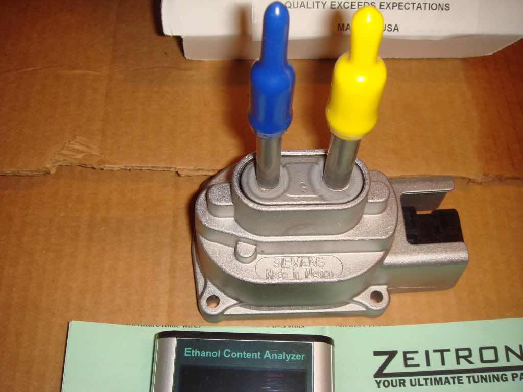

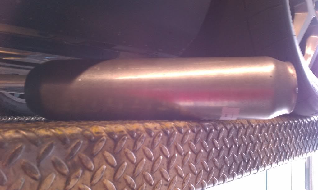

me32 Posted February 8, 2011 Report Share Posted February 8, 2011 getting ready to run E85, ive done most my other fuel mods needed to run E85. here are a few things to finish it all up and then goes to AED to get the Car all setup an running E85 as a primary Tune an a 91Oct tune for long trips where E85 is not around. Also big thanks to Brandon at Southern Grind Performance for getting me a great deal on the E85 Analyzer an Senor an getting it to me fast to have it ready for AED. http://i224.photobucket.com/albums/dd65/me3232/new%20mods%201-10-2011/IMAG0162.jpg[/img] http://i224.photobucket.com/albums/dd65/me3232/new%20mods%201-10-2011/IMAG0166.jpg[/img] http://i224.photobucket.com/albums/dd65/me3232/new%20mods%201-10-2011/IMAG0167.jpg[/img] Link to comment Share on other sites More sharing options...

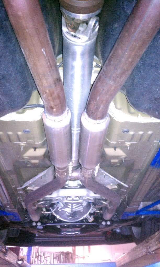

Justin00Stang Posted February 8, 2011 Report Share Posted February 8, 2011 Nice. What's the exhaust part? I need to quiet mine down... Link to comment Share on other sites More sharing options...
BAD500Chris Posted February 8, 2011 Report Share Posted February 8, 2011 Nice. What's the exhaust part? I need to quiet mine down... I actually added the 2011 mustang GT resonators to mine. Placed them after the H pipe. maybe a 15-20% decrease in volume when cruising Link to comment Share on other sites More sharing options...
me32 Posted February 9, 2011 Author Report Share Posted February 9, 2011 I actually added the 2011 mustang GT resonators to mine. Placed them after the H pipe. maybe a 15-20% decrease in volume when cruising Chris is right I added resonators to make the local pd happy. Link to comment Share on other sites More sharing options...
Justin00Stang Posted February 9, 2011 Report Share Posted February 9, 2011 I actually added the 2011 mustang GT resonators to mine. Placed them after the H pipe. maybe a 15-20% decrease in volume when cruising can you buy the 2011 ones seperately or did you cut them out of a GT? I just put LTs & cats on a customers 2011 GT500, its a touch loud with the factory 2.75" exhaust/H pipe/stock mufflers. I think the new exhaust setup for 11s lends itself to being louder. That was one of my suggestions to him, get the over the axle tubes from a GT and bolt them in. I have a 3" catback though so I don't want to use anything smaller than that. Link to comment Share on other sites More sharing options...
BAD500Chris Posted February 9, 2011 Report Share Posted February 9, 2011 can you buy the 2011 ones seperately or did you cut them out of a GT? I just put LTs & cats on a customers 2011 GT500, its a touch loud with the factory 2.75" exhaust/H pipe/stock mufflers. I think the new exhaust setup for 11s lends itself to being louder. That was one of my suggestions to him, get the over the axle tubes from a GT and bolt them in. I have a 3" catback though so I don't want to use anything smaller than that. Cut them out of a GT. Is your whole exhaust 3" or just the catback. If it's just the catback you can place the resonators after the midpipe connector so your exhaust moves from 2.5" (midpipe) > 2.75" (resonator) > 3" (catback). No restriction. Link to comment Share on other sites More sharing options...
me32 Posted February 10, 2011 Author Report Share Posted February 10, 2011 Chris is correct that's what I did on mine Link to comment Share on other sites More sharing options...
sportscars Posted February 16, 2011 Report Share Posted February 16, 2011 Can I ask why the conversion to E85 and what was the cost? Link to comment Share on other sites More sharing options...
thewheelman Posted February 16, 2011 Report Share Posted February 16, 2011 Can I ask why the conversion to E85 and what was the cost? Ditto! Link to comment Share on other sites More sharing options...
BAD500Chris Posted February 16, 2011 Report Share Posted February 16, 2011 The answer to "why" is because for those who like to race at the track a lot, E85 is cheap race gas. (104 octane) Which allows for higher boost and safely advancing the timing. E85 (in northern CA) is currently right around 2.80 per gallon, while race gas is more than 9 bucks a gallon. The cost may vary depending on how your current fuel setup is, the trick is you need to push 30-45% more fuel through your system, so (for me, mostly stock) it's only going to cost me 80lb injectors and a BAP. (close to 800 bucks + a re-tune) If you really want to go nuts just get a return-style setup (1500 from lethal) with big injectors. The only downfall to E85 is that it's not available everywhere. Link to comment Share on other sites More sharing options...
2kmelat Posted February 17, 2011 Report Share Posted February 17, 2011 U are missing one down fall. How long is the government going to use are tax dollar to keep it cheap it is really more expensive then gas Link to comment Share on other sites More sharing options...
dbowles22 Posted February 19, 2011 Report Share Posted February 19, 2011 What are the cons to running E85? I've been thinking about running it in my truck but I don't know anything about it? Link to comment Share on other sites More sharing options...
