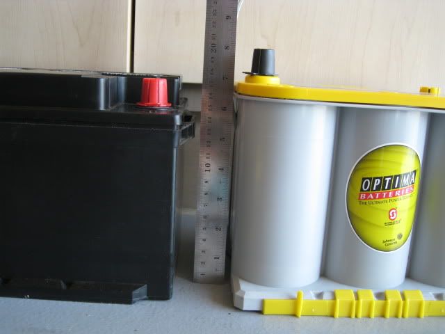

6-Speed Posted November 2, 2010 Report Share Posted November 2, 2010 IMO the D35 Optima is too tall ... at least for the GT500. It fits, but I don't want any battery post that close to the underside of my metal hood regardless of the plastic insulator on the positive terminal. I am going to look into using an Odyssey PC925MJT AGM battery. I just need to come up with a good means to secure it to the OEM tray. Link to comment Share on other sites More sharing options...
