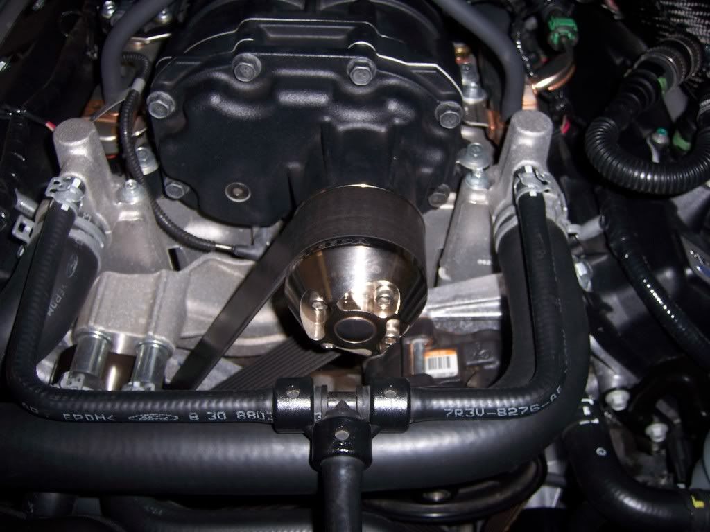

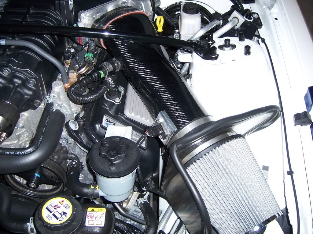

Spring Lil Cobra Posted October 11, 2010 Report Share Posted October 11, 2010 I have the Steeda CF CAI. Here is a photo of it installed. Here also is the Steeda 2.6 pulley installed: Both are nice pieces. The intake gets alot of attention. The pulley looks aftermarket and is the first thing a dealer will frown upon if you take it in for warranty repair. Good luck with your decision. Rich Link to comment Share on other sites More sharing options...
