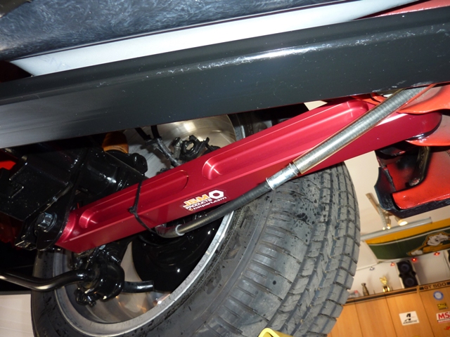

Grabber Posted October 3, 2010 Report Share Posted October 3, 2010 Who else has had this issue and did new upper and lower control arms fix it? Which brand does every one prefer, I'm thinking of Steeda ones? Can hardly excerlerate with out it hopping and does the GT500 have a locker rear end or a limited slip The 500 has a limited slip rear end. I swapped out my rear LCA's only and it got rid of my wheel hop. I used the ones from BMR with the poly bushings. They have been on my car for 2 years now and no problems. Don't forget to turn "off" the traction control when you want to do a burn off. Here's some photo's of mine. Link to comment Share on other sites More sharing options...

dingo2008 Posted October 3, 2010 Author Report Share Posted October 3, 2010 Both of you that posted picks your axle and the steel brackets the lower control arms are nice and black, mine is a Fl car and they must not have painted it well so it has surface rust on it just like my GT had. Did you sand them off and repaint them your selves? Link to comment Share on other sites More sharing options...

OCD Posted October 3, 2010 Report Share Posted October 3, 2010 Both of you that posted picks your axle and the steel brackets the lower control arms are nice and black, mine is a Fl car and they must not have painted it well so it has surface rust on it just like my GT had. Did you sand them off and repaint them your selves? Mine was rusty too... I used por-15 on it... Link to comment Share on other sites More sharing options...
