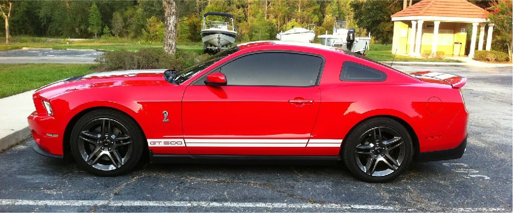

nickD Posted June 17, 2011 Report Share Posted June 17, 2011 I just installed the FRPP springs on my non-SVTPP 2011 The springs are part number M-5300-L which were listed as 07-11 springs. I am happy with the result and they dont ride that much harsher, but I really wish the nose was about 1/4" lower (you can tell these springs are made for the aluminum block). here are a couple shots: stock springs: frpp springs: Link to comment Share on other sites More sharing options...
