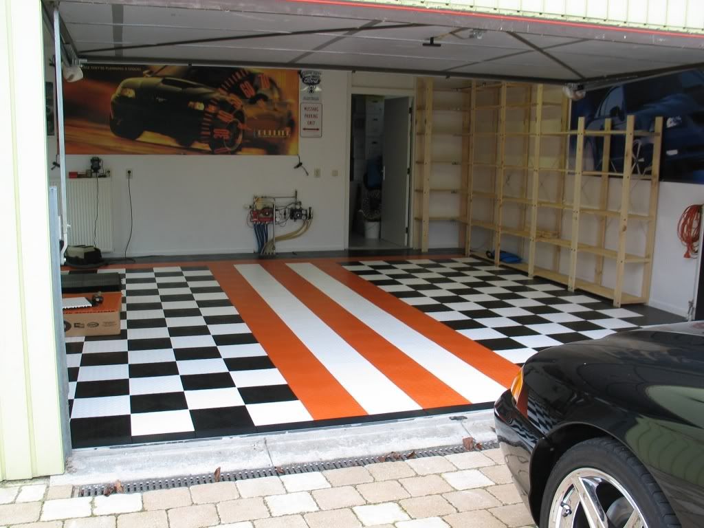

DutchGT500 Posted May 14, 2010 Report Share Posted May 14, 2010 With racedeck you can do the black with red stripes, like I did with orange and white. Link to comment Share on other sites More sharing options...
