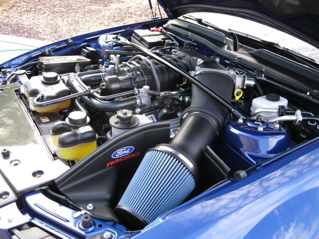

jetpilot Posted January 29, 2010 Report Share Posted January 29, 2010 Is the Ford Racing Cold Air Intake with tune package a safe performance upgrade for my GT500? Has anyone had any warranty issues with this modification or warranty claims denied? Any feedback will be appreciated. Link to comment Share on other sites More sharing options...
6-Speed Posted January 29, 2010 Report Share Posted January 29, 2010 The FR CAI is a good product that provides a conservative and safe calibration for the GT500. Whether you encounter any warranty issues depends on your dealer and how "mod" friendly they are, but technically they can deny warranty work if they can show the failure was caused by the aftermarket part, which is what Ford Racing parts are. However, you can easily return the stock air box and tune prior to having any warranty work done. I cannot tell a big difference in power after installing the CAI, but I seldom operate the car at WOT. You can definitely hear more of the SC whine when it kicks in. Link to comment Share on other sites More sharing options...

texaggie Posted January 31, 2010 Report Share Posted January 31, 2010 FRPP parts will not void any other warranty when installed at an authorized Ford shop. They will however only carry a one year warranty for the FRPP parts themselves. Denials are based on the shops decisions more than anything else, but Ford can be involved if you need them to. I have had to deal with both FMC and FRPP reps for different issues because the shop initially tried to charge me for things (One was a problem with the FRPP handling pack not being installed properly - different Ford shop- and twice on TSB issues. Every time the Ford reps and the FRPP reps helped me resove the issues and covered the warranty. In any case, the CAI is very mild in the landscape of mods to any car, and the FRPP CAI is the same as the KR so there will be no issues with warranty due to the parts being on the car. Link to comment Share on other sites More sharing options...

sherpa Posted February 1, 2010 Report Share Posted February 1, 2010 if you read the ford racing catalog, beginning pages, it states if you let a dealership do the install, it will include in the 3/36 warranty. not all ford racing parts qualify to retain the full 3/36 but this cold air does (i believe the short shift kit and the power pack falls under the 3/36. the tvs 605 only for 12month/12,000 miles). its such an easy install and most just do it at home but if u worry about the rules, or ur dealer is one of those thats stickler to the rules, go spent the $100 or so and let them install it. Link to comment Share on other sites More sharing options...

mullens Posted February 1, 2010 Report Share Posted February 1, 2010 From Ford Racing's warranty: "A 3 year / 36,000 mile warranty is applicable if installed at the time of new vehicle delivery" "A 12 month / 12,000 mile warranty is in effect if installed after the date of vehicle delivery but prior to expiration of 3 years / 36,000 mile vehicle warranty" Link to comment Share on other sites More sharing options...
