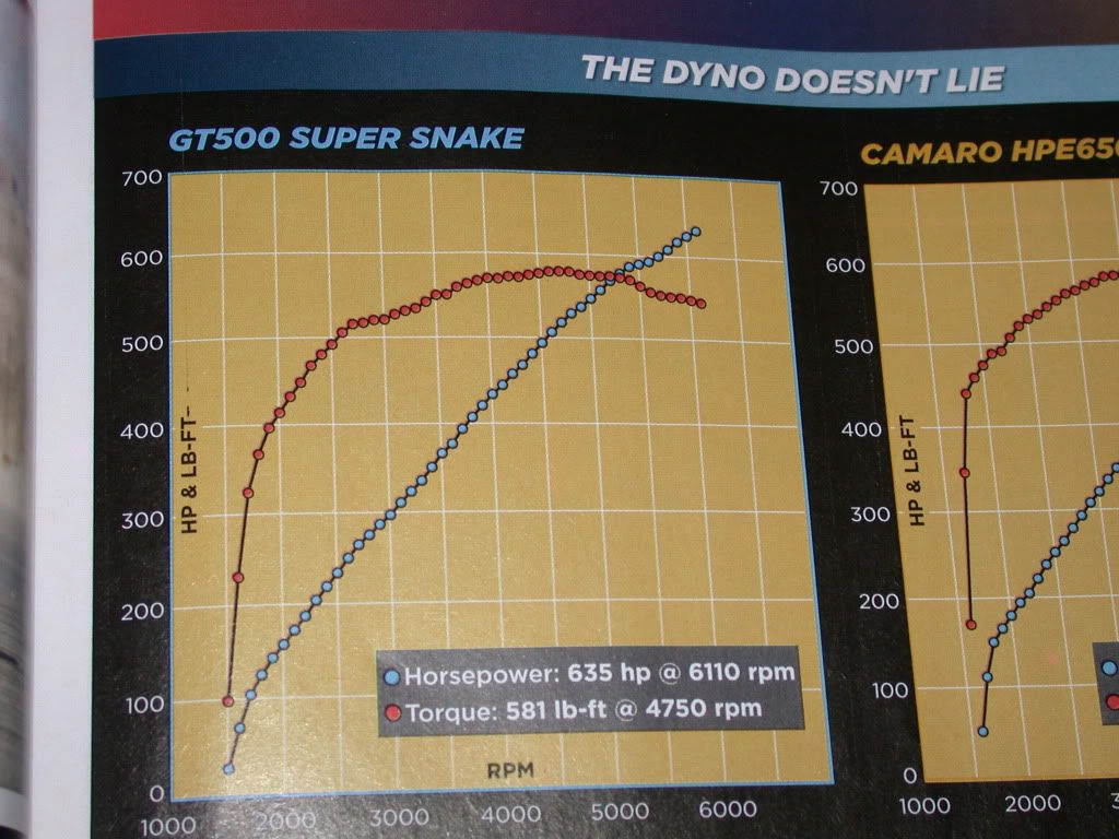

Robert M Posted November 26, 2009 Report Share Posted November 26, 2009 (edited) I think I can help with this. Source: http://www.shelbyautos.com/PDF/2010SSsm.pdf This is the Shelby Brochure for the Super Snake package. Note the first page in the "Options" list where it lists the 750HP version and the asterick next to it. At the bottom of both pages is the footnote: *700+ HP not available on convertables. Then if you go to the Ford Racing Parts site and note the Supercharger Performance Pack upgrades for the 2010 SVT models, they are now listed as: P/N: M-6066-MSVTA Desc: 2010 Mustang SVT 660 HP Supercharger Upgrade P/N: M-6066-MSVT29C Desc: 2010 Mustang SVT 750 HP Supercharger Upgrade So right out of the box the 2010 Super Snake will get a HP increase over past years. 660HP (2.3L TVS) and 750HP (2.9L Twin Screw FRPP/Whipple). Also note that they WILL NOT FIT 2007-2009 Mustang SVT. Hope that helps, Phill Pollard 2010 Kona Blue/White GT500 Another note on the 750 horse 2010 Super Snake............. Where did the additional 25 h.p. disappear in this 2010 chassis dyno? 2007-2009 (actually 2007/2008) 725 horse Super Snakes were pulling this same dyno h.p. number (634-638) back when people were first receiving their 725's and dynoing them. Either the 2010 is overrated, or the 2007-09's are underrated, unless there is something in the 2010 build that is sucking up those 25 extra ponies?? From what we know to be fact from the past chassis dyno's posted on this forum (at least three of them), and comparing them to this Motor Trend 2010 chassis dyno, the cars are exactly the same at the rear wheels. How can this be?? And this Motor Trend 2010 Super Snake did not have a KB as shown below, so I can only assume that the S/C on this car is the 750 h.p. you have listed above..........so again, where are the extra 25 ponies disappearing on the chassis dyno? Note that this 2010 also has the cooling upgrade package, something which was not on the 2007/2008 Super Snakes that have previously dyno'ed and showing the same RWHP numbers. This kit was not an option when they were dyno'ed. I like the look of that cooling system, that will be my next upgrade purchase from SAI. R Edited November 26, 2009 by Robert M Quote Link to comment Share on other sites More sharing options...

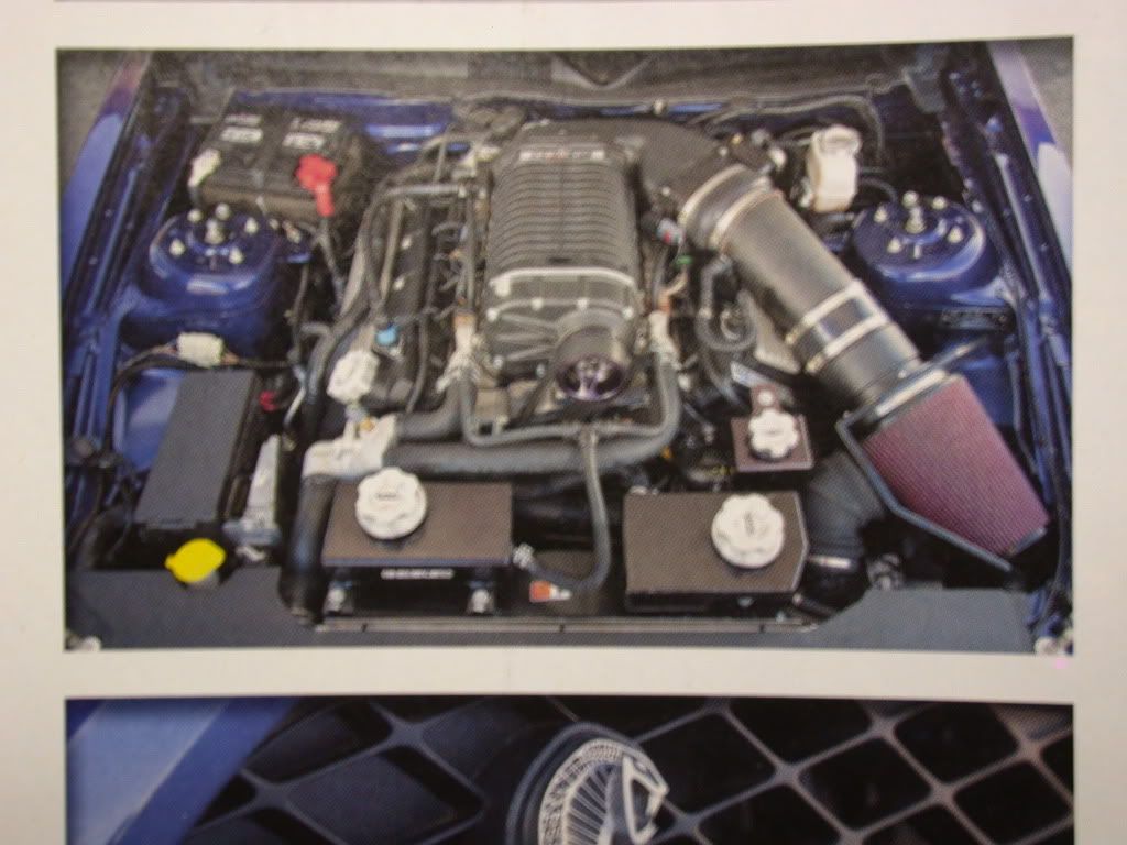

2010KonaBlueGT Posted December 13, 2009 Report Share Posted December 13, 2009 Another note on the 750 horse 2010 Super Snake............. SNIP! And this Motor Trend 2010 Super Snake did not have a KB as shown below, so I can only assume that the S/C on this car is the 750 h.p. Note: I assumed the SC on the SAI 2010 Super Snake concept car was the 2.9L FRP/Whipple version due to the large intake tube (vs. the 2.3L TVS w/FRP resonator elminator tube). In another thread I was told by rosssvt (Roger?) at SAI: "The supercharger shown in our concept vehicle is the Shelby/Ford Racing/Whipple 3.4 L unit." Just the facts, man, Phill Pollard Quote Link to comment Share on other sites More sharing options...
Robert M Posted December 13, 2009 Report Share Posted December 13, 2009 (edited) Note: I assumed the SC on the SAI 2010 Super Snake concept car was the 2.9L FRP/Whipple version due to the large intake tube (vs. the 2.3L TVS w/FRP resonator elminator tube). In another thread I was told by rosssvt (Roger?) at SAI: "The supercharger shown in our concept vehicle is the Shelby/Ford Racing/Whipple 3.4 L unit." Just the facts, man, Phill Pollard I read that other thread also, and that is why I asked (in that thread) if this was infact a 3.4? and not a 2.9? It seems hard to believe that the KB 2.8 puts out the same rear wheel h.p. and it requires a Whipple 3.4 for equal numbers, 634-638. Like you said, just the facts, and that is why I asked that question on the other thread....... R Edited December 13, 2009 by Robert M Quote Link to comment Share on other sites More sharing options...
2010KonaBlueGT Posted December 13, 2009 Report Share Posted December 13, 2009 I read that other thread also, and that is why I asked (in that thread) if this was indeed a 3.4? and not a 2.9? I don't know how to tell the difference between a 2.9L and a 3.4L. Anyone? Besides having to lower the engine.... Phill Pollard 2010 GT500 Quote Link to comment Share on other sites More sharing options...
Robert M Posted December 13, 2009 Report Share Posted December 13, 2009 (edited) I don't know how to tell the difference between a 2.9L and a 3.4L. Anyone? Besides having to lower the engine.... Phill Pollard 2010 GT500 I don't know the visual differences between the Whipples, but since the 3.4L is a "larger volume pump" than the 2.9L, I would guess that it is visually larger, larger rotors inside, larger housing outside, etc. R Edited December 13, 2009 by Robert M Quote Link to comment Share on other sites More sharing options...
2010KonaBlueGT Posted December 14, 2009 Report Share Posted December 14, 2009 I don't know the visual differences between the Whipples, but since the 3.4L is a "larger volume pump" than the 2.9L, I would guess that it is visually larger, larger rotors inside, larger housing outside, etc. R No, I mean can anyone tell by the photo if that's a 2.9L or a 3.4L? I *know* it's not a 2.3L by the intake system used on it. I'm wondering why they'd put a 3.4L on their 'concept vehicle'. Speculating, I'd say it may be a 'option' at some point. It makes me want to wait before I make a decision on Snaking my 2010. I'll see what I can find out when I visit SAI on the 18th. Closer to a decision, Phill Pollard Quote Link to comment Share on other sites More sharing options...
Robert M Posted December 14, 2009 Report Share Posted December 14, 2009 (edited) No, I mean can anyone tell by the photo if that's a 2.9L or a 3.4L? I *know* it's not a 2.3L by the intake system used on it. I'm wondering why they'd put a 3.4L on their 'concept vehicle'. Speculating, I'd say it may be a 'option' at some point. It makes me want to wait before I make a decision on Snaking my 2010. I'll see what I can find out when I visit SAI on the 18th. Closer to a decision, Phill Pollard Yes Phill, that is what I meant also. Can someone tell, by looking at the picture if it is a 2.9 or 3.4. If they are different in size, which I assume they are, someone familiar with Whipples may i.d. which blower we are looking at in this Motor Trend photo. R Edited December 14, 2009 by Robert M Quote Link to comment Share on other sites More sharing options...
BlackVert Posted December 15, 2009 Report Share Posted December 15, 2009 IMHO... The Whipple shown in the photos above looks like a 3.4. The 2.9's have the more efficient "Crusher-style" inlet... That picture shows the original-style inlet (non-Crusher) for the 3.4, and the overall size of the blower is more consistent with a 3.4. Quote Link to comment Share on other sites More sharing options...
