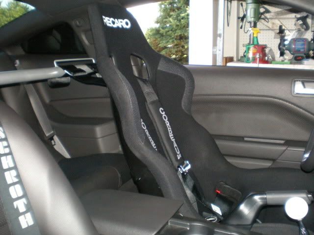

FordFan1 Posted October 14, 2009 Report Share Posted October 14, 2009 Here's a shot of my RECARO Profi XL I install for the summer months/track days... I have it mounted on a Corbeau seat mount/slider (05+ Mustang specific) so I can switch seats in about 10 mins just by removing/installing the 4 factory floor bolts- Snap the lap belts to the anchor hooks in the floor and the interior is all set for the track... http://www.recaro.com/index.php?id=3619®ion=3&L=2 =-=-=-=-=-=-=-= Link to comment Share on other sites More sharing options...

motorjock205 Posted October 14, 2009 Report Share Posted October 14, 2009 Here's a shot of my RECARO Profi XL I install for the summer months/track days... I have it mounted on a Corbeau seat mount/slider (05+ Mustang specific) so I can switch seats in about 10 mins just by removing/installing the 4 factory floor bolts- Snap the lap belts to the anchor hooks in the floor and the interior is all set for the track... http://www.recaro.com/index.php?id=3619®ion=3&L=2 =-=-=-=-=-=-=-= Hey Kerry, I noticed you have a harness bar in there behind the seats...how about some particulars on that bad boy??? Manufacturer, Part Number, Price??? Thanks, Carl Link to comment Share on other sites More sharing options...
FordFan1 Posted October 15, 2009 Report Share Posted October 15, 2009 Hey Kerry, I noticed you have a harness bar in there behind the seats...how about some particulars on that bad boy??? Manufacturer, Part Number, Price??? Thanks, Carl Carl, Corbeau harness bar / Stage 3 Motorsports / $299 free shipping The best part is that it installs in existing safety belt mounting holes. I also got a deal on the Corbeau 5-point harness by purchasing it at the same time... http://www.corbeau.com/products/harness_ba...ng_harness_bar/ <a href="http://www.stage3motorsports.com/c=lkkyr2R...100mustang2005/" target="_blank">http://www.stage3motorsports.com/c=lkkyr2R...100mustang2005/</a> http://www.racing-seats-usa.com/hb9504m.html Link to comment Share on other sites More sharing options...
motorjock205 Posted October 15, 2009 Report Share Posted October 15, 2009 Carl,Corbeau harness bar / Stage 3 Motorsports / $299 free shipping The best part is that it installs in existing safety belt mounting holes. I also got a deal on the Corbeau 5-point harness by purchasing it at the same time... http://www.corbeau.com/products/harness_ba...ng_harness_bar/ <a href="http://www.stage3motorsports.com/c=lkkyr2R...100mustang2005/" target="_blank">http://www.stage3motorsports.com/c=lkkyr2R...100mustang2005/</a> http://www.racing-seats-usa.com/hb9504m.html Thanks Kerry, I wasn't aware that the Harness Bar would fit the 05-08 Mustang now...Are there any issues with the Plastic Brackets on the 08 that pull the front belts forward to make it easier to get to them? I don't know what they are called, but they rotate down when you try to get in the back and pull back up to hold the seatbelt forward... Carl Link to comment Share on other sites More sharing options...

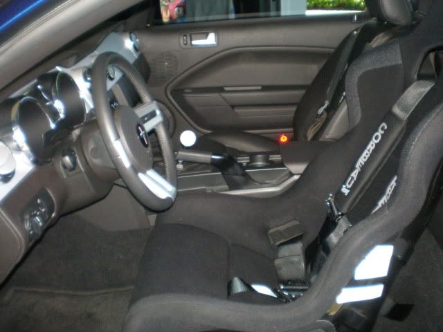

tispco Posted October 15, 2009 Report Share Posted October 15, 2009 This GT500 was at the 85th Birthday Bash. I don't remember who's Shelby it was, but I thought the interior looked great and took a couple pics. Link to comment Share on other sites More sharing options...
FordFan1 Posted October 15, 2009 Report Share Posted October 15, 2009 Thanks Kerry, I wasn't aware that the Harness Bar would fit the 05-08 Mustang now...Are there any issues with thePlastic Brackets on the 08 that pull the front belts forward to make it easier to get to them? I don't know what they are called, but they rotate down when you try to get in the back and pull back up to hold the seatbelt forward... Carl Just a little issue with the ratchet device inside, there is a possibility that the ratcheting mechanism can come a part when you remove them. If this happens, be sure to pay close attention to the way it comes a part, so you can reassembly the device when your ready to mount the bar. If you’re careful you can keep it together without this happening, I had 1 come a part on me mostly because I didn't have enough hands and dropped the assembly during the reassembly process. Also there is a metal spacer/sleeve that is used when mounting the bar that goes on the bolts between the plastic and body of the car, if you’re not careful one of these could easily be dropped between the interior panel and cost you time fishing around for it with a magnet (I had no issue here but I can see were this could happen). I did my install all by myself, but an extra set of hands to hold the bar will attaching it would have been very helpful.. Other then that it was pretty straight forward Link to comment Share on other sites More sharing options...
motorjock205 Posted October 15, 2009 Report Share Posted October 15, 2009 Just a little issue with the ratchet device inside, there is a possibility that the ratcheting mechanism can come a part when you remove them. If this happens, be sure to pay close attention to the way it comes a part, so you can reassembly the device when your ready to mount the bar. If you’re careful you can keep it together without this happening, I had 1 come a part on me mostly because I didn't have enough hands and dropped the assembly during the reassembly process. Also there is a metal spacer/sleeve that is used when mounting the bar that goes on the bolts between the plastic and body of the car, if you’re not careful one of these could easily be dropped between the interior panel and cost you time fishing around for it with a magnet (I had no issue here but I can see were this could happen). I did my all by myself, but an extra set of hands to hold the bar will attaching it would have been very helpful.. Other then that it was pretty straight forward Thanks much for the info Kerry...very much appreciated! BTW, very nice cars...both of them...best of both worlds...I think my wife secretly wants a Mustang of her own too...LOL Link to comment Share on other sites More sharing options...
