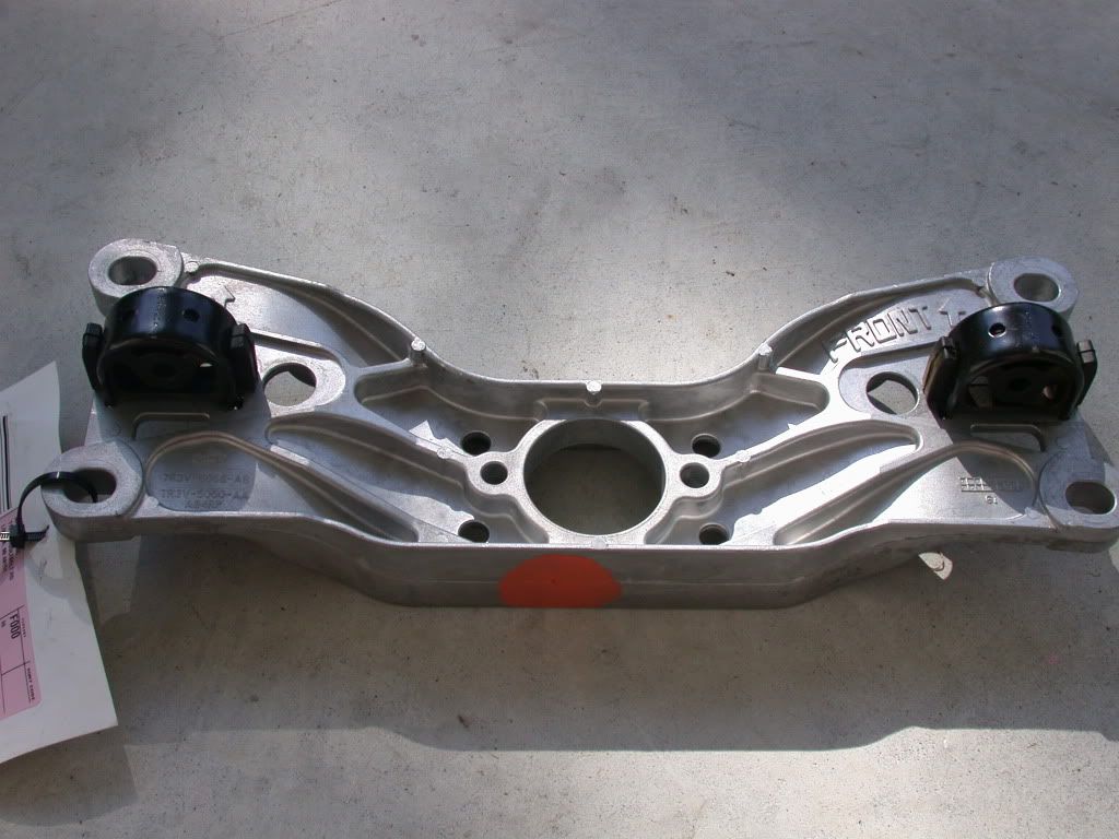

Robert M Posted October 1, 2009 Report Share Posted October 1, 2009 Robert, how do you like the new exhaust? I have been looking at that same system for my car. Any info and a review would be very helpful. Mark The sound is raspy. I need to bring the car to a exhaust shop and have the pipes re-positioned, currently they rattle under the car. The did not rattle at first, but after the system has been heated and cooled a few times, the pipes need some adjusting. I have also purchased the 2007 GT500 trans x-member for installation at the same time. Unlike the 2008-up trans. x-member, the 2007 had mid-points for exhaust hangers.<<This may help for supporting the larger 3" system. R Link to comment Share on other sites More sharing options...

Robert M Posted October 3, 2009 Report Share Posted October 3, 2009 The quality/style of clamps used make all the difference in the world in the pipes staying put! I have JBA 1 3/4" long tubes with their catted 3" x-pipe and full 3" exhaust thereafter. Here is a link to the clamp I ended up using to connect the x-pipe to mid pipe as the original clamps provided did not secure these pipes after the exhaust was removed several times for clutch/tranny work. http://www.verociousmotorsports.com/Shop-b...int-Connections All exhaust connections after the mid pipe were tack welded as well as clamped. I wanted to avoid any loose connections down the road. All is well now! BTW, the original clamps for the x pipe to mid pipe were slip joint clamps, not butt joint clamps. That's why they didn't hold the pipes secure after they were loosened and tightened several times!! Yes, that is what clamps my 3" JBA together. I see you have an 08? Have you added the 07 trans. x-member with the mid-point exhaust hangers? This is the 2008/09 GT500 x-member with no exhaust support. It is like the x-member that is currently on my 2008 Super Snake........ http://cgi.ebay.com/ebaymotors/ws/eBayISAP...RK%3AMEWAX%3AIT This is the 2007 GT500 x-member with center/mid-pipe support............ My JBA 3" has hanger brackets welded to the mid-pipes for support in this center area, my 08 GT500 has no hanger provision. If the JBA was engineered to have support in this mid area, and I do not have it attached to hangers, it "could" come apart since without mid support it is hanging on the headers or manifolds, and then all the way at the rear of the car. I decided to buy a 07 GT500 x-member for the added mid-point support. And no, Ford does not list the two 07 GT500 exhaust hangers seperately so they could be added to an 08/09 x-member. It requires the purchased of the complete 07 x-member assy., but it is under $100. R Link to comment Share on other sites More sharing options...
08 ORANGE SS-725HP Posted October 3, 2009 Report Share Posted October 3, 2009 Robert: With the long tubes, the X-pipe is held tightly without having to use the '07 trans cross member support bracket hangers. I have a BMR front driveshaft loop which bolts to my '08 cross member with no problems. I believe the slight design difference of the '07 will not allow this loop to be used, from other posts I have seen regarding this. But then again I could purchase the '07 bracket and then install the hangers on my '08 for that additional support but I feel this is not necessary with the set up I have. All for your info. Link to comment Share on other sites More sharing options...
Robert M Posted October 3, 2009 Report Share Posted October 3, 2009 Robert: With the long tubes, the X-pipe is held tightly without having to use the '07 trans cross member support bracket hangers. I have a BMR front driveshaft loop which bolts to my '08 cross member with no problems. I believe the slight design difference of the '07 will not allow this loop to be used, from other posts I have seen regarding this. But then again I could purchase the '07 bracket and then install the hangers on my '08 for that additional support but I feel this is not necessary with the set up I have. All for your info. I agree that with the support of long tubes, the installation is completely different than me with shorty's. R Link to comment Share on other sites More sharing options...
Robert M Posted October 3, 2009 Report Share Posted October 3, 2009 Robert: With the long tubes, the X-pipe is held tightly without having to use the '07 trans cross member support bracket hangers. I have a BMR front driveshaft loop which bolts to my '08 cross member with no problems. I believe the slight design difference of the '07 will not allow this loop to be used, from other posts I have seen regarding this. But then again I could purchase the '07 bracket and then install the hangers on my '08 for that additional support but I feel this is not necessary with the set up I have. All for your info. Ron - I just re-read your post that included this link: http://www.verociousmotorsports.com/Shop-b...int-Connections . Those sleeve type "butt clamps" are what came with my JBA 3" when I bought it from SSP. Yours came with a different clamp set-up? R Link to comment Share on other sites More sharing options...
