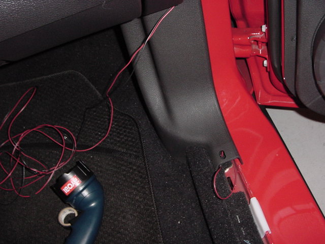

OCD Posted August 22, 2009 Report Share Posted August 22, 2009 I found a set of these locally for a great deal, so I got em'... Fairly easy install... The only thing I was not all that comfortable taking off the passenger windshield pillar trim to get at the harness but I took my time and got it off then back on without breaking any taps... Although as I was putting it back together one of the clips came off the pillar trim and fell down the side off the dash... So off comes the glovebox and kick trim panel!!! I found the clip though!! Green/Yellow and Black/Blue are the wires to tap into... You can strip some of the shield off and wrap, solder and tape but then you can't use your heatshrink gun... Pffft... If you do it this way you will have to extend the wires so the harness is all uniform length... Of course I realized this AFTER I cut the wires... One of those. oh yeah moments... Double heat shrinked!! Better than new!! One wire comes out the passenger kick panel and you run the other one under the dash to the drivers side kick panel... In, with only one clip mishap!! The test, :holdsbreath: :happy feet: Quote Link to comment Share on other sites More sharing options...
mrfarmdog Posted August 22, 2009 Report Share Posted August 22, 2009 Now that is nice! Does it change colors with your dash or mycolor? Quote Link to comment Share on other sites More sharing options...
OCD Posted August 22, 2009 Author Report Share Posted August 22, 2009 Just red.. The led's in the harness are clear, the red comes from fiber optics in the sill I was told... It matches great on a red car!! Quote Link to comment Share on other sites More sharing options...
