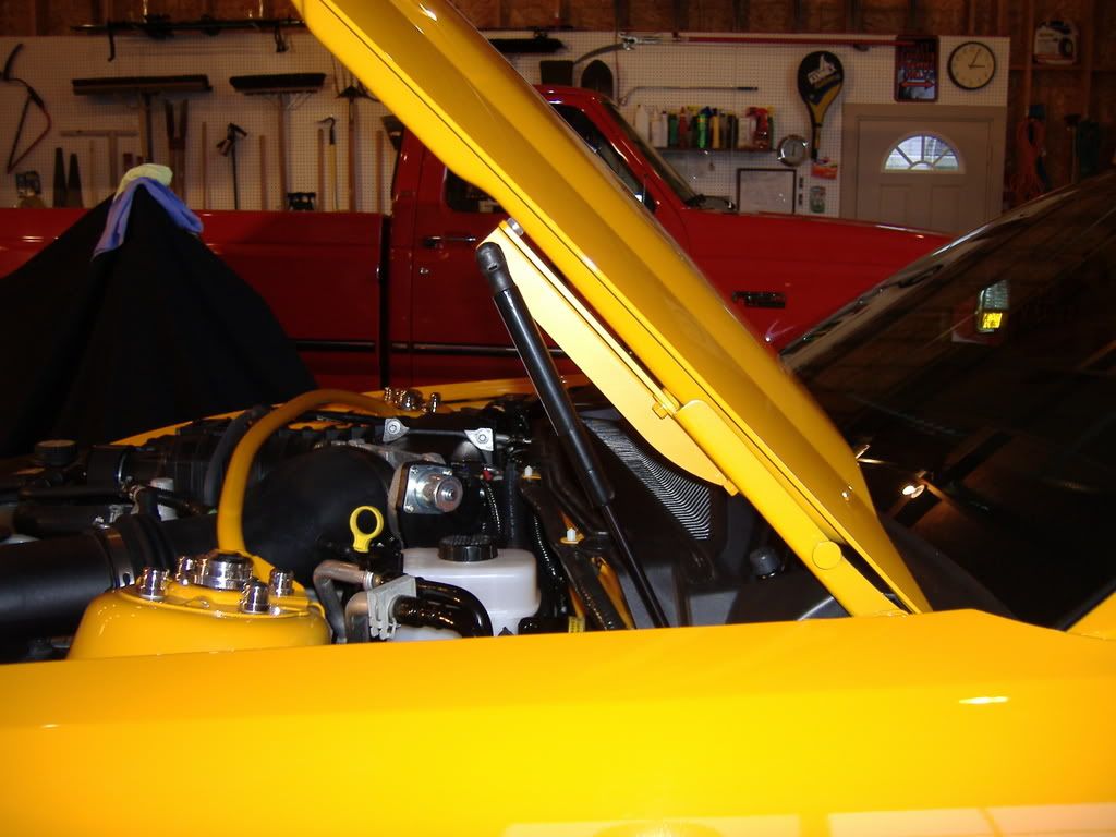

johnrehder Posted September 27, 2008 Report Share Posted September 27, 2008 Hey folks, I just installed the hood strut kit on my 2008 Shelby Gt. No instructions were included but I think I have them installed correctly. The only problem is that they do not hold the hood up. Is there an adjustment on the cylinder? Could someone post a photo of thier install just to be sure I have it right? Thanks all! John Link to comment Share on other sites More sharing options...

Grabber Posted September 27, 2008 Report Share Posted September 27, 2008 Here's some pic's of both cars with some instructions to. These are the Steeda ones. Link to comment Share on other sites More sharing options...

johnrehder Posted September 27, 2008 Author Report Share Posted September 27, 2008 I think I have cyclinder down, Guess I'll reverse it and see if it makes a difference. Thanks John, the August issue of Mustang Monthly had a good article with photos and step by step instuctions for installing the lift kit. Is the cylinder up and the shaft down on your installation? Link to comment Share on other sites More sharing options...
johnrehder Posted September 27, 2008 Author Report Share Posted September 27, 2008 I just reversed the cylinders and it made no difference. Hood still falls slowly back down. I think I have cyclinder down, Guess I'll reverse it and see if it makes a difference.Thanks Link to comment Share on other sites More sharing options...
Grabber Posted September 27, 2008 Report Share Posted September 27, 2008 I just reversed the cylinders and it made no difference. Hood still falls slowly back down.The cylinders are bad. Send them back. Link to comment Share on other sites More sharing options...

6-Speed Posted September 27, 2008 Report Share Posted September 27, 2008 The cylinders are bad. Send them back. +1; one or more struts are bad if they cannot hold up a stock hood. Call the vendor and get a replacement kit; you should not have to purchase another brand of struts, plus your struts have a chromed or stainless finish. Link to comment Share on other sites More sharing options...

johnrehder Posted September 27, 2008 Author Report Share Posted September 27, 2008 Thanks guys, I sent an email to Shelby parts. I would rather have replacements first. +1; one or more struts are bad if they cannot hold up a stock hood. Call the vendor and get a replacement kit; you should not have to purchase another brand of struts, plus your struts have a chromed or stainless finish. Link to comment Share on other sites More sharing options...

RmGardner Posted September 29, 2008 Report Share Posted September 29, 2008 I just recieved my Hood Strut kid Friday last week after being on B.O for 2 mo. Had to call to get instrustions. They emailed them to me. The article in Muistang Monthly said to mount with shaft down. Shelby shows shaft up. Struts are set up to work in different ways. Link to comment Share on other sites More sharing options...

johnrehder Posted October 2, 2008 Author Report Share Posted October 2, 2008 :happy feet: Steve at Shelby parts is sending me replacement cylinders. He was very nice and accomidating. Hopefully the replacements will work so I can ditch the hood prop rod. Hey folks,I just installed the hood strut kit on my 2008 Shelby Gt. No instructions were included but I think I have them installed correctly. The only problem is that they do not hold the hood up. Is there an adjustment on the cylinder? Could someone post a photo of thier install just to be sure I have it right? Thanks all! John Link to comment Share on other sites More sharing options...

RmGardner Posted October 24, 2008 Report Share Posted October 24, 2008 I too have the Shelby struts and the fall. Think the temp has something to do with it. Warm weather they fall. Call Shelby and they said earlier ones had a proble. Mine are the later ones because I have chrome heads on them. They said they would send me a new pair though. Am going to install them this weekend. Will post later Link to comment Share on other sites More sharing options...

chigl Posted November 1, 2008 Report Share Posted November 1, 2008 Well...I installed my Kiser replacement struts today, and I got a hood in my face again! Yeah...In my face! Seems this strut upgrade is more than it promised to be. One strut will hold the hood open, two struts will open it for you, once the secondary hood release is activated. Step back, or, get a hood in your face, somewhere around your chin. BTW, these struts fit perfectly, and length can be adjusted if necessary. The cylinders are painted black, but I suspect they can be polished up to look even better than the SPP/Scott Drake brushed aluminum appearance. As I suggested ^ there, IMHO, the SPP/Scott Drake struts are not defective, but merely inefficient in keeping the heavier SGT hood open. I have had the SGT scoop in my hands, and it does add additional weight (maybe 20 pounds?) to the hood, and in exactly the wrong place, the fulcrum of the "see-saw". No wonder it won't stay open? Y'all with complaints of the SPP/Scott Drake kit not performing well are correct. But, I don't think it's defective parts. Rather, underpowered struts for the task. Should SPP/Scott Drake send you a replacement kit and it's not an improved version, you will still have problems. I think my 30 bucks was well spent, just remember to stand back? Hi Lulu - Could you post pics of the struts you installed? Did the struts come with brackets and good installation instructions? Thanks! Link to comment Share on other sites More sharing options...
johnrehder Posted November 2, 2008 Author Report Share Posted November 2, 2008 Update, I did receive replacements and they hold the hood up fine. No more issues. Hood prop gone now. :happy feet: :happy feet: Steve at Shelby parts is sending me replacement cylinders. He was very nice and accomidating. Hopefully the replacements will work so I can ditch the hood prop rod. Link to comment Share on other sites More sharing options...
