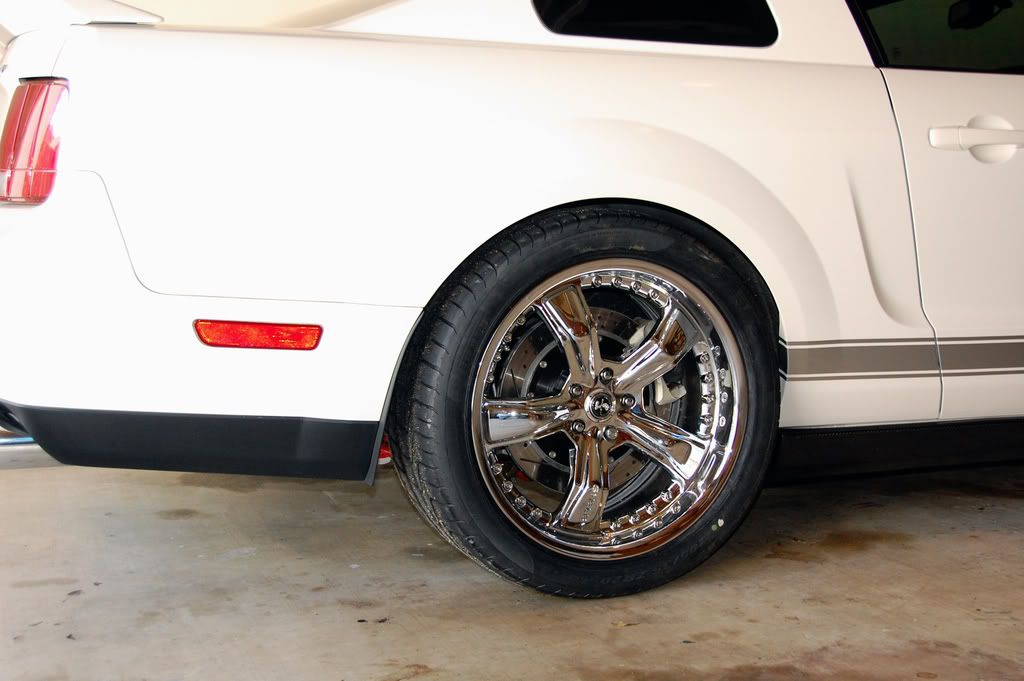

cobrafan Posted June 25, 2008 Report Share Posted June 25, 2008 See if any of these work. These were taken before the suspension was raised about a quarter of an inch and the wheels centered with the adjustable pan hard par. It needed about 1/8 to the right. Those are not rub marks on the first photo. It only rubbed when pushed hard at the track and then only slightly, thus the 1/4 adjustment up. I did have to remove the rear break ducts, but we are working on a modification to make them work. Link to comment Share on other sites More sharing options...
GT500FLYBOY Posted June 25, 2008 Report Share Posted June 25, 2008 These were taken before the suspension was raised about a quarter of an inch and the wheels centered with the adjustable pan hard par. It needed about 1/8 to the right. Those are not rub marks on the first photo. It only rubbed when pushed hard at the track and then only slightly, thus the 1/4 adjustment up. I did have to remove the rear break ducts, but we are working on a modification to make them work. CF - did you widen to 10.5 or 11"? I just ordered another set. I figure I wouldn't need to go wider than 305s - so 10.5 should be fine. I imagine the brake ducts would be out for good with 315s anyway. Link to comment Share on other sites More sharing options...
cobrafan Posted June 25, 2008 Report Share Posted June 25, 2008 I went with 10.5. Mike Stacy went with 11.0 and there seems to be plenty of room. We both needed just about the same tweek and we are both running 305's. Link to comment Share on other sites More sharing options...

GT500FLYBOY Posted June 25, 2008 Report Share Posted June 25, 2008 This is a pictue taken on the track at Hallett at Mid America. It shows a pretty good perspective between the fronts and rears. That does look damn fine, btw. Any pics from the rear at a similar distance and angle? Link to comment Share on other sites More sharing options...
500forme Posted June 25, 2008 Author Report Share Posted June 25, 2008 I went with 10.5. Mike Stacy went with 11.0 and there seems to be plenty of room. We both needed just about the same tweek and we are both running 305's. Excellent photo's, just what I was looking for, you rock Cobrafan! Thanks so much for taking the time to help on this subject. It helped me tremedously with me deciding what wheel and tire combination I will go with. Link to comment Share on other sites More sharing options...
cobrafan Posted June 25, 2008 Report Share Posted June 25, 2008 That does look damn fine, btw. Any pics from the rear at a similar distance and angle? This is the closest that I have. For some reason, my wife didn't get very many pictures of my rear end. Link to comment Share on other sites More sharing options...
cobrafan Posted June 25, 2008 Report Share Posted June 25, 2008 Excellent photo's, just what I was looking for, you rock Cobrafan! Thanks so much for taking the time to help on this subject. It helped me tremedously with me deciding what wheel and tire combination I will go with. 500fm, You're welcome, but I'm just passing along what I've picked up from this site. This really is an awesome forum with some great folks. I also appreciate the fact that we can interact with the people at SAI. Link to comment Share on other sites More sharing options...
