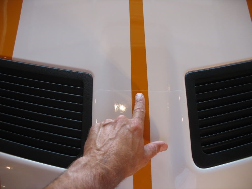

Grabber Posted June 13, 2008 Report Share Posted June 13, 2008 I assume your problem is happening at the top on your hood? My bra is venture shield. My installer made a cut at each stripe about 2 inches long at the leading edge where the bra meets the paint. (where my finger is in the pic's) This allows the sbra to be tight at the leading edge to keep the dirt out of it. Link to comment Share on other sites More sharing options...

Grabber Posted June 13, 2008 Report Share Posted June 13, 2008 What about the rest of the film? I have an air gap that runs down the whole length of the stripes on the hood and bumper, which fortunately is not very noticable on the Vapor/black combo unless you look closely. The worst part right now is the dirt trapped underneath on the leading edges, but I would think that a good installer would know that this would happen and have a fix for it. I took the car in this morning, and they are trying to work out a solution, so hopefully it will get fixed. Joe, There is no way around that issue of the slight air gap running the length of the stripe if you want the bra in 1 piece. The material has to bridge the stripes and the stripes are thick so the bra wont lay down all the way at the stripe to paint transition. I have the same thing on my car. The way to prevent dirt at the leading edge is for the installer to cut a slit for the first 2 inches at the stripe location. This way it lays down and will not let dirt in. In order to fix yours he may be able to score the bra the entire width of the car to get rid of the dirt , and then make the 2 inch slits. Link to comment Share on other sites More sharing options...
Grabber Posted June 13, 2008 Report Share Posted June 13, 2008 Joe, Click on this photo and you will see the slight air gap at the stripe to paint location and the point of where it ends and the slit begins. Link to comment Share on other sites More sharing options...

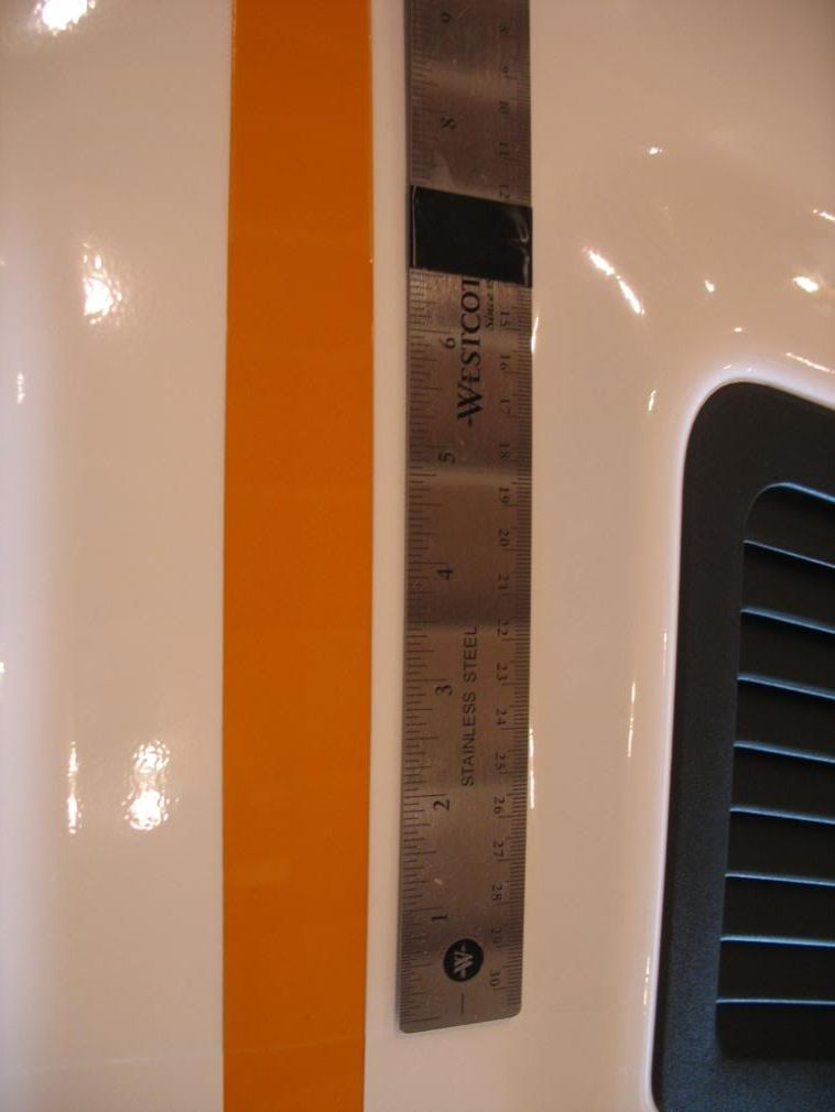

Grabber Posted June 18, 2008 Report Share Posted June 18, 2008 Grabber, is there any way to get a closeup of the spot where they cut it back? I couldn't really see it on the pictures you posted. I took some more pic's for you of the cut that you are inquiring about. It turns out that the cut is 6-1/2 inches long. I put a piece of black tape on the ruler at the end of cut / 6-1/2 inch mark. The top of the ruler is the end of the bra. Link to comment Share on other sites More sharing options...
