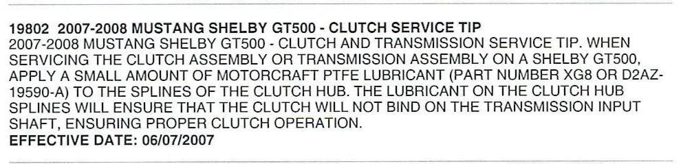

Grabber Posted May 30, 2008 Report Share Posted May 30, 2008 Do you know what the cutoff date is? On 6/7/07 they started installing the Teflon lube to the inputshafts and clutch hub's. All prior cars went together dry as a bone, and then rusted. Click on these to see my dry rusty clutch and tranny input shaft. Link to comment Share on other sites More sharing options...

Grabber Posted May 30, 2008 Report Share Posted May 30, 2008 The TSB is not out as of today. Link to comment Share on other sites More sharing options...
07-SHLB Posted May 30, 2008 Report Share Posted May 30, 2008 DING! DING! DING! You're a winner!!! How can he be a winner if they began to correct the issue on 06-07-07? Link to comment Share on other sites More sharing options...
KCMO-GT500 Posted May 30, 2008 Report Share Posted May 30, 2008 because they only started putting in a modified tranny in early nov or so. Link to comment Share on other sites More sharing options...
Son of GT Posted May 30, 2008 Report Share Posted May 30, 2008 How can he be a winner if they began to correct the issue on 06-07-07? Because the issue goes beyond the June 2007 date. The 06-07-07 correction was/is a band-aid for the problem. Fundamentally, the components are inadquate to handle the H.P. and torque that the engine generates, and they begin to fail regardless of the build date. I have three friends here in Los Angeles that have cars assembled after June of 07, and they have had their drivetrains replaced due to failures. I have also had pointed conversations with Tremec engineers about this issue, and they all confirmed to me that from very early on, FoMoCo was flat out told by Tremec that the specified clutch and transmission components would not be able to handle the engine, but FoMoCo told Tremec to just ship the components as specified. As I posted here in another forum, all GT500 owners should be critical of how their clutches and transmissions perform as they approach the 12,000 mile warranty cutoff. Even though Ford is doing the right thing by honoring warranty replacements beyond that mileage cutoff, getting any problem identified and resolved before the mileage cutoff just makes the warranty process a slam dunk without any pushback at the dealer level which is where 99% of people are getting pushback from. Let me put it this way...I took my car into one dealer who advised me that FoMoCo told them that my car's clutch and transmission failure was my problem. So I took my car into another dealer who did not question the failure, took the car in and repaired it under warranty, and I found out later that the first dealer NEVER contacted FoMoCo and they were just trying to make me pay for the repairs in order to avoid another warranty claim and to garner a higher profit because warranty claims don't pay as much as retail does. As odd as it may sound to some, keeping your car a garage queen could end up costing you more in the long run. These cars need to be taken out and driven even if it just to shake the bugs out of them. If a owner chooses to keep the car's mileage low for future resale value, it might be the new owner that will have to spring for a new drivetrain when they start to put mileage on the car. Link to comment Share on other sites More sharing options...

KCMO-GT500 Posted May 30, 2008 Report Share Posted May 30, 2008 Because the issue goes beyond the June 2007 date. The 06-07-07 correction was/is a band-aid for the problem. Fundamentally, the components are inadquate to handle the H.P. and torque that the engine generates, and they begin to fail regardless of the build date. I have three friends here in Los Angeles that have cars assembled after June of 07, and they have had their drivetrains replaced due to failures. I have also had pointed conversations with Tremec engineers about this issue, and they all confirmed to me that from very early on, FoMoCo was flat out told by Tremec that the specified clutch and transmission components would not be able to handle the engine, but FoMoCo told Tremec to just ship the components as specified. As I posted here in another forum, all GT500 owners should be critical of how their clutches and transmissions perform as they approach the 12,000 mile warranty cutoff. Even though Ford is doing the right thing by honoring warranty replacements beyond that mileage cutoff, getting any problem identified and resolved before the mileage cutoff just makes the warranty process a slam dunk without any pushback at the dealer level which is where 99% of people are getting pushback from. Let me put it this way...I took my car into one dealer who advised me that FoMoCo told them that my car's clutch and transmission failure was my problem. So I took my car into another dealer who did not question the failure, took the car in and repaired it under warranty, and I found out later that the first dealer NEVER contacted FoMoCo and they were just trying to make me pay for the repairs in order to avoid another warranty claim and to garner a higher profit because warranty claims don't pay as much as retail does. As odd as it may sound to some, keeping your car a garage queen could end up costing you more in the long run. These cars need to be taken out and driven even if it just to shake the bugs out of them. If a owner chooses to keep the car's mileage low for future resale value, it might be the new owner that will have to spring for a new drivetrain when they start to put mileage on the car. I've got a new clutch and the new style tranny in mine now, and it shifts like a dream. But I tell you, if any more issues pop up, I think I will just get away from the ford oem and put in some parts that I know will hold up well. I think it would be cheaper and less frustrating in the long run. john Link to comment Share on other sites More sharing options...
