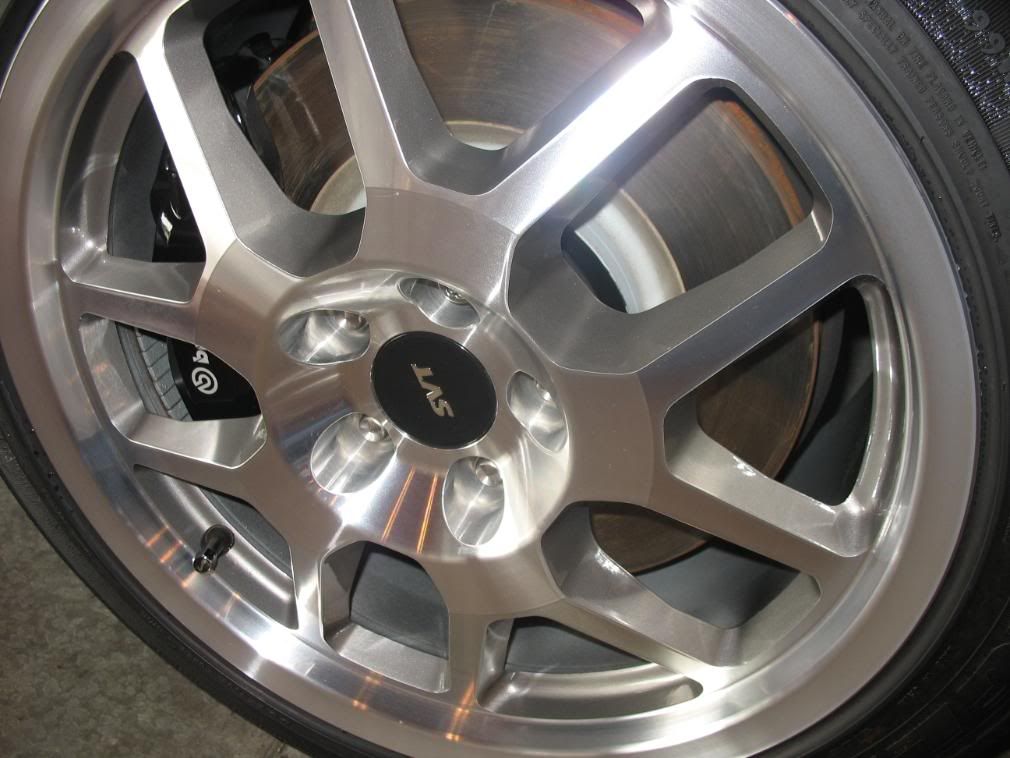

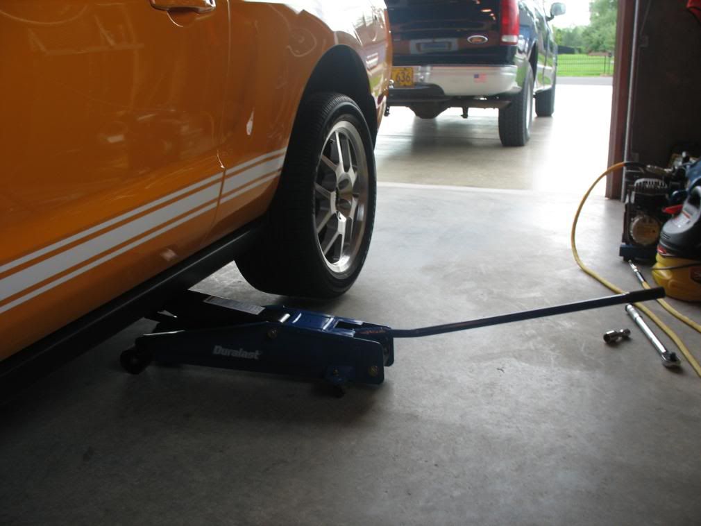

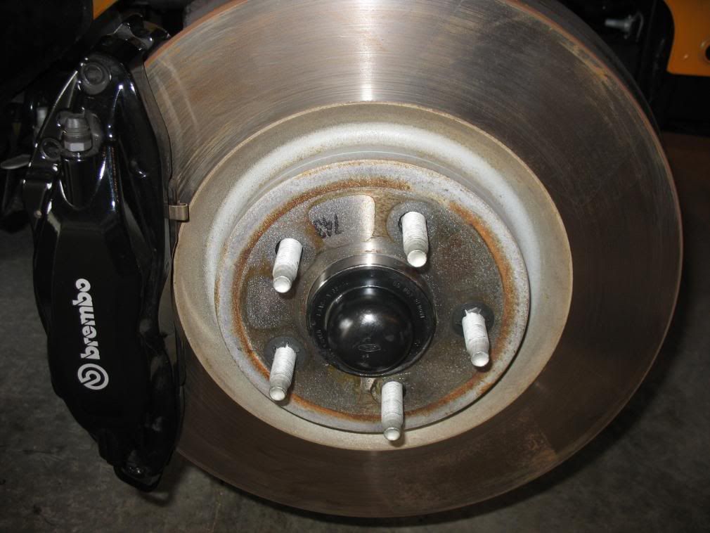

Grabber Posted May 28, 2008 Report Share Posted May 28, 2008 My front rims have a slight ring of rust around the rotor housing right where the rim makes contact. I don't like the look, so today I did some detailing. This job took about 2 hours. My floor jack would not fit under the front of the car, so I used my pallet jack with some wood blocks. It worked great (Rated for 5000 Pounds). This is the rust that I am talking about. Link to comment Share on other sites More sharing options...

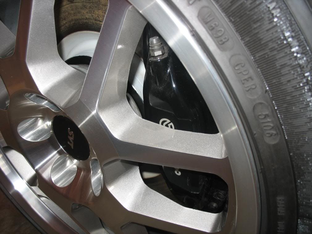

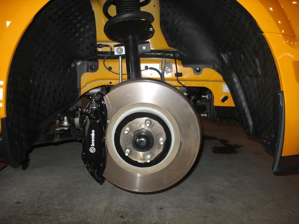

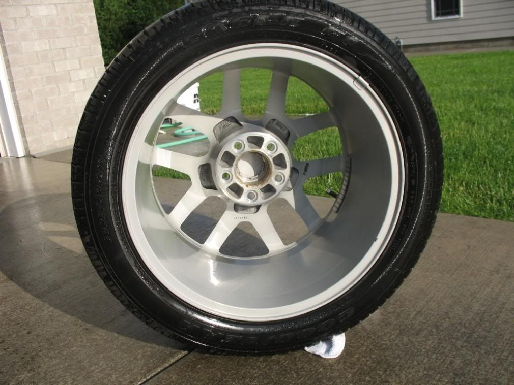

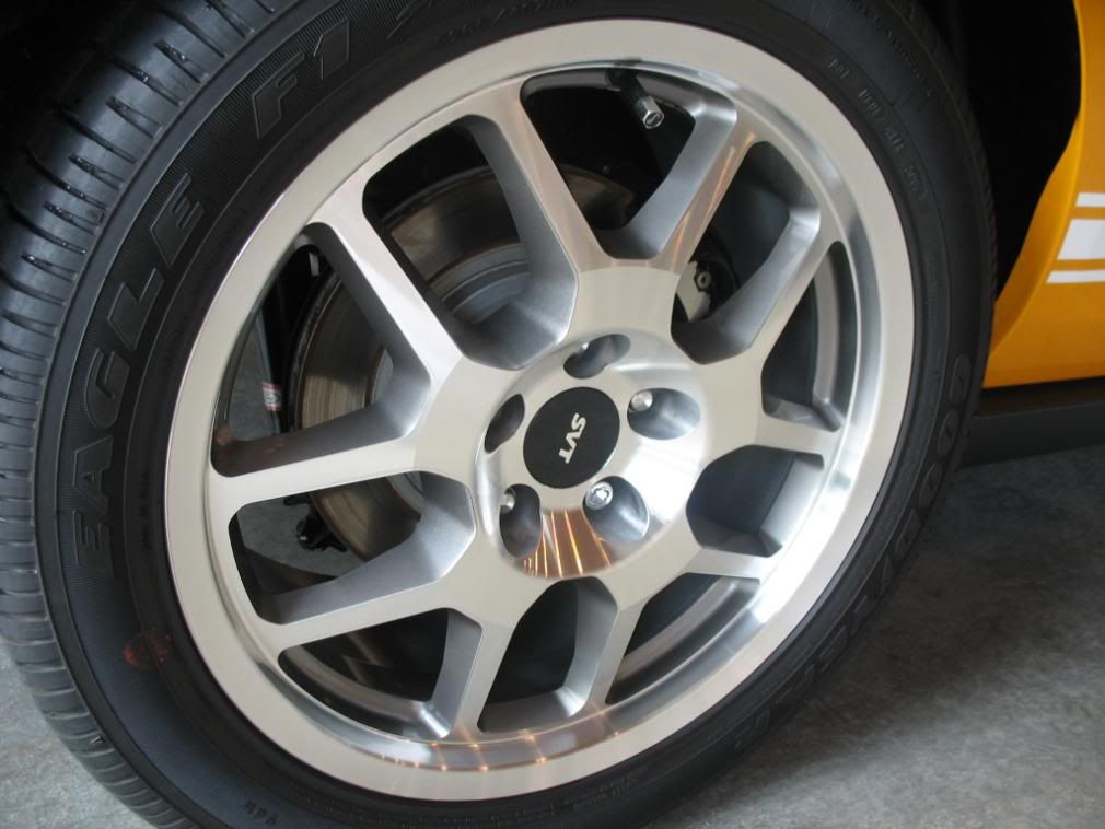

Grabber Posted May 28, 2008 Author Report Share Posted May 28, 2008 So I took the tires off, and cleaned the entire inside of the wheel well and then used a scuff pad on the surface rust on the rotor housing. After removing the surface rust, I applied some black brake caliper paint to the rusted area. I simply cut it in with a small art brush (2 coats). It cleaned that ring up nicely. I cleaned the inside of the rims while I had the tires off. I then put the front tires back on. 100 Pounds of Torque is required. I am happy with the detailed clean look, with no RUST. Link to comment Share on other sites More sharing options...

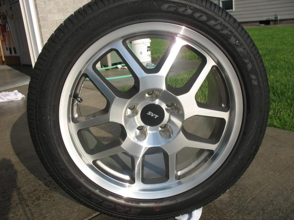

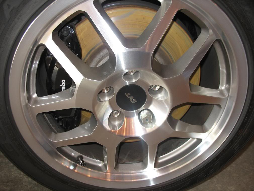

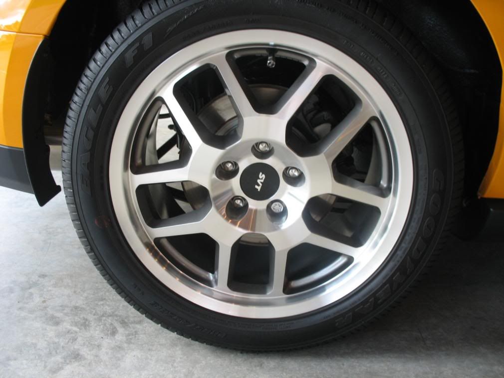

Grabber Posted May 28, 2008 Author Report Share Posted May 28, 2008 It was then time to do the rear rims. There was no RUST ring to prep and paint so it went faster. My floor jack worked too. Of course I cleaned up the inside of the wheel well so you could eat off of it. Then all I had to do was put the rear tires back on. I detailed the rest of the car yesterday, so now with the rims completed, I am done....untill the brake dust builds up again. Here's the finished look. Link to comment Share on other sites More sharing options...

ingram4868 Posted May 28, 2008 Report Share Posted May 28, 2008 Did you apply wax or ice to the inside of the rims? It does help when cleaning the loose dust off with a hose. Your pics also show the installation clips on the rotors that cause people with aftermarket rims such difficulty. It's the first time I've seen them. Does the pallet jack seem to be a better device than the floor jack? Link to comment Share on other sites More sharing options...
Grabber Posted May 28, 2008 Author Report Share Posted May 28, 2008 That surface rust on the rotors appeared over night because I washed the car with water. It goes away as soon as I put on the brakes. Link to comment Share on other sites More sharing options...

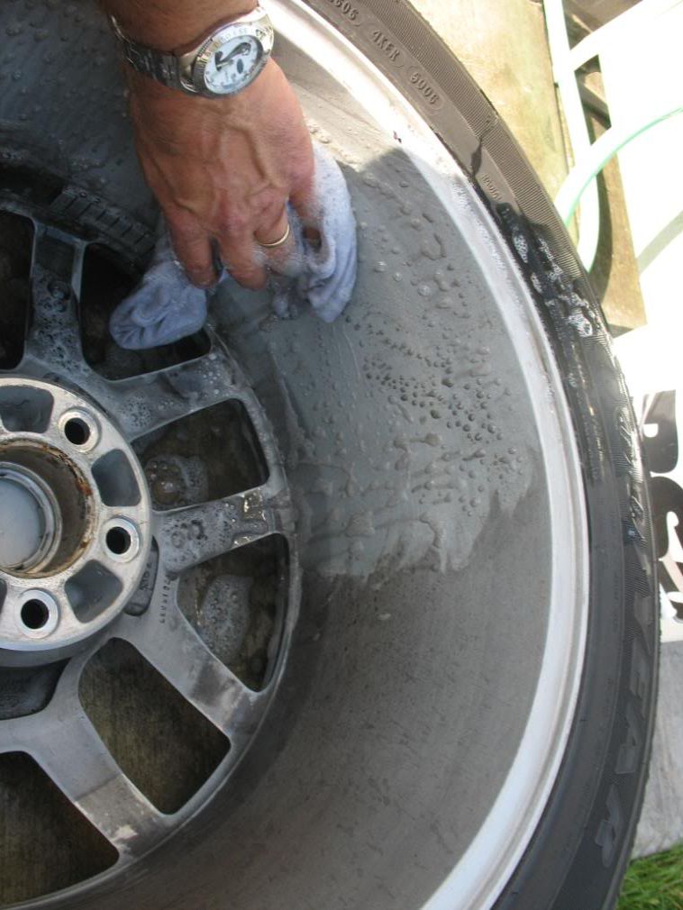

FiaCobra Posted May 29, 2008 Report Share Posted May 29, 2008 Grabber, the title screwed me up....lol Anyway, back on topic. What did you use to clean the back sides of the rims with and the wheel well housing? Link to comment Share on other sites More sharing options...
Grabber Posted May 29, 2008 Author Report Share Posted May 29, 2008 Grabber, the title screwed me up....lol Anyway, back on topic. What did you use to clean the back sides of the rims with and the wheel well housing? I used Ice car wash soap in a bucket with a rag and a brush on the rims. Then a dry old towell. On the wheel wells I used some spray simple green and a damp rag. The wells were not that dirty. This is the cleanest my car has ever been. I had yesterday off and my kid was at school and my wife was at Taekwondo practice. The weather was crappy, so I figured I would do some detailing on my car. I actually enjoy detailing my car. I turn on some tunes and relax while I work on it. Link to comment Share on other sites More sharing options...
