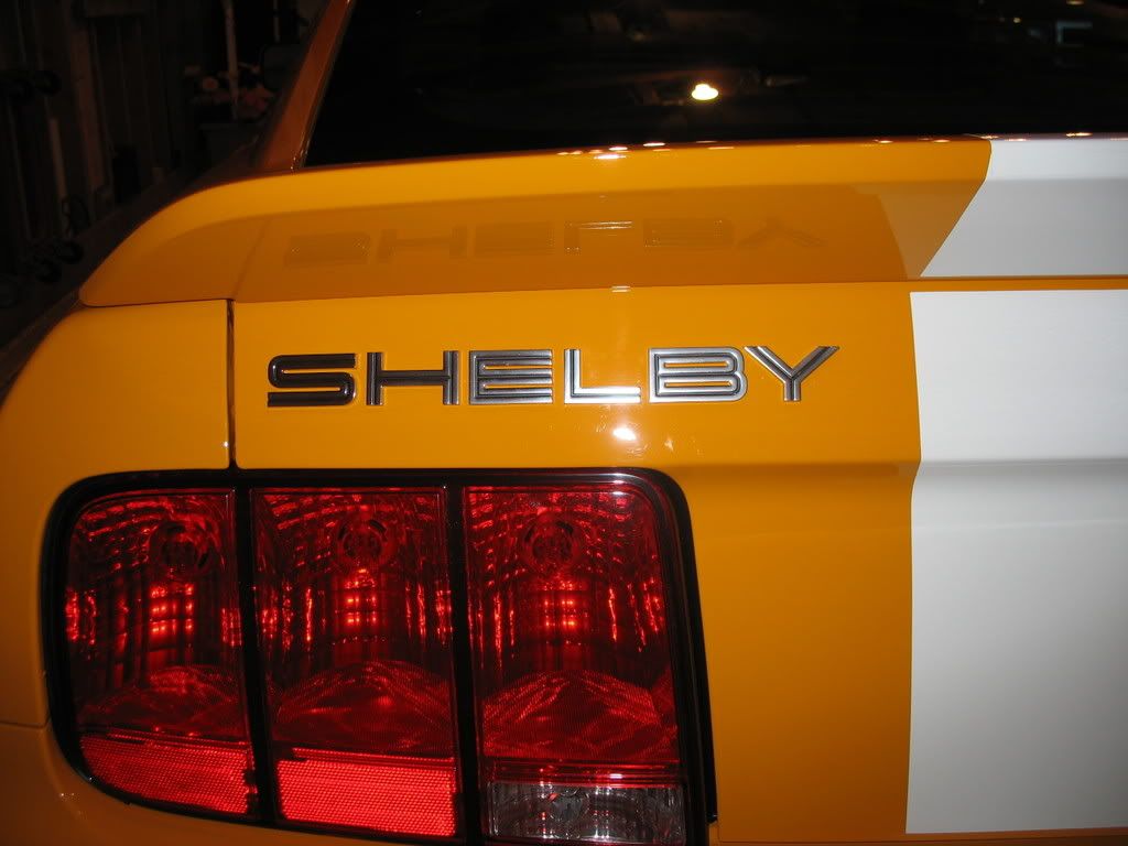

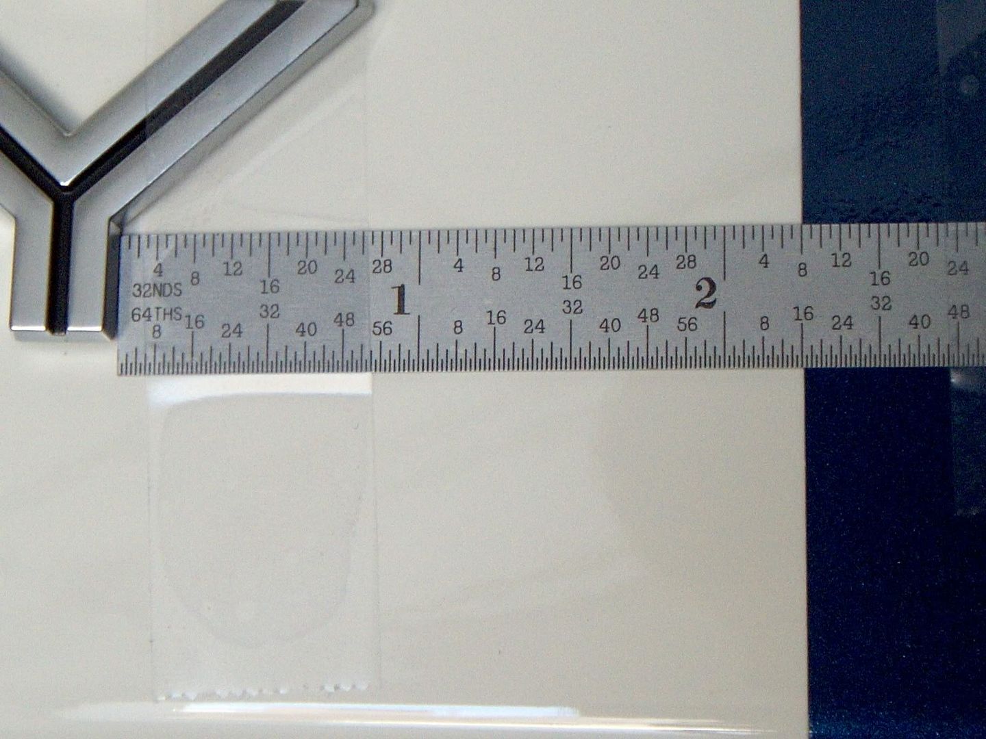

Grabber Posted March 28, 2008 Report Share Posted March 28, 2008 Can someone provide me wtih the exact dimension for the location of the SHELBY letters on the rear deck lid. I am going to put mine back in there stock location and I would like to put them in the exact spot. I have the new set of letters and they are all attached together, so I just need to know how they center up on the drivers side deck lid. A close up photo of that location would help me put them back in the exact factory / stock location. Link to comment Share on other sites More sharing options...

svtkeith Posted March 28, 2008 Report Share Posted March 28, 2008 Here you go Grabb. Link to comment Share on other sites More sharing options...
Grabber Posted March 28, 2008 Author Report Share Posted March 28, 2008 Here you go Grabb. Thanks Keith. Is the S about 3/4 of an inch over from the edge ? Link to comment Share on other sites More sharing options...
Grabber Posted March 28, 2008 Author Report Share Posted March 28, 2008 Thanks Keith. Is the S about 3/4 of an inch over from the edge ? Can anyone grab this dimension for me ? Link to comment Share on other sites More sharing options...
GT500FLYBOY Posted March 28, 2008 Report Share Posted March 28, 2008 Can anyone grab this dimension for me ? Try to extrapolate based on the size of the letter. It looks to be about 1/2 the width of the "S". Link to comment Share on other sites More sharing options...

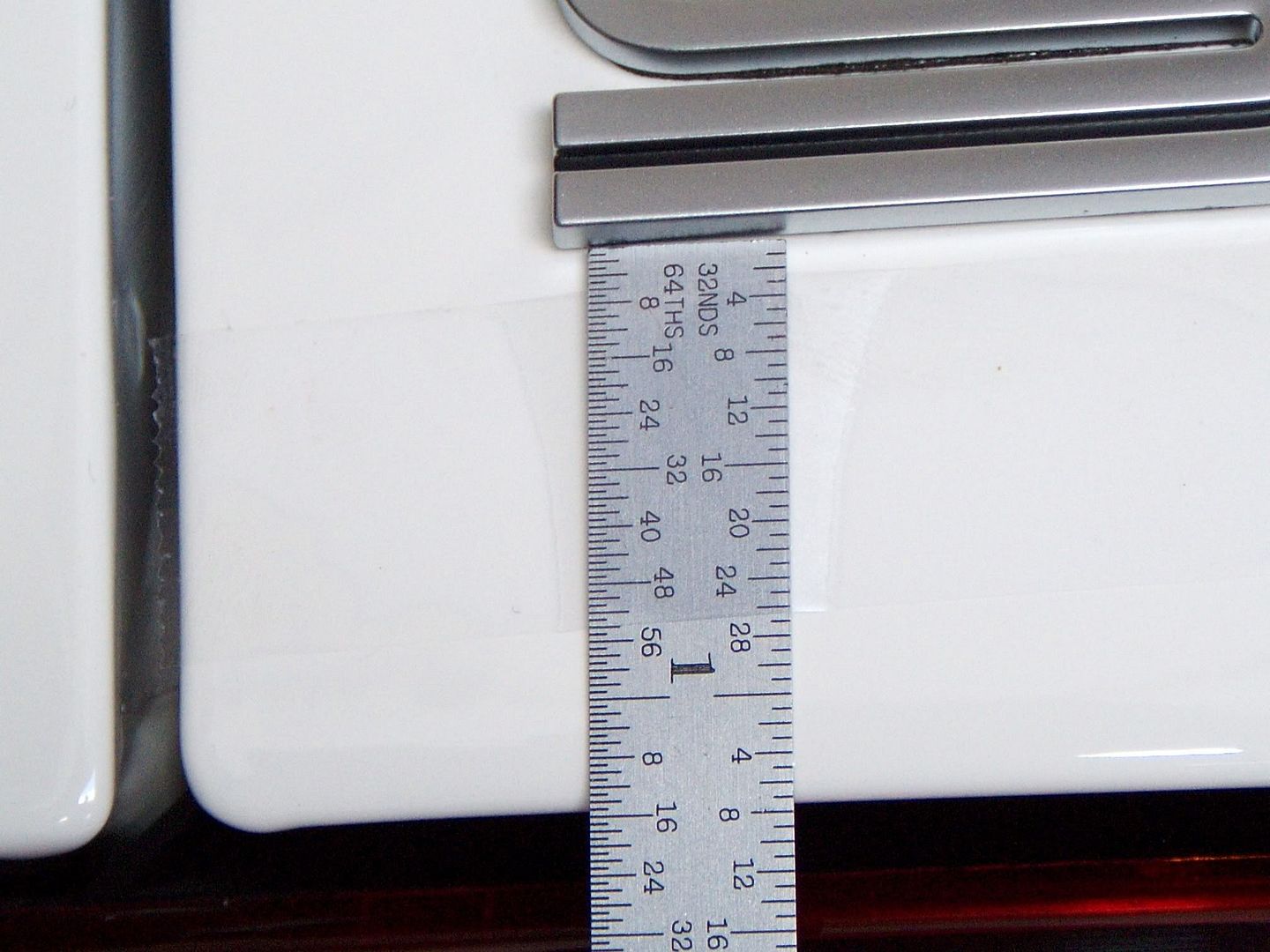

shelbymustangdan Posted March 28, 2008 Report Share Posted March 28, 2008 Hope this helps.... I will post three seperate pics due to file size. #1 Link to comment Share on other sites More sharing options...
shelbymustangdan Posted March 28, 2008 Report Share Posted March 28, 2008 #2 Link to comment Share on other sites More sharing options...
shelbymustangdan Posted March 28, 2008 Report Share Posted March 28, 2008 #3 Link to comment Share on other sites More sharing options...

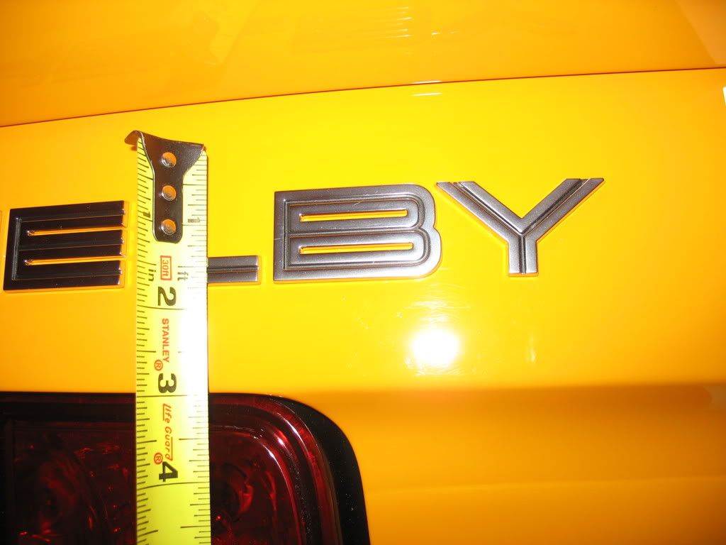

ColdwaterHotrod Posted March 28, 2008 Report Share Posted March 28, 2008 stand by for photos :happy feet: Link to comment Share on other sites More sharing options...
sharabi Posted March 28, 2008 Report Share Posted March 28, 2008 stand by for photos :happy feet: Seems like snow is melting fast here ... :elefant: Link to comment Share on other sites More sharing options...

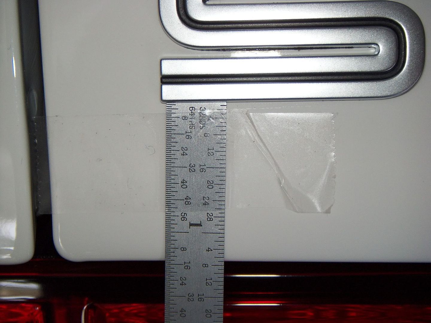

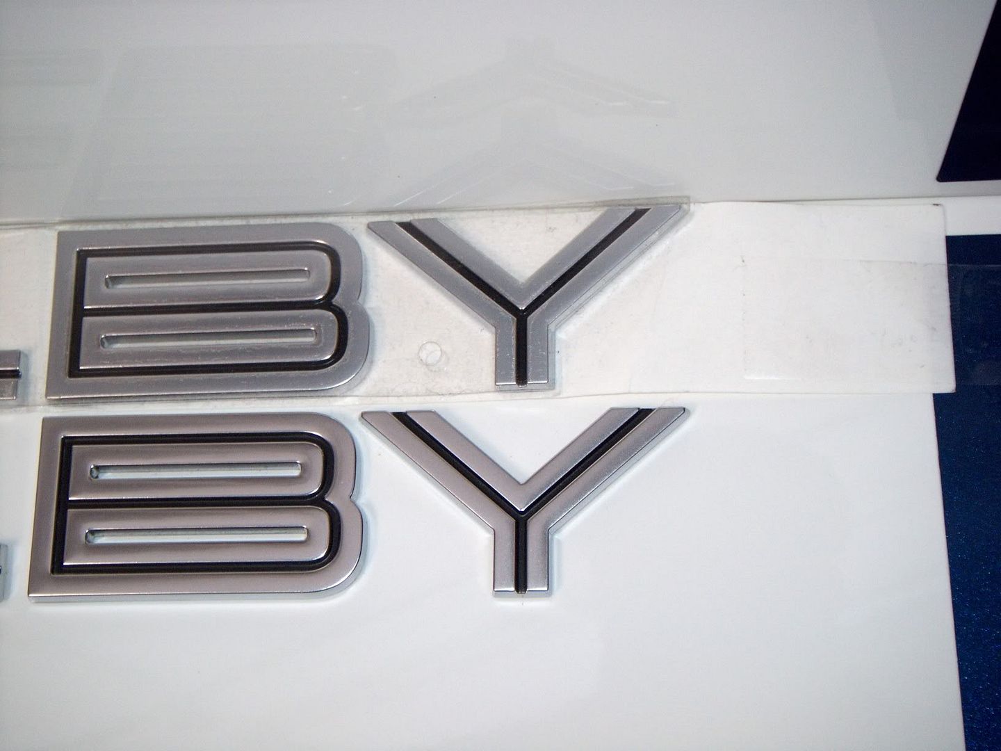

ColdwaterHotrod Posted March 28, 2008 Report Share Posted March 28, 2008 Ok Grabber, I'm making another guest appearence here at TS just for you & to help you out since your a good old boy. These photos are from the fastest color car & may be shewed since it goes so fast & things have a hard time staying attached The 1st photo I placed an extra set of factory lettering just above the factory applied lettering & IMO this is a good spacing trick for placement of the new ones. Link to comment Share on other sites More sharing options...
Grabber Posted March 28, 2008 Author Report Share Posted March 28, 2008 Dan & Rodney (and Keith too): I really appreciate the time you guys took to take these measurements and take the photos. I have taken down all the information and now I can return my S H E L B Y letters to the exact stock location. I just got home from work and plan on doing this little project tonight. I will post up a photo when I complete the letter removal and installation. This site Rocks. :happy feet: Link to comment Share on other sites More sharing options...

ColdwaterHotrod Posted March 29, 2008 Report Share Posted March 29, 2008 Link to comment Share on other sites More sharing options...

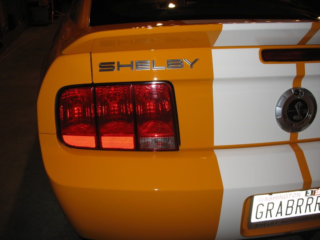

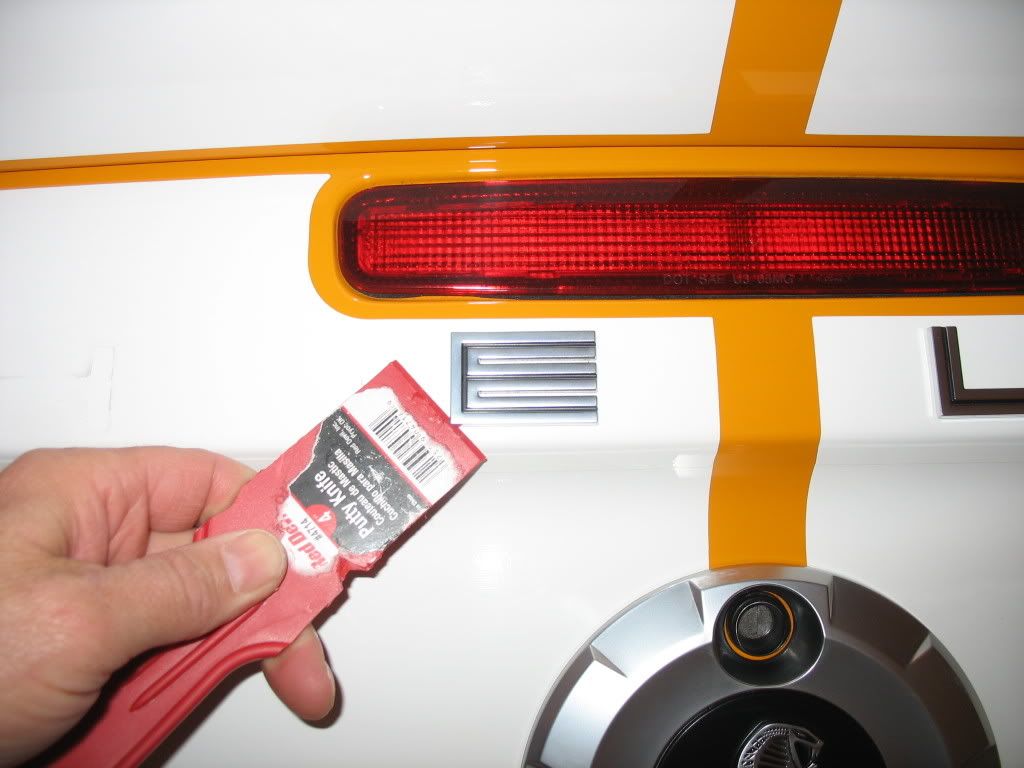

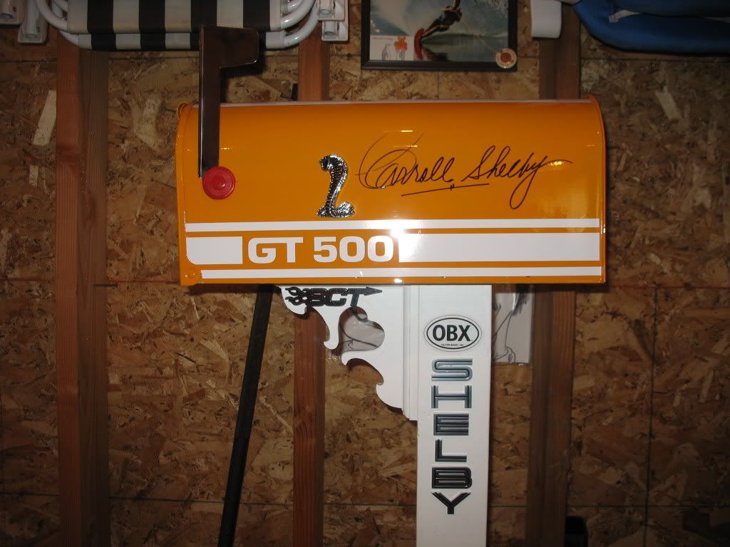

Grabber Posted March 29, 2008 Author Report Share Posted March 29, 2008 I used a blow dryer and heated up the letters an popped them off with a plastic putty knife. The adhesive stayed intact except on the "S". I fixed that, and then put the old letters to use on my mailbox stand. Then I cleaned off the spots and put the new letters on using the dimensions given to me. Here it is: Link to comment Share on other sites More sharing options...
ColdwaterHotrod Posted March 29, 2008 Report Share Posted March 29, 2008 I want to see a shot or two with the ruler just to make sure your work passes the inspection. Link to comment Share on other sites More sharing options...

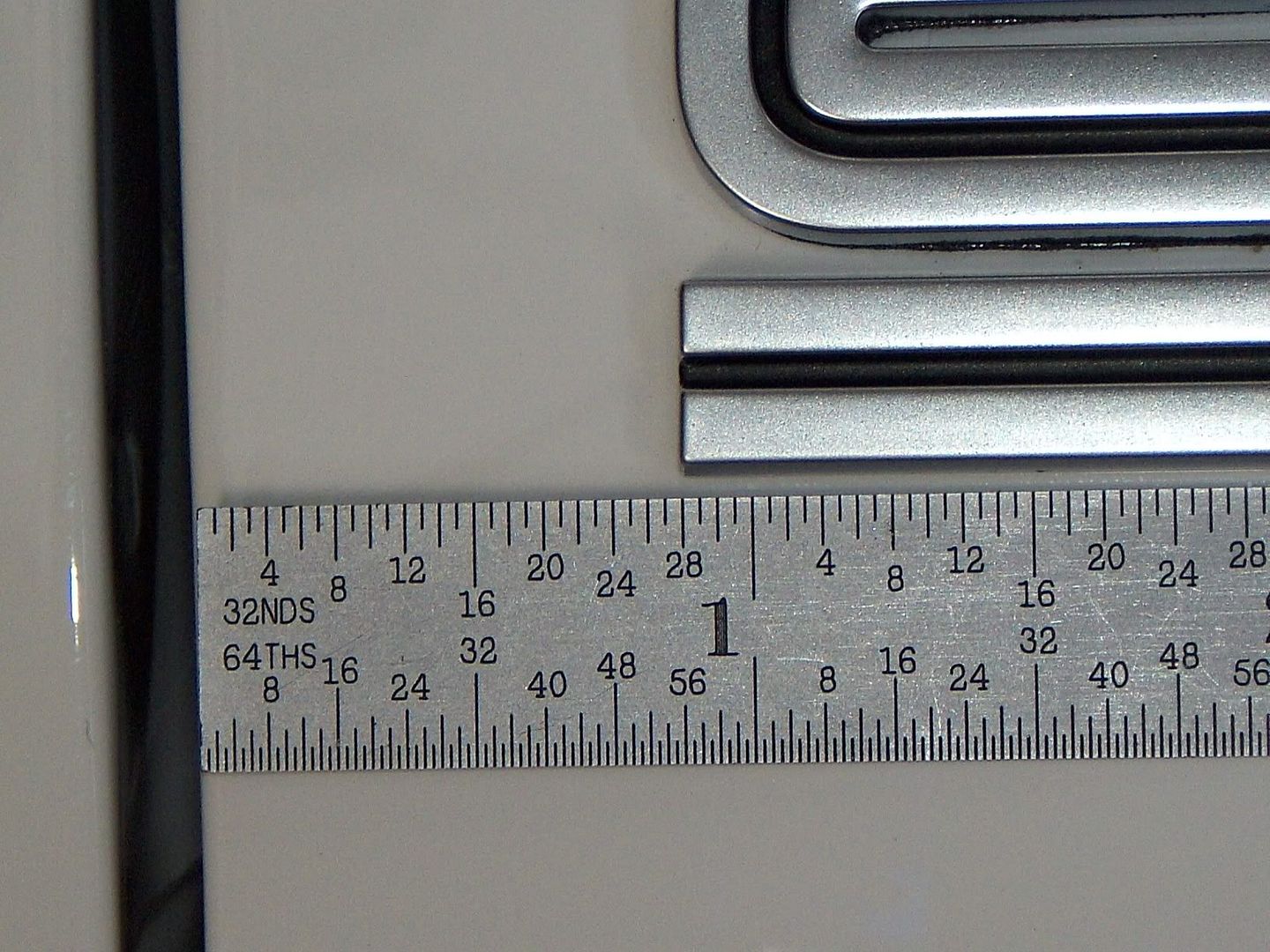

Grabber Posted March 29, 2008 Author Report Share Posted March 29, 2008 Rodney, I had to make an adjustment. Link to comment Share on other sites More sharing options...
