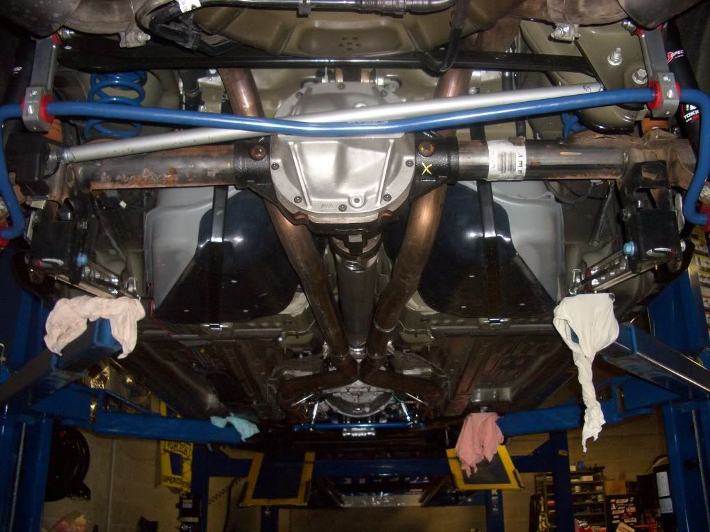

69dejavue Posted February 20, 2008 Report Share Posted February 20, 2008 Louis, is that a FRPP aluminum differential cover? Any clearance problems? Any problems with installation? I have been considering that myself. Link to comment Share on other sites More sharing options...
LuLu Posted February 20, 2008 Report Share Posted February 20, 2008 Louis, is that a FRPP aluminum differential cover? Any clearance problems? Any problems with installation? I have been considering that myself. FRP offers two axle girdles...M-4033-G1 for all 8.8 applications, and M-4033-G2 for the 2005 and up Mustang GT suspension. Link to comment Share on other sites More sharing options...
louie428 Posted February 20, 2008 Report Share Posted February 20, 2008 Louis, is that a FRPP aluminum differential cover? Any clearance problems? Any problems with installation? I have been considering that myself. It's a TA low profile girdle cover, with about 1 1/2" clearance from pan hard bar. Link to comment Share on other sites More sharing options...
