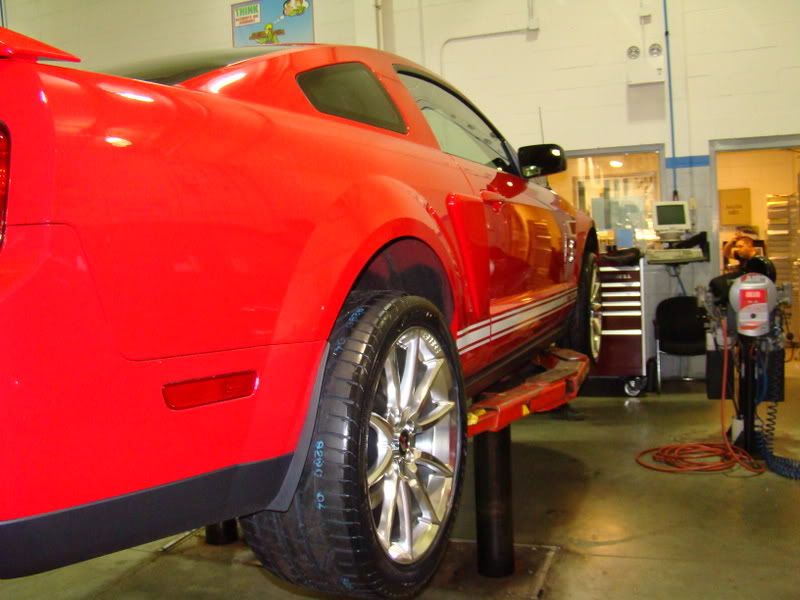

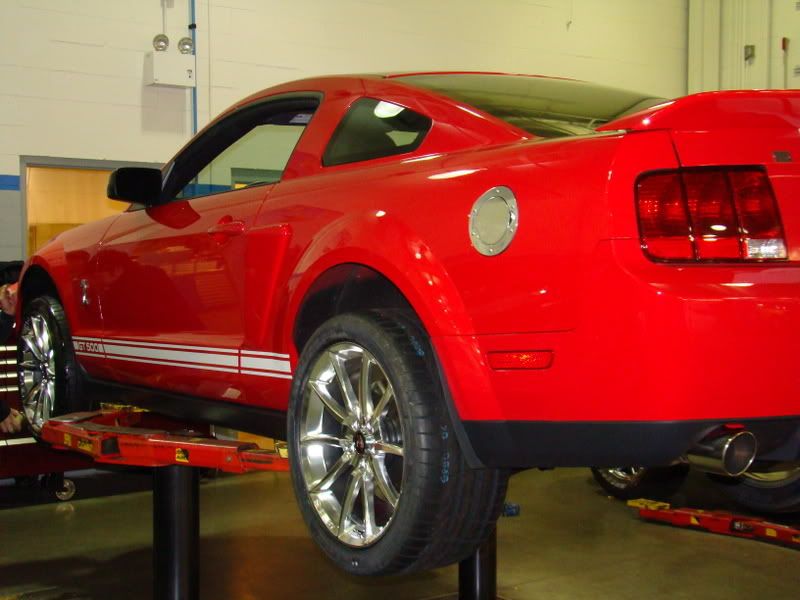

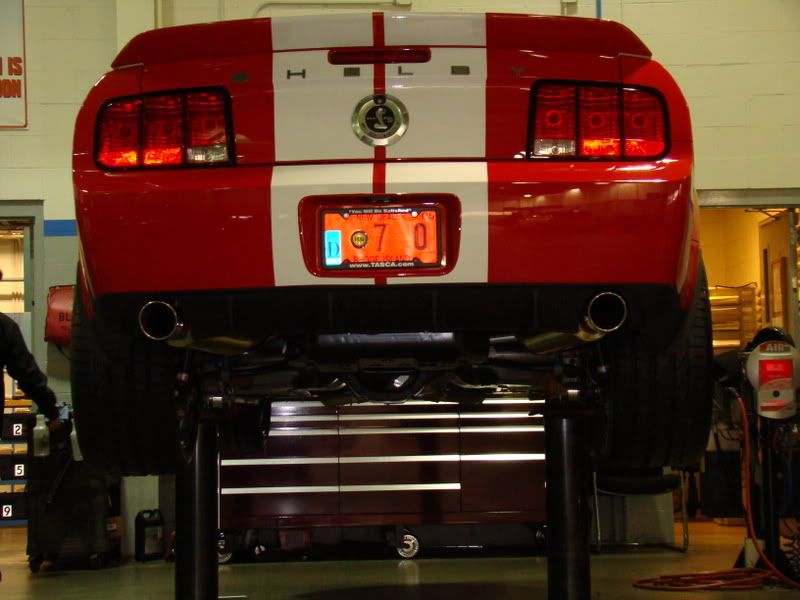

n20civicb18 Posted December 17, 2007 Report Share Posted December 17, 2007 305/35-20 Link to comment Share on other sites More sharing options...
Joker45 Posted December 17, 2007 Report Share Posted December 17, 2007 Is this on a SS that you guys are doing a conversion on? Is this going to be the tires size that is put on the SS? Link to comment Share on other sites More sharing options...
n20civicb18 Posted December 17, 2007 Report Share Posted December 17, 2007 No, No ha That is actually David Tasca's car. Link to comment Share on other sites More sharing options...
Joker45 Posted December 17, 2007 Report Share Posted December 17, 2007 No, No ha That is actually David Tasca's car. That's just mean! Teasing us like that :P Link to comment Share on other sites More sharing options...

dmustang Posted December 20, 2007 Report Share Posted December 20, 2007 What size tires did you go with on the front for Mr. Tasca's car? :beerchug: Link to comment Share on other sites More sharing options...
n20civicb18 Posted December 20, 2007 Report Share Posted December 20, 2007 Too small, I dont even want to say lol Link to comment Share on other sites More sharing options...
dmustang Posted December 20, 2007 Report Share Posted December 20, 2007 Give me something to go on. Have you lowered the car? Link to comment Share on other sites More sharing options...
dmustang Posted December 20, 2007 Report Share Posted December 20, 2007 :unsure: P-Zeros? Link to comment Share on other sites More sharing options...
