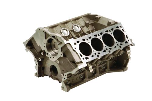

moabman Posted September 27, 2007 Report Share Posted September 27, 2007 Josh - Good questions. I have often wondered the same thing about the 5.4 in the GT500 because it is worse than you stated - Ford already had a 5.4 aluminum block blown engine - It's the Ford GT (Not Mustang GT, just GT) engine. In fact, the heads are the same on the Ford GT and the GT500. Cost is the only reason I can think of that made them convert over to the iron block version of the 5.4. Link to comment Share on other sites More sharing options...
nachtkriechen Posted September 27, 2007 Author Report Share Posted September 27, 2007 Josh - Good questions. I have often wondered the same thing about the 5.4 in the GT500 because it is worse than you stated - Ford already had a 5.4 aluminum block blown engine - It's the Ford GT (Not Mustang GT, just GT) engine. In fact, the heads are the same on the Ford GT and the GT500. Cost is the only reason I can think of that made them convert over to the iron block version of the 5.4. Thanks, Moabman. Concerning the Ford GT's aluminum 5.4... you don't think it was something as stupid as the "exclisivity" issue, do you? I mean, I can sort of underderstand that aspect, if I was a Ford GT owner, but, on the other hand, GT500/Supersnake owners seem to be the same way. No offense to GT500/Supersnake owners out there, ideally or ultimately, I would love to have a Supersnake. However, in my career and particular life situation, I can only hope to turn a Supercharged Mustang GT into a "cloner" Supersnake. Ford GT owners probably don't want GT500 owners to have their aluminum 5.4, and the GT500 owners would probably kill to have that engine (if it was an option), just as GT500/KR/Supersnake owners don't want Mustang GT owners getting their hands on the parts that make the GT500/KR/Supersnake unique. It's hypocritical, but, I guess thats how it goes. - Josh Link to comment Share on other sites More sharing options...
moabman Posted September 27, 2007 Report Share Posted September 27, 2007 I really do think it was just cost. I think you can buy a Ford GT crate engine but I can't remember the cost. I think the aluminum block 400 hp NA 32V Cammer engine is around $20,000 in crate form so that should give you an idea. Of course it would be less in a production car but it still might put the price point above where Ford wanted it. Edit: The Cammer goes for $29,000! Yowsah You can buy the GT block but not as a fully dressed crate engine: There is a note that the block will have to be modified for the starter in non-Ford GT applications. It costs $3,699 and tips the scale at a sweet 110 lbs Link to comment Share on other sites More sharing options...

Five Oh B Posted September 27, 2007 Report Share Posted September 27, 2007 Ford used all aluminum heads & blocks in the 2003-4 Mach 1's, while the 2003-4 SuperCharged Cobras got aluminum heads, but iron blocks. The reason was to handle the long-term durability tests that an OEM like Ford must consider. Sure, you can supercharge a 4.6L or 5.4L aluminum block and get away with it for awhile, but it will fail much earlier than an iron block. "Much earlier" is a loose term here, as it could last 20K miles, 50K miles, 100K miles, etc., who knows, but Ford does have very strict guidelines for durability testing. Ford is very aware that Mustang owners modify the heck out of their cars, and they know that any factory motor they offer in a Mustang is going to get modded. By going with the iron block and forged internals in the Terminators and the GT500's, they are looking at our best interests long-term. Even if you mod a factory supercharged V8, blow it up, and Ford can get out of covering it under warranty, I suspect that they do not want the bad press that long-term durability is questionable (even though us enthusiasts understand the strains that modifying puts on an OEM setup). The 5.4L aluminum block in the Ford GT is reinforced above and beyond the 4.6L aluminum blocks that Ford has used in the 2003-4 Mach 1's and the 2005-8 Mustang GT's. That reinforced specialty 5.4L aluminum block is quite spendy and that cost is the biggest factor in not using it in a "value" priced car like Mustang (even in GT500 guise). In the Ford GT, it is easier to pass that expense on to the customer. Also, a much smaller percentage of Ford GT's will be modified versus Mustangs, so there is going to be a very small handful of maxxed out GT's compared to the large number of maxxed out Mustang GT's and GT500's. Oh, and Josh, 35 years ago GM released a super lightweight engine. The plastic motor for the subcompact Chevy Vega. Super lightweight is only good if it is durable and cost effective. I think GM had the cost effective part nailed down on that one, just not the durable part. A titanium engine would likely be just the opposite. Durable perhaps, but certainly not cost effective. Link to comment Share on other sites More sharing options...

Super Snake Posted October 2, 2007 Report Share Posted October 2, 2007 Josh - Good questions. I have often wondered the same thing about the 5.4 in the GT500 because it is worse than you stated - Ford already had a 5.4 aluminum block blown engine - It's the Ford GT (Not Mustang GT, just GT) engine. In fact, the heads are the same on the Ford GT and the GT500. Cost is the only reason I can think of that made them convert over to the iron block version of the 5.4. The Ford GT Alum 5.4 has a dry sump. Cost and the challenge of getting it to fit in the Mustang... Link to comment Share on other sites More sharing options...
nachtkriechen Posted October 10, 2007 Author Report Share Posted October 10, 2007 The Ford GT Alum 5.4 has a dry sump. Cost and the challenge of getting it to fit in the Mustang... Maybe so, but, if you watched the "Bold Moves" downloads, on the GT500 line, the SVT team also had a pretty major challenge getting the iron block 5.4 in as well. Maybe the Aluminum block just wasn't feasible. I don't know the differences in the two engines when completely assembled, so, maybe the "dry sump" is the difference between the engine fitting or not. - Josh Link to comment Share on other sites More sharing options...
